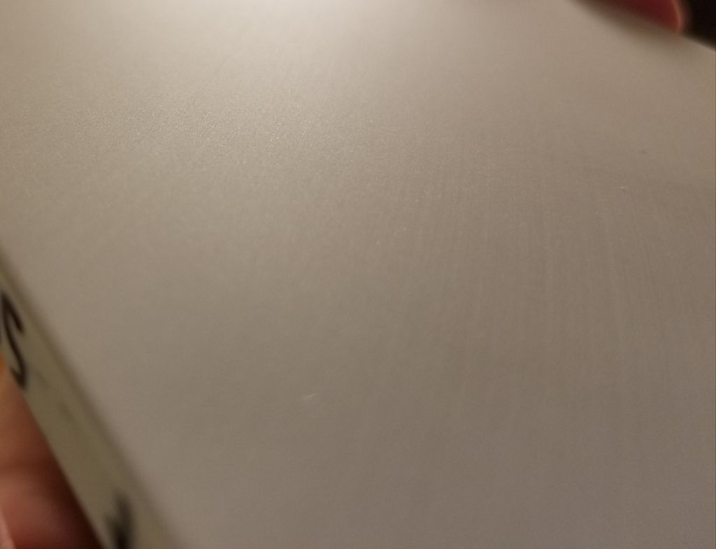

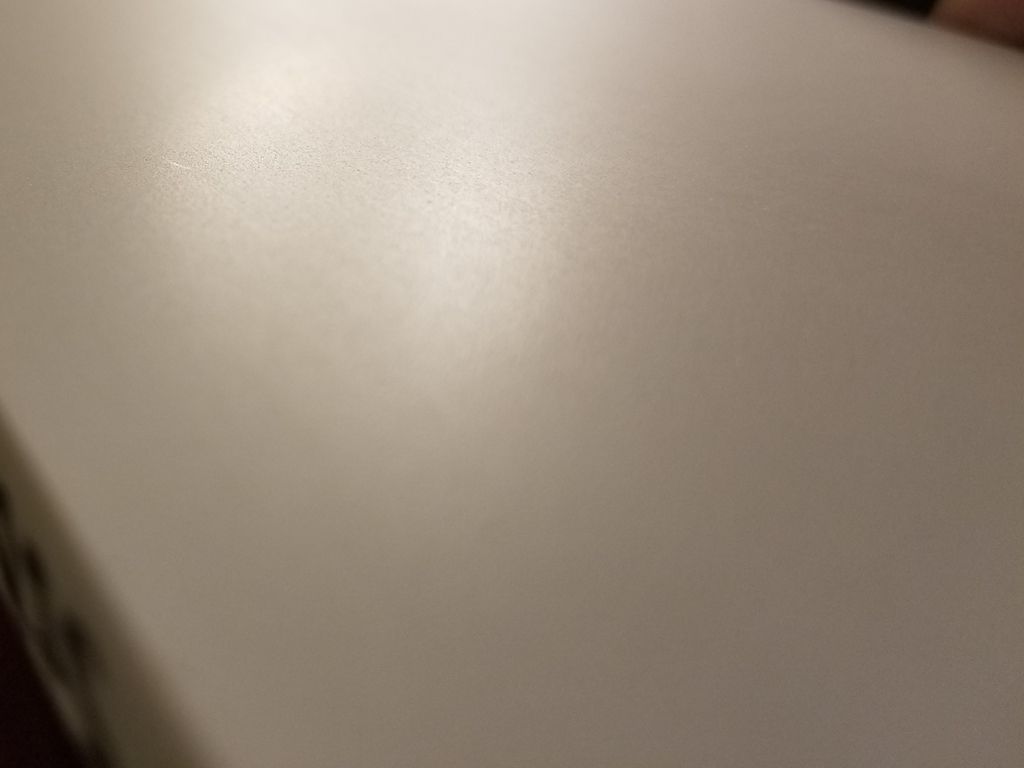

Speaking from the perspective of a machinist, it's not easy to grind something this thin with this much surface area perfectly flat. Even the act of clamping it in a vise or fixture can distort the thing a tiny bit, then you grind it flat but when it's released from the holding fixture or vise it springs back from that distorted state. My own Spyderco 3" x 8" UF was a little out of flat but for knives it was fine. Since I planned to use it for razors I flattened and resurfaced it on one side. One side I use for razors, one side for knives. Here is a decent image comparison of the difference between the two sides as far as texture:
Factory finished side:
Flattened and refinished side:
Note that the grooves visible in the factory side from the diamond grinding wheel can barely be felt with a finger.
