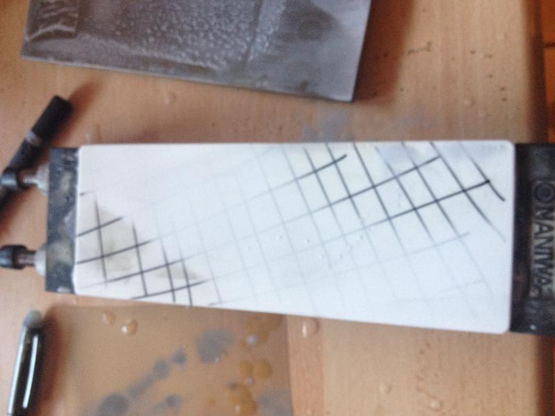

When I look at the link that ckdex gave and bastl's efforts at working this stone... He shows a photo of a grid he drew on the stone, then started grinding. Where the grid was first removed is a classic sign of a stone being out of level. DM
Not exactly. The stone was probably level, but there are machining marks in the surface, meaning that while it is flat, it is not completely smooth.
He describes that the stone was not level and it took him two hours with the DMT 120 until it was level.
Here you can see that in the beginning only some part of the stone was removed due to it no being level:
And even this was probably after having worked quite some time on it. I am doing the other side now and have lapped quite some time and it is still not level.

If it was that far off level it would have been better to get it replaced under warranty. Those are supposed to be dead flat from the manufacturer.
Seems like something Spyderco needs to address with their manufacturer. What are they paying for if they're not flat?
Something like this is what I'd consider an acceptable degree off of dead flat for a sintered ceramic. You might want to flatten it for razors, but for anything else, that's more than close enough.
Several of us are finding them way more off level than that. The factory has had one or two tries to get it level. How come we can do a better job w/ simple tools?

I think a major part of it is that the machine hours of grinding is pretty severe. It's expensive and time-consuming to grind sintered ceramics. Like...REALLY expensive. You end up burning through a lot of costly diamond abrasives doing that work and it's not at all rapid. The amount of time it takes to flatten a not-too-awfully-uneven sintered stone by hand isn't a huge investment for an individual, but imagine if you were making hundreds of them and what you'd have to charge for it and account for in your pricing structure. It would balloon the price massively. But that being said, it's really weird that folks are getting stones that aren't pretty dang close to flat since that's what they're being paid to to them.

Speaking from the perspective of a machinist, it's not easy to grind something this thin with this much surface area perfectly flat. Even the act of clamping it in a vise or fixture can distort the thing a tiny bit, then you grind it flat but when it's released from the holding fixture or vise it springs back from that distorted state. My own Spyderco 3" x 8" UF was a little out of flat but for knives it was fine. Since I planned to use it for razors I flattened and resurfaced it on one side. One side I use for razors, one side for knives. Here is a decent image comparison of the difference between the two sides as far as texture:
Factory finished side:
Flattened and refinished side:
Note that the grooves visible in the factory side from the diamond grinding wheel can barely be felt with a finger.
