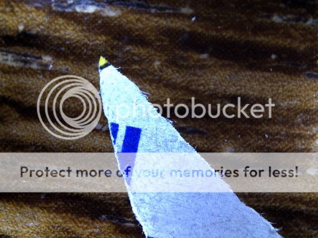

I finally got enough cardboard to do a decent random sample with Kurodrago's Bushlore :
http://www.siteground136.com/~knifetes/forum/showthread.php?t=2162

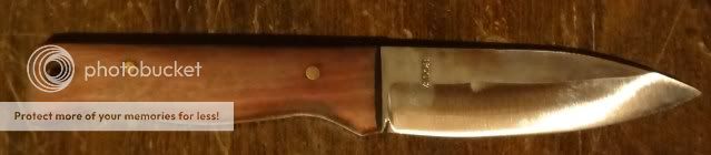

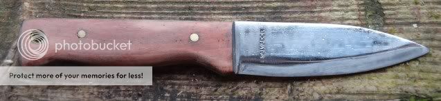

Before I did any work I reground this blade so it went from this :
to this :
cutting the edge angle in half and completely removing the initial grind. This would allow me to sharpen much faster as I could now apply a 10 degree micro-bevel very quickly.

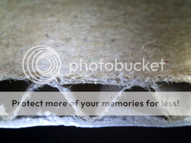

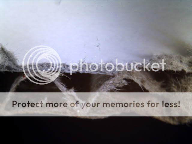

The top slice was made by the Condor and the bottom by the Mora, the Condor is much rougher on the cut. Now that may not look so bad but compare these two initial cuts (at 5X linear magnification) :
This is with the Mora, very little tearing with the cardboard. Now with the Condor :
The knife is tearing the cardboard.

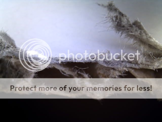

Again, two pictures of the cut cardboard at 5X magnification.
First the Mora :
and the Condor :
No comparison. If you compare to the first two pictures, the Mora is cutting cleaner after 50 slices through 30 cm of cardboard than the Condor was on its first cuts.
