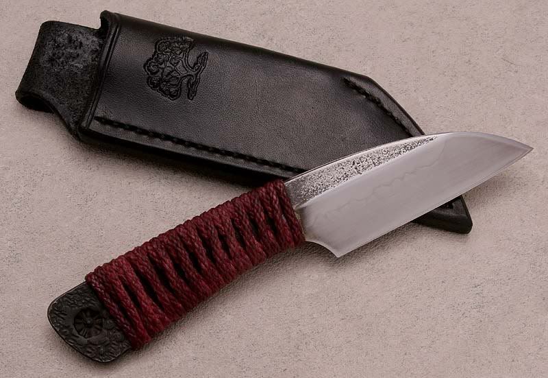

Welcome back Jimmy and as you can see, I think posting under your namesake
makes things all the easier and that little knife has gathered quite a few
comments from time to time, glad to finally make a sheath so I could tote
it off to Ashokan this year, you should come up next year and do a couple
of lectures on edges, profiles and cutting tests, that would be most excellent!
For those that haven't seen the knife in question;
While Jimmy sent it off with a very good working finish, I saw some hamon
lurking about and after seeing Don Fogg's demo on hand sanding and etching
I had to make the attempt, it's showing, but I'm sure it could be better
but that will be it from me! :)
and one showing the entire knife;
G2
Thanks Roger, I was going to carry it up with me to Brampton but didn't
want to stress the border patrol too much!
G2
Thanks Joss, I think that may be the smallest that Jimmy can hammer out ;)
Solid knife, great cutter and hair popper as well, I was going to take the
cord off to provide room to do the hand sanding, but didn't want to muck
it up any more than I may have already, as it stands, I like the looks of the
hamon and that's what counts, the back side also shows it nicely too.
BUT, this is skewing the thread a tad bit here! Sorry about that!
