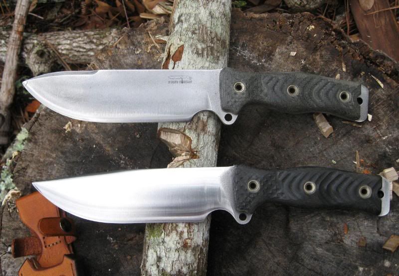

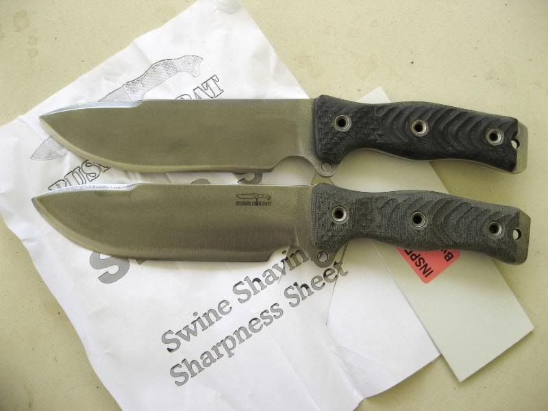

They are all 3/16" thick with 7" blades. I got the CG and the CE. Here you see my stripped and convexed CG along side the CE model.

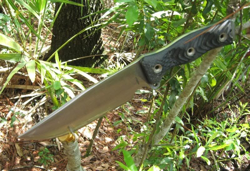

The broad bladed Sarsquatch is a fine knife for camp or trail. It is ligher than some blades due to its thinner stock. Some heavier knives can out chop it, but the Squatch chops just fine. It also excels at slashing limber grasses and brush like a mini-machete. I modified one of mine into a SAR Bowie, just to have a bit more point, but it still chops well enough for such a light, easy carrying knife.
Man Horn Dog, your pretty talented with the knife grinding and restyling blades.:thumbup:
That looks like a new sarsquatch bowie design. Sweeeeet!
Thanks. I think I did the first one, but Ban did the prettiest one I've seen. As you can see, I left the scales on and did not bother to sand the flats on the ricasso or pommel. It is one of my favorite Busses.
Back on topic, another Busse that comes with the convex grind is the super heavy duty NMSFNO. It is the most potent 8" chopper I have ever used. I stripped mine and blended the factory convex primary grind to a full convex zero edge. It's a lot heavier than the Sarsquatch, but this is my ultimate camp knife.
