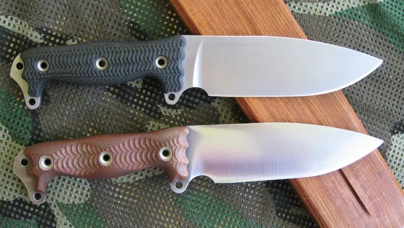

DO you like the NMSFNO better than the NMSH. If so is it because the blade is'nt convexed?
I don't have any of the longer Fusion Steel Hearts, but they are impressive. I have the 2007 ASH1 SE and the Skinny ASH1. While they can chop, they are just too short (6") to compete with my longer blade Busses in chopping. I convexed my Skinny one, and it's a great slicer and dicer.
Just curious I've got a steel heart se comming next week. Did'nt know if it is convexed or not.
It's a 2008 model, the guy said it was 270. thick. I'd like to have it convexed. It's satin finished.
At .270" thick, be thankful it isn't a convex grind. It would be even heavier. Just sharpen the final edge yourself using a strop and compound, and you will have a nice convex edge. I bet it's a good chopper.
The 2008 is a much better knife in my opinion. I find the 2007 very beautiful but too heavy.

Thanks Horn Dog, and Black Diamond for all your help, pictures and Imformation. Just having a hard time waiting for it to get here. Thinking about a NMSFNO now, or a Fbm not sure which one to get next. Now I know the NMSFNO comes convexed so maybe that'll be next.
It depends on what you look for, I wouldn't consider only the knd of grind but also the thickness of the blade.
I think the NMSFNO is a better slicer the FBM is the best chopper.
As much as I like my NMSFNO, I think that your new FSH SE would be a very nice chopper, too. No need to get another 8" chopper. Personally, I'd prefer the new BWM to the FBM, even if the FBM is prettier. And you can get a brand new BWM now for a good price. Convex grinds are fine, but a convexed final edge on a flat grind works just as well, so don't sell that FSH short.
Agreed. I prefer the FSH to the NMSFNO. The first gen FSH had a horrible thick edge, but Ban took care of that. The Heavy Heart and the newer 0.27" flat grind versions are very nice knives.
