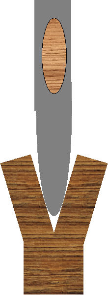

I found this page and think it's interesting. It's about axe but I think it applies to knives too.
http://equipment.ludlowsurvivors.com/axesharp.html
And this is what I find very interesting !
"As you can see from the illustration above, due to the curve on a convex grind, the bit (cutting edge) of the axe head is not in contact with the wood after it has penetrated and in fact it is the ramp (side of the head) that is forcing the wood apart. This protects the cutting edge from damage and wear. It also explains why ensuring the ramps of your axe are smooth and polished will aid cutting efficiency"
Very good Illustration Black Diamond, That would probably explain why the convex is so easy to bring back to razor sharpness. or is still shaving sharp after use. Thanks,
