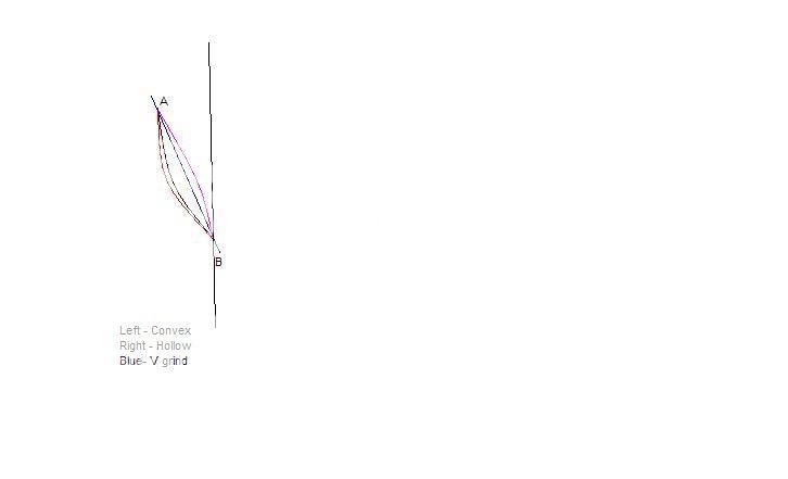

Right, we're in the land of knives. Chiral said, and I'll take it at face value as he has no reason to lie about something that can be easily verified, that all edges end in a parabola. If true, not only can you not say WHERE the edge angle is you can't say WHAT an edge angle is without introducing a randomly selected variable which would be his point W. Theoretically speaking, I think we're on the same page.
That's to much :)
Imagine that we have ( in section ) two points on the blade, B on the edge and A. It's obvious that the convex grind has more "meat" ...We can change the angle, but for the same 2 points, the convex it's thicker :)
( SORRY, THIS IS WRONG :) - and yes, all drawing curves, in the pic, in the point B, make the same angle with "the vertical" line

The math that your using doesn't define anything in an absolute sense. It's improper math but even if I excepted your math, by your own admission it's merely an approximation for a user at a randomly selected point. If you take measurements on a knife and tell me it's 30 degrees, that's flat wrong in an absolute sense. The most you can say in an absolute sense, by your math, is that the edge angle is somewhere between the arctan of the height of the blade and the spine thickness right up to infinitesimally close to 180 degrees which would be at the point directly behind the apex. There is NO absolute statement you can make about an angle if you can't actually define that angle.
Throw a ball. Your hand travels in an arc but the ball goes straight. The ball goes straight on the tangent to the arc of the hand rotating around the shoulder which is at the SINGLE point on that arc where your hand released the ball. The way your math would describe the direction of the ball is by using two points within that arc to calculate it. Which is flat wrong.
1) What is the "absolute" mathematical definition of "convex"? That'll give you a starting point for theoretical principles referring back to physical reality with regard to the impossibility of "convex" being "thinner" than flat.
2) How is the math improper??? Because it gives an approximation?? That doesn't make it "improper" at all (e.g. the absolute value of Pi). The "randomly selected point" is less random that one you'd choose for establishing a "tangent" anywhere except the precise apex which I've already discussed as useless being in no way informative. Placing a tangent at any other point along the curve is not only more random, it asserts knowledge of the radius of the curve which is not to be had without more precise measurements which would, again, be mere approximations, thereby compounding the approximations being made and the error. THAT would be "improper math".
"Tangent" is necessarily at 90 degrees to the radius of the curve - again, a definition.
In the above images, the trajectory of the non-tangent is ALSO accurate and can be obtained without knowing the radius - not "wrong" at all, indeed possibly the only way to describe the direction of the ball accurately in real life. Remember, two points define a line, even defining "tangent" requires at least two point - one of intersection and another that is not intersected.
