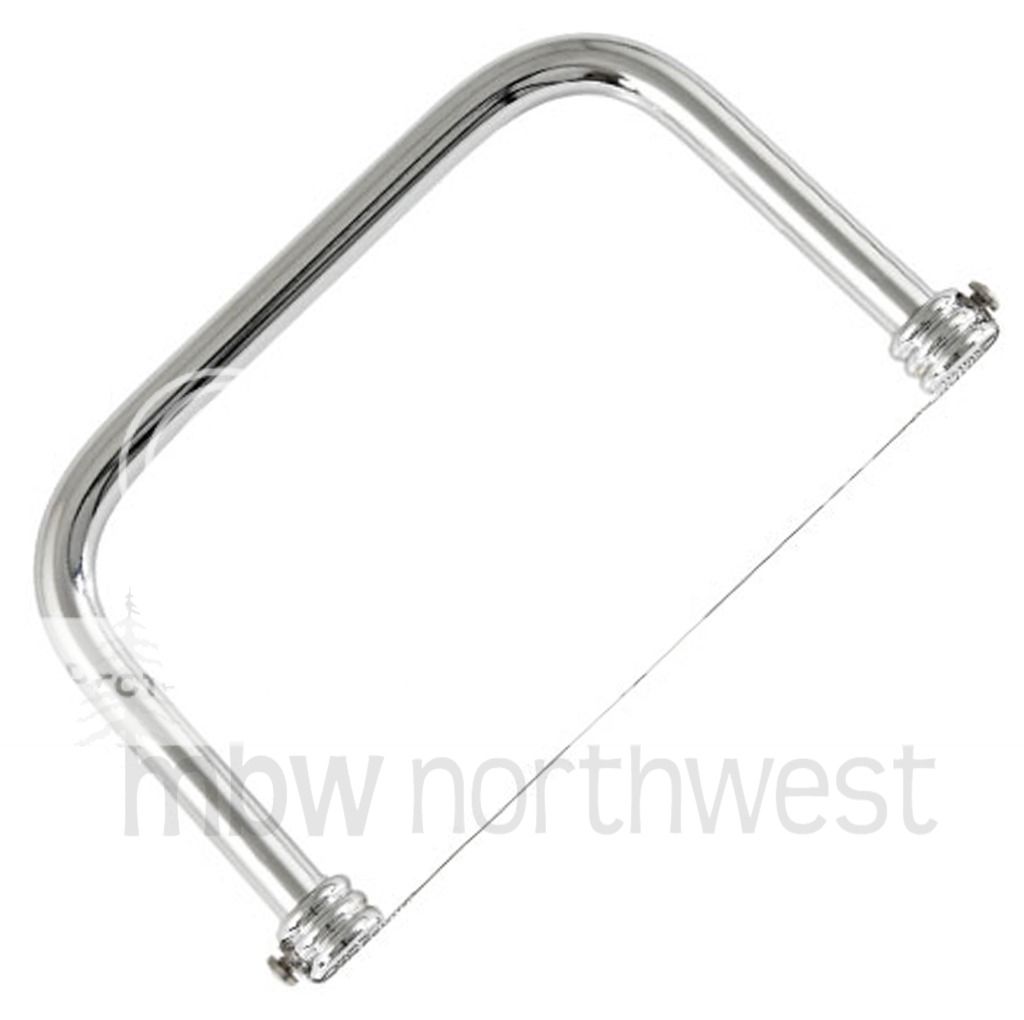

Ultimate convex-edge cutting tool - a cylinder!
Well, technically that's how cheese and clay wires work! And they engage at any angle of presentation! :D
:D
That's what I'm getting at. The cheese-cutter is ultimate simplicity, it has no specific "edge" - it's smooth "bevel" and blunt on all sides - and yet it cuts as intended... because thickness cuts. It is ALL edge!
If it were thin enough wire, it could be used to shave.
But it won't carve hard media or chop very well. Why not? Because it lacks strength to support the thin "edge". To support the edge of a knife or axe, it has a blade behind it. The blade necessarily limits the "angle of presentation" because it thickens (widens) sections that might otherwise be "edge" for cutting. The angle of a blade bevel only exists by accident in order that a thin edge may be supported by material behind it. It is a necessary evil ;)
Look at a modern straight-razor with its deep hollow grind that produces a blade with a thick spine but very thin edge. The blade behind that edge exists to support the edge, to allow a user ease of control over the edge, and to provide material upon which a new edge may be ground as the old one is worn away.
Look at the thick convex of an axe blade - lots of material support for an edge subject to harsh forces, back to a heavy poll that lends mass for the force of the swing.
The best cutting implement of all has no edge, does it even technically have a blade? *shrug* :cool:

Another problem with wires being that you can't really choke up on them and they have to be held taught by a framework, meaning you can't feasibly have a curved profile. So even if they would make them thin and durable enough they'd still have their issues.
I wouldn't say the rest of the blade only exists by accident...it's very deliberate! Rather I would say that it exists as a consequence of other design requirements. Cutting ability alone is not the determinant of an effective design. It's just one of a multitude of factors in need of optimization for a given context of use.
