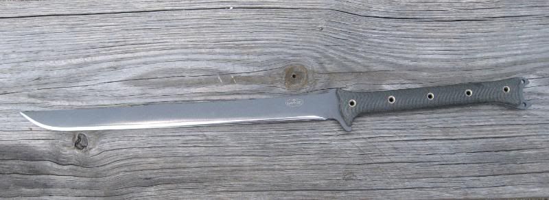

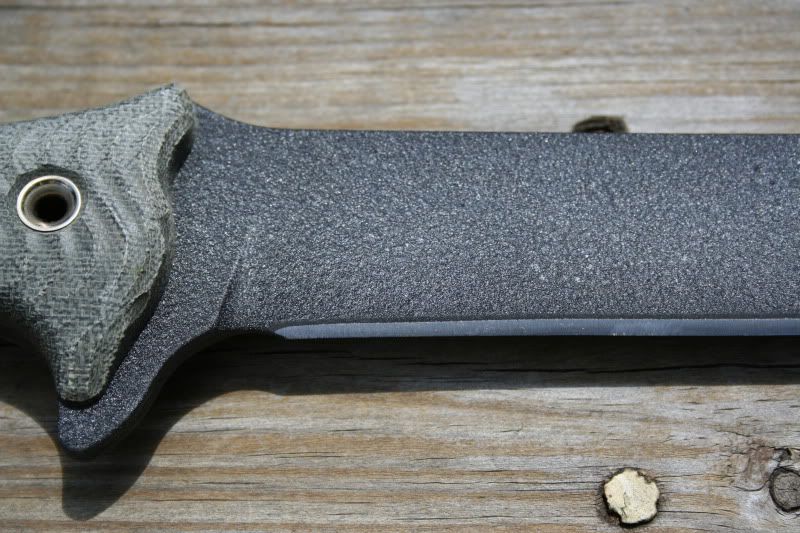

The Waki is a nice addition to my Bussekin sword set. Never could bring myself to use the AK47. The Ruck was stripped and I’ve reprofiled the edge to a polished convex. It was a big hit at our last Chop-In
Waki handle is as thick as the AK, but the grooves are a little deeper.

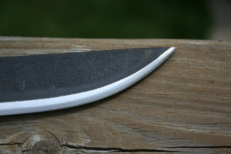

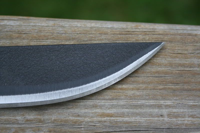

Tip profiles all similar.

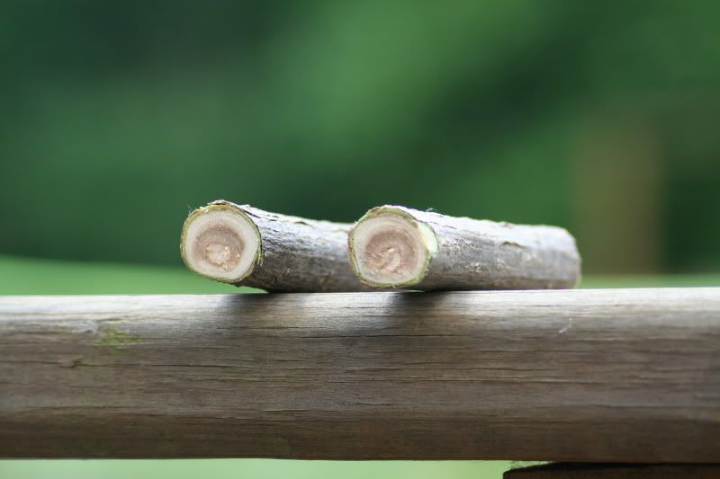

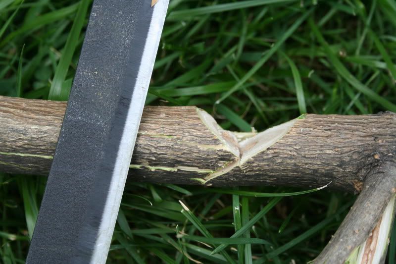

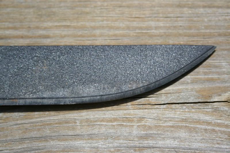

The Waki came toothy sharp, but the profile is pretty thick right behind the edge. Some test chops on thumb thick branches shows that the Ruck cuts cleaner, with less crushing evident. Ruck cut on left.

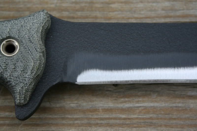

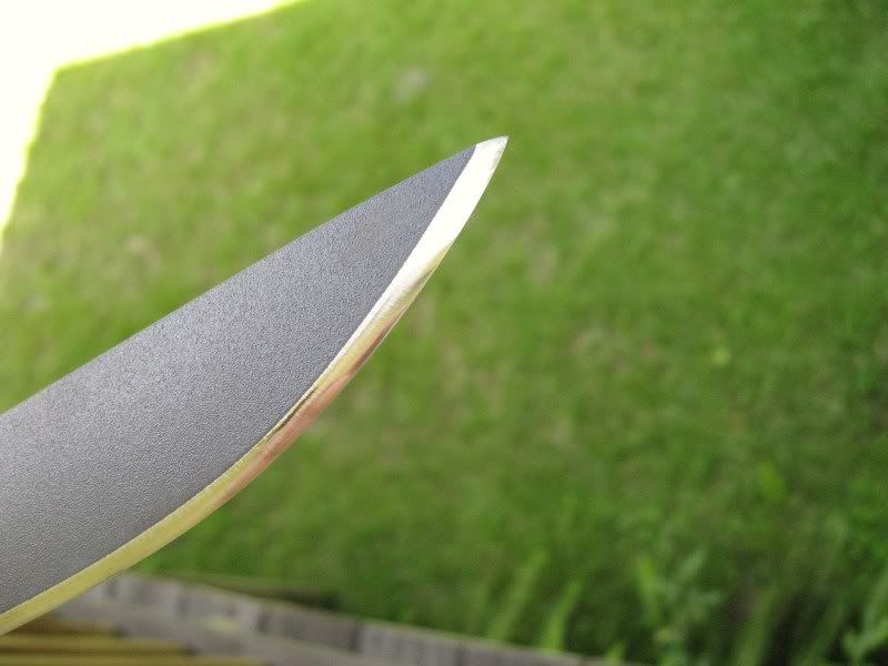

Close up of edge and tip before we get out the HF 1x30 belt grinder.

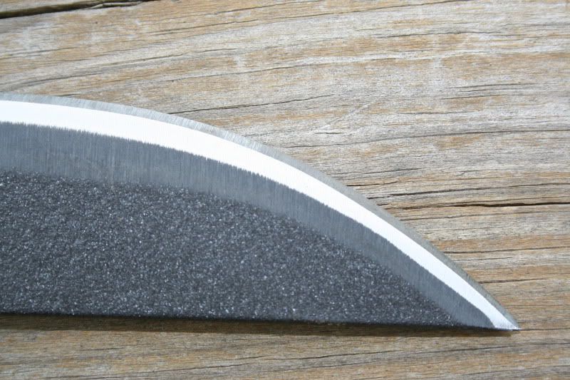

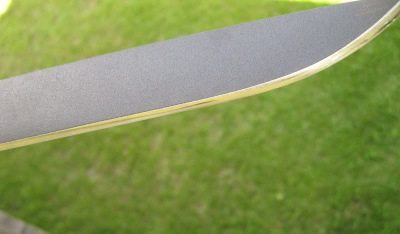

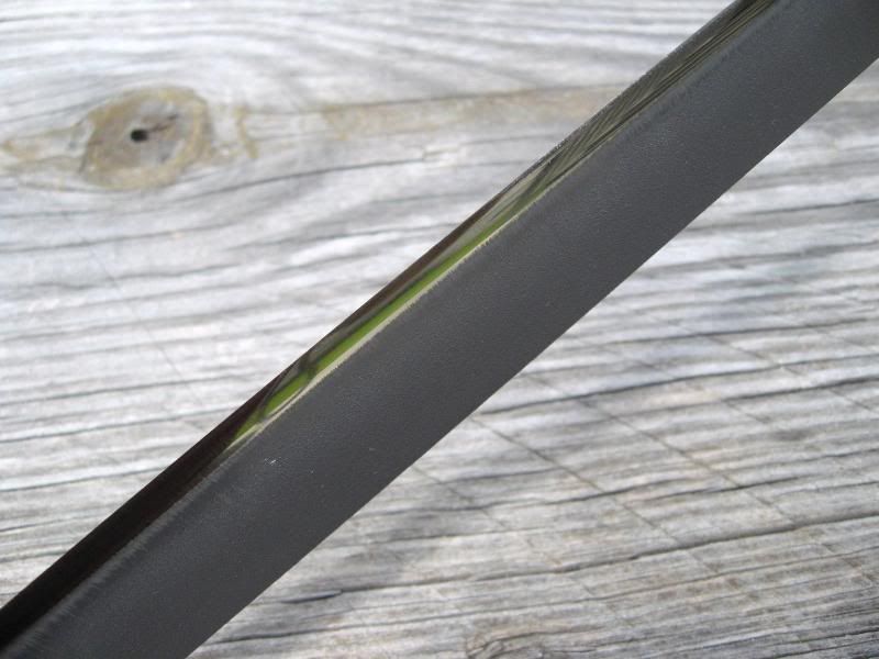

I decided to grind first and strip later, so the coating helps one to see how the work is going. After some passes with the 80 grit belt, starting to take the shoulder down.
A little more work, starting to blend towards convex.

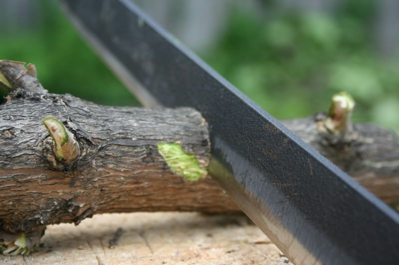

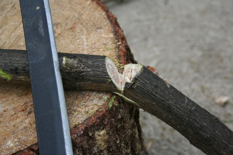

More test/fun cuts. Slashing unsupported branches works well.
Cutting straight down on a branch on the stump, the blade wedges in place as there is no place for the wood to go.

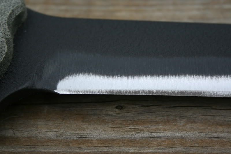

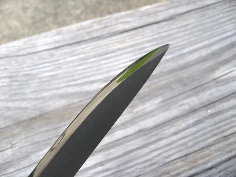

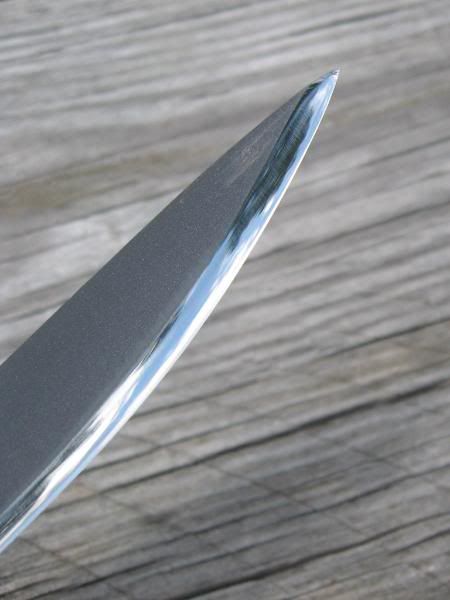

Starting to look like a convex profile. I’ll do a little more today at 80 grit, then switch to 120 and gradually higher. Maybe I’ll strip it first.

Well, it's stripped now. Same dull gray as INFI under the coating. Pics later. The various marks on the flats are probably left over from the hot rolling process at the mill, or a rough grind after the rolling to remove scale. Hey Vic, did you have this problem on your HF grinder? When I try to flat grind against the platen, the blade chatters badly, so it not possible to do a smooth flat grind, or grind flat areas. I will have to get out a sanding block and hand finish the flats.
... Hey Vic, did you have this problem on your HF grinder? When I try to flat grind against the platen, the blade chatters badly, so it not possible to do a smooth flat grind, or grind flat areas. I will have to get out a sanding block and hand finish the flats.
Yes, and it has done it with every single belt grinder I ever used. You have to get the blade square with the platen and use light pressure. All easier said than done. I think sanding the flats is easier with a disk grinder. That is why I sometimes just do a full convex on some blades. It looks better than my uneven sanding on the flats. On my new Waki, I didn't go for a very thin edge, but just put a slightly narrower convex on the blade. The edge will be stronger for the abuse I give it than a super thin convex edge.
