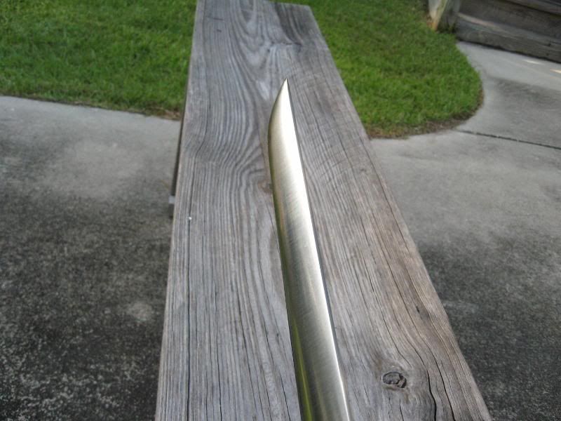

:confused: Mine didn't seem convex at all. Pretty much flat grind to a thick V secondary edge and V primary edge. Profle much like my AK47.
Mine is definitely convex and appears full height convex - although it can be hard to tell through the coating.
However, at the very least, the ricasso and pommel are flat. So, for those stripping their blades who want a nice satin finish on "all" exposed steel, the ricasso and pommel will need significant amounts of sanding to removed dimples, machine marks and such. :(
But, from my experience, the Waki's ricasso and the pommel are both too small to properly work on with a belt sander with the scales attached. So, the ricasso and pommel will either have to be done by hand, remove the scales or leave the coating - which doesn't look as nice IMO. :(
I like ALL of my knives to be satin and the Waki is no exception. The Sage coating is a bit nicer looking than most other coatings, but still NOWHERE NEAR as nice as a nice satin blade IMO.
Further, I think this blade BEGS to be full convex. :thumbup:

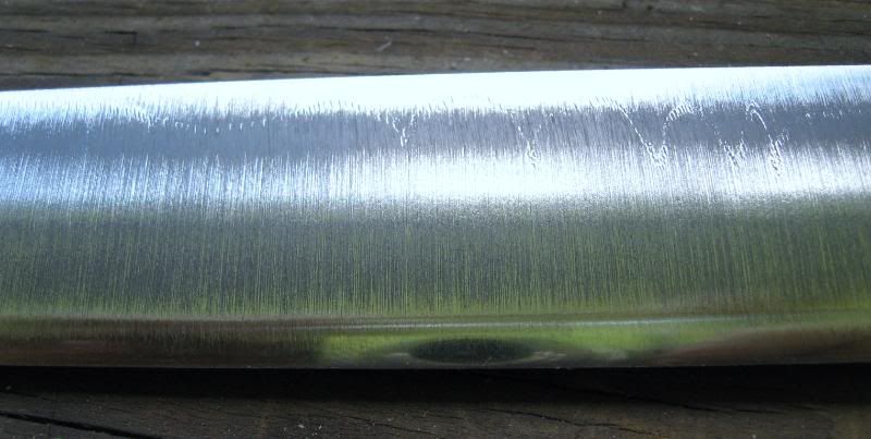

Sometimes those hamon lines are hard to see and even harder to photograph. I thank rezinguy for showing us all just how much work it is to do a satin finish. There is a reason those satin LEs cost so much. Several of my older Swamp Rats and Busses have "Ghetto" satin finishes that are not near as nice as rezinguy's. :thumbup: Darn you, rezinguy. I went and did mine today. What a lot of sanding that was!

Is the darker line in the middle of the blade the hamon line?
In general, with any knife, when there is a visible hamon, it's usually pretty obvious, like the one on the M9LE...
Differentially hardened can also be a gradual process, where there isn't a narrow transition between hardnesses, in which case you would have no hamon.
You can see it quite clearly in this pic, especially near the tip where it's catching the light.
I am not sure, but I think it is along the line shown here between the polished edge and the rougher blade. Maybe if I polish the blade more, it will show better. In any case, if it were not differentially tempered the blade could never be bent like they did in the test video without breaking.

Maybe one day soon I'll polish the blade some and find that darned hamon line! But not today. That sanding takes some time. My third world satin finish will just have to do for a while.

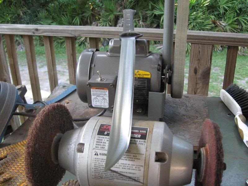

Well, it's stripped now. Same dull gray as INFI under the coating. Pics later. The various marks on the flats are probably left over from the hot rolling process at the mill, or a rough grind after the rolling to remove scale. Hey Vic, did you have this problem on your HF grinder? When I try to flat grind against the platen, the blade chatters badly, so it not possible to do a smooth flat grind, or grind flat areas. I will have to get out a sanding block and hand finish the flats.
I have that exact same problem when I try to use the flat platen (in the looses sense of that word) on my HF grinder. I pretty much only use it for convexing or shaping g-11 or mycarta etc.
