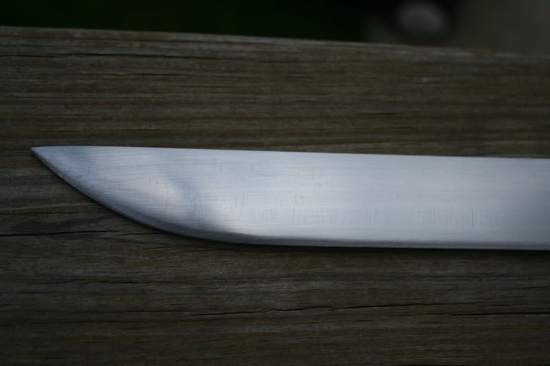

I think it is a slightly curved or convex grind. I still want to see the fully convexed blade. :D

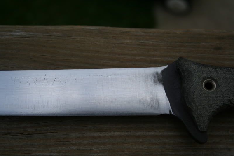

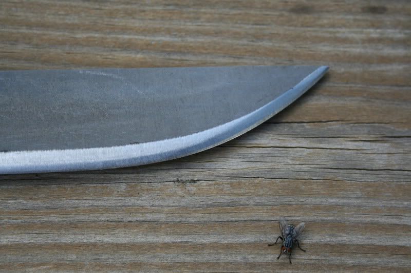

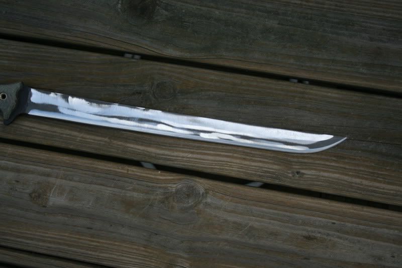

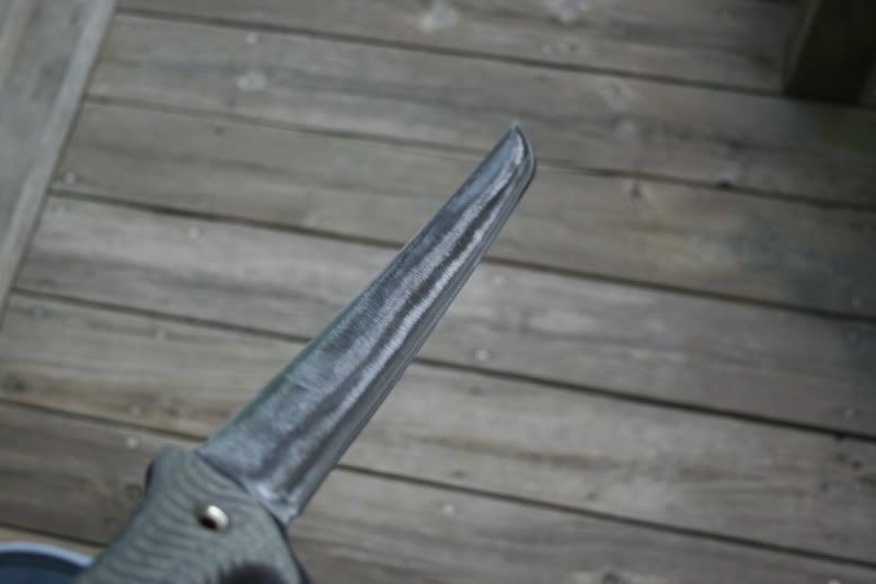

As I said, after stripping, it’s dull grey.

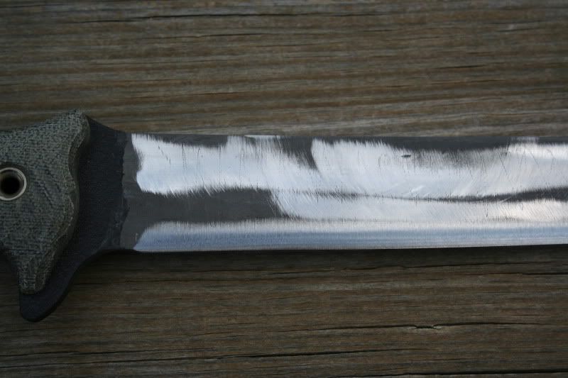

These big, deep zig-zag marks are not uncommon on coated Busse knives. Don’t know exactly where they come from. Marks from the steel mill?

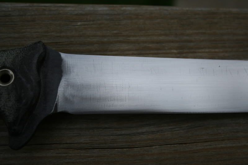

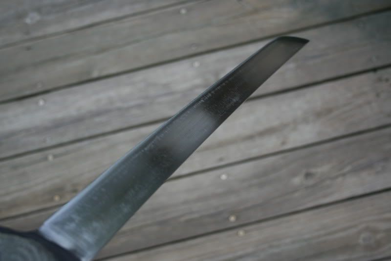

After a few passes on the disc sander.

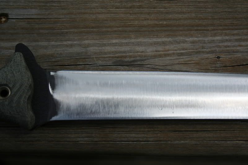

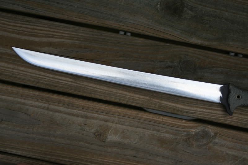

After a LOT of work with the 80 grit belt.

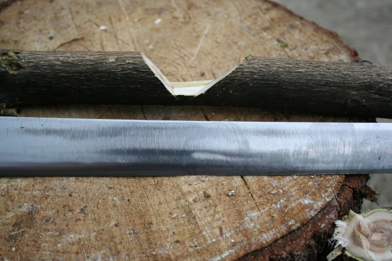

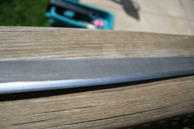

Back to test cutting. I think it cuts cleaner. Could be wishful thinking.

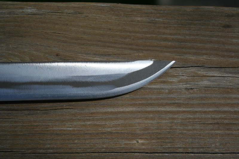

The previous plan view pictures don’t convey how funky the grind looks. Looking down the blade with the right light, it’s ugly. In hindsight, the disc grinder was a mistake. The disc was too coarse, and even if it had not been, I think it would be hard to control the depth of the cut.

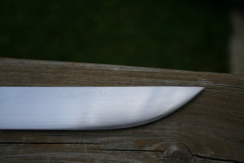

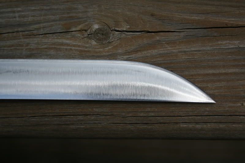

Since I am a lazy, impatient hack, I decided it would take too long to get rid of all the grind marks. Got out the hard rubber sanding block and 150 grit paper. Sprayed the paper and the blade with WD40 (tip from the Makers forum). Long strokes along the full length of the blade get rid of most of the transverse grind lines.

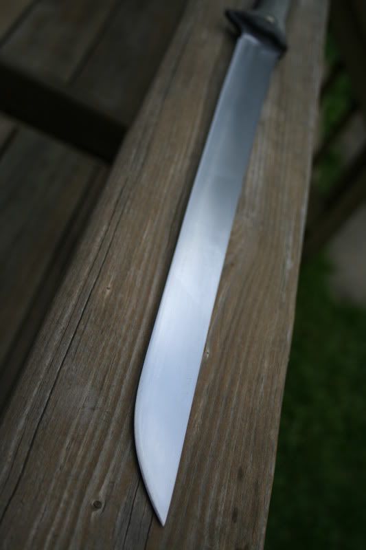

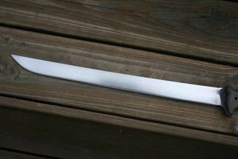

So, there it is. The Ghetto Satin is complete. It helps if you have low standards.
I need to go back and work on the convex edge some more with a succession of finer grit belts. It is possible to do a job like this without the belt sander, as my Ruck was done by hand. Takes longer, but if you don’t change the edge geometry much, you probably can preserve your warranty. So you too can be the first on your block with a Satin Waki.
And, before you ask… NO I will not do your Waki.. I don’t mind hacking up my Waki, and voiding my warranty, but I won’t do it to yours.
Wow, rezinguy. It is coming along nicely. I knew it would be a huge job for a 1" belt sander. It took me forever to do my NMSFNO and FFBM. I was hoping for a smoother surface under the paint. Keep at it with some new belts and you will get there. If you grind edge up, keeping the very edge off the belt, you will get a nice smooth convex profile. Then go to finer grits to sand out the grind marks. Don't take it down to the final edge until the blade is pretty smooth. Once you get a burr or wire edge, go to 40 micron, then 15 micron for a finished, polished edge. It will be beautiful and worth all the effort. You're half way there already. :thumbup:
