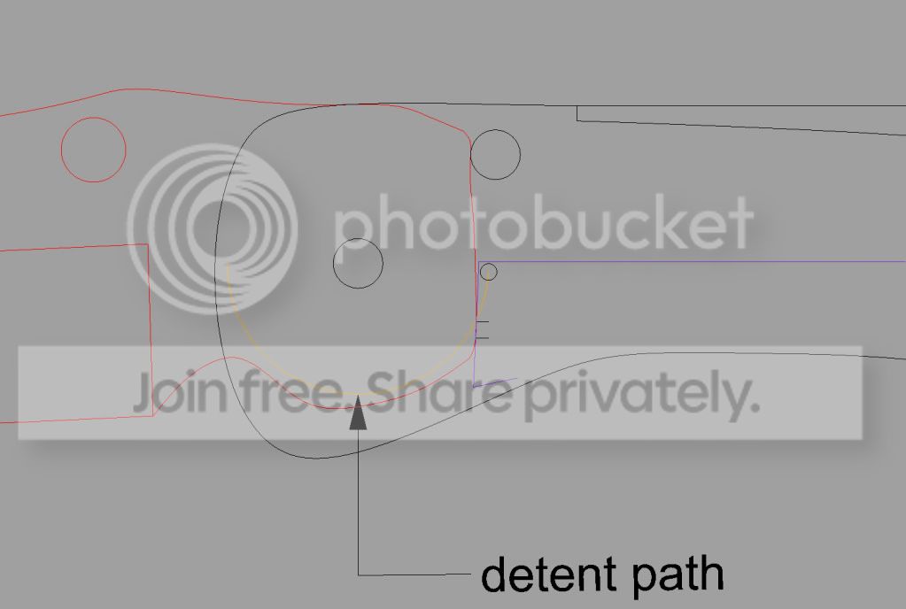

While Ron's triangle is hard to visualize, a circle is easy. Start all folder tang design with a circle the size of the pivot. Then draw in a second circle that is the distance from center that the farthest part of the blade from the pivot ( usually the spine). Last, draw a circle where the detent will ride. From these three concentric circles you can place all the lock components and then extend the blade out from that. Once you have this, you can remove parts of the tang to shape it as you wish, as long as any of those circles do not get crossed. Thus you add a flat for the lock, a dip from the outer circle to nearly the detent circle for the stop pin,shape the heel so it still keeps the detent on the tang during close, position the closed stop so the blade rests just proud of the standoffs, etc.
If you add those circles to your drawing, you will instantly see what Ron saw.

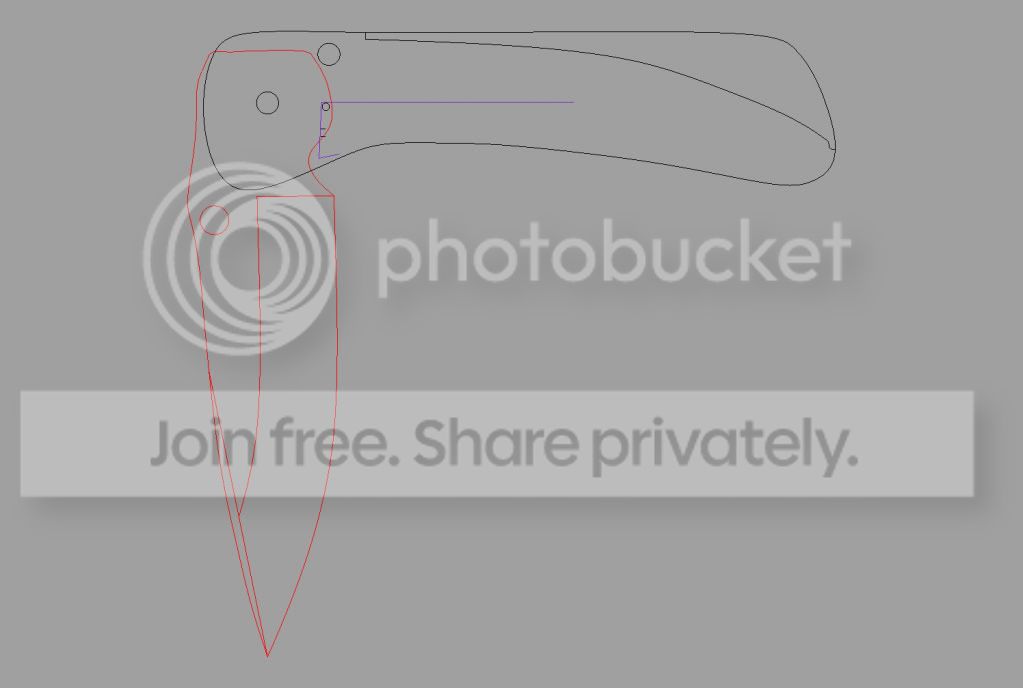

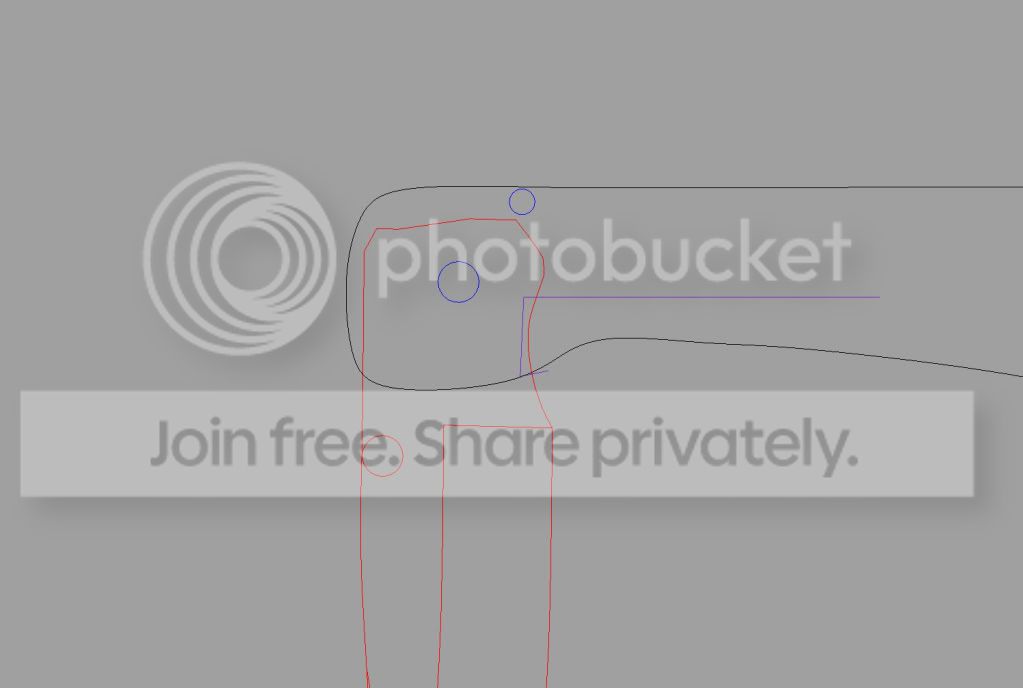

Well with all the great advice I have been getting here I have decided to keep trucking with the design of this knife. I see what was meant by getting the perfect triangle was almost impossible, I have been trying for the last 3.5 hours and I am still not there:o Just how close is close enough? I am with in .2 units ( I haven't set a measurement scale) from largest side to smallest side.
So here is where I am at right now
Open
possible rollout problem at 90*
Closed
Just what sort of tolerances are needed between the stop pin and the blade through its travel and the closed position?

I don't have a measurement for close, I just eyeball it. On the design you just did, I would keep the stop pin at least 1/16" down from the top of the handle. You may need some room to grind there. You could also move the stop pin toward the back of the knife some (right) to avoid the blade bumping while closing. I hope you don't think I am trying to nitpick you ... I know you have put a lot of time and thought into this. I am just trying to help.

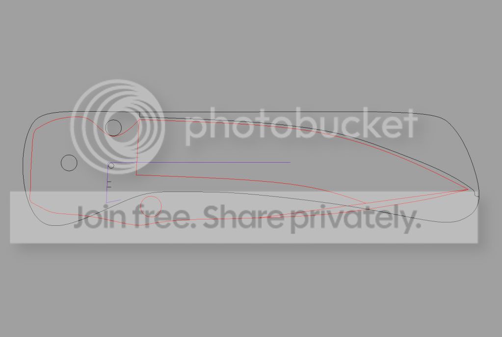

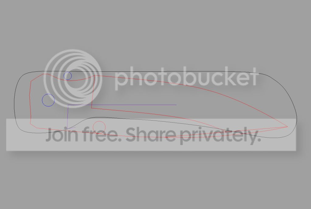

So after much tweaking, being off work gives me a crap load of time infront of the computer, this is what I have come up with, with the much appreciated help of rbendele.
3D image
So if anything looks off to you speak up, Now it just a thing of collecting materials and getting to work on it. I have actually started to think about going stainless for them instead of the pattern welded steel, because I really want to make a little bird and trout out of that.

I don't mean to sound overly critical. This is much more advanced than anything I've done, afterall.
Anyway, I think you might want to put a little bit more personality into the profile of the handle. Right now, it looks soft and uncommitted.
All of the sides and corners seem to live apart from one another, without any kind of reference or balance. This gives the handle a kind of "mushy" or "saggy" appearance. Compare that to the clean, pristine profile of the blade and they don't seem to match up well.
Try drawing a few by hand and then scanning your drawing into the computer, then you can retrace it in your cad program and end up with something a little more clean, solid and balanced.
Nothing is set in stone yet and I am tweaking the shape all the time. Once I get something close and before I ever start the actual knife I will be making mock ups of it out of wood and other materials to do the final adjustments to the shape of the handle. Right now I have based the handle off of my BM710 but with a more pronounced drop at the back. It's hard to see in the 3D mock up that the top of the handle does arch because of the shadows, and the mushy look I think you are referring to is the bump map I used to give the handle a bit of texture, it just doesn't give a nice transition from the flat to the curve of the chamfer:o
Don't take this as I am rebutting everything that you have mentioned, I will look into every bit of advice I am given. In the long run it will be what ever feels best in my hand for the first one and then when I have a working prototype I will hand it around to others to try out and give opinions on possible improvements. The first prototype will be a lefty too:p
