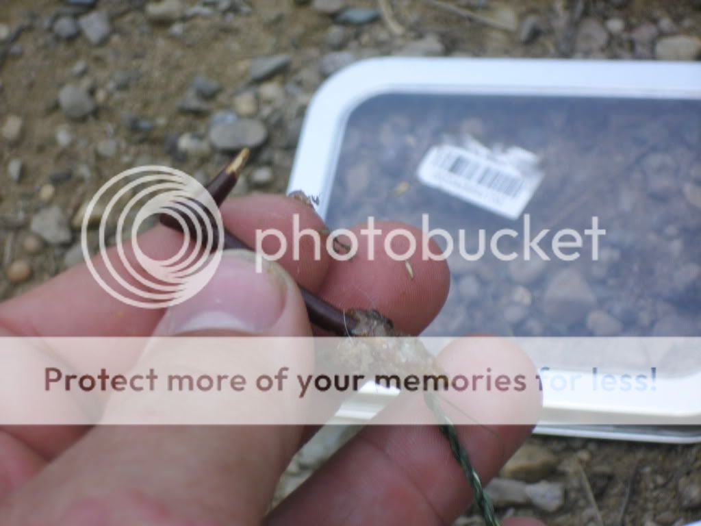

here's an imrpoptu fly made from a feather and adhered with pitch glue
almost forgot the hook made from a black locust thorn
I thought the setup looked cool but no suprise that I didn;t catch any blue gills oh well it was fun

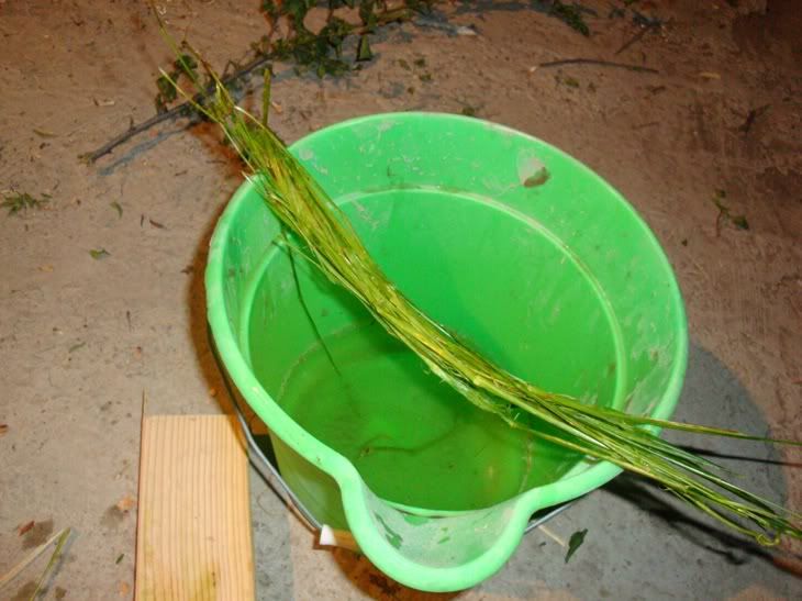

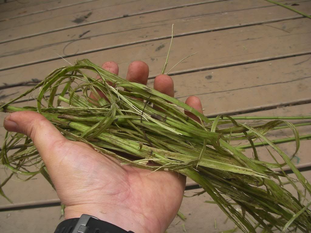

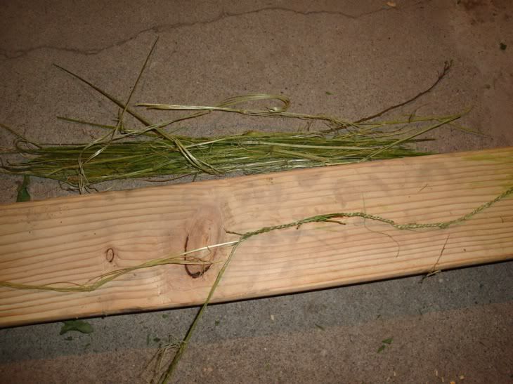

Here is my first entry, I haven't had time to head to my favorite piece of public land, so i went to my back yard and found some wild grasses in a corner (this way if my wife asks what I've been doing I can say, "weeding the back yard.";)) In northern Utah similar grasses are the most abundant type of wild vegetation, so although they may not be ideal, they are very practical.

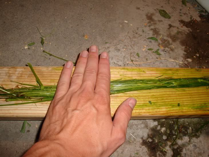

The first step was to strip of the leaves and the heads. I'm interested in the fibers making up the stalks because they are the strongest in the plant.

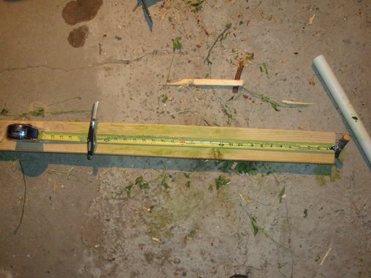

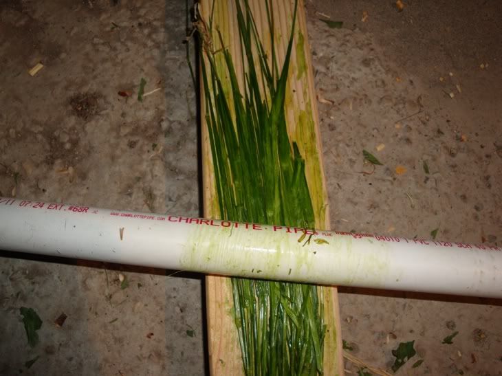

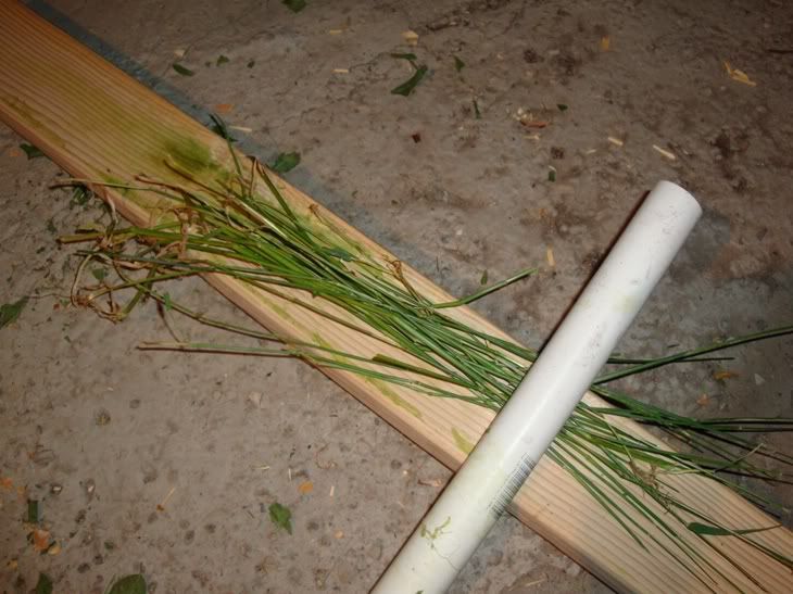

Next, I begin to crush them to break them down. I admit that pvc and 2x4s aren't the most "natural" tools, but you usually can find or make something equivalent in the wild. I've heard people talk about "pounding" stalks to get to the fibers, but a good piece of advice I stumbled across was to use something like a rolling pin.
What I was really trying to do with rolling the stalks out was to break up the pulpy material that binds the fibers together. Dunking the bundle in some water, or simply pouring some water on the bundle as it was rolled was a good way to flush out the pulp. This is also why I got rid of the leaf blades. Although they have fibers in them they have a higher level of pulp and they tend to stick to the roller.
Once the bundle had become relatively flexible I rolled it by hand perpendicular to the dirrection of the fibers. I would also twist the bundle lightly, not enough to start snapping anything, but enought to loosen them up a little.

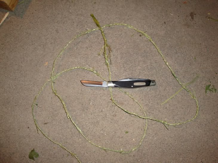

I then pressed out as much moisture as I could and then began to reverse-wrap the bundle. I think the reverse wrap is the probably the most important thing to learn when it comes to making natural cordage since it allows you to make a long rope out of relatively short fibers. The most helpful resource I found was a video posted here. The fibers dried very quickly, and by the time I was splicing in my second or third smaller bundle of fibers I was moistening my fingers to help get a better grip when twisting.
I ended up with just under 6' of twine from my origional bundle. This would be good for lashing or wrappings, but not so much for holding much weight because of the variations in thickness.
I decided to wrap the twine over on itself again to create a stronger and more uniform cord. I ended up with 28".

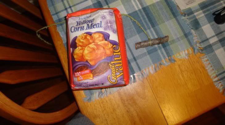

I couldn't find my weights (even though I use them on a regular basis:rolleyes:) so I had to improvise.
The cord held bag containing a five pound bag of corn meal, a five pound bag of rice, and a three quart jug of apple cider (about 6 lbs) when I heard a couple of snaps. I decided not to test the cord untill failure, but I would put its strength as about 12 lbs for a static load, and 5 lbs for a dynamic load. It's strong enought that I would feel confident using it to set a trap or attaching a piece of gear to a pack or belt.

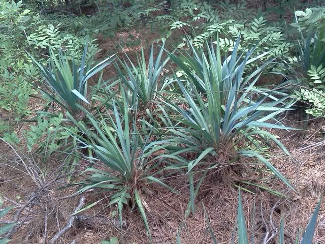

Here is a picture of the type of plant i used. Yucca.
Here I'm seperating the fibers with a rock. You can see the untouched one above
Double twisting them together
Here it is finished. Came out at about 30". I could see using something like this as a bow string. I tested it and it held 40# so far. I'll do more until it breaks.

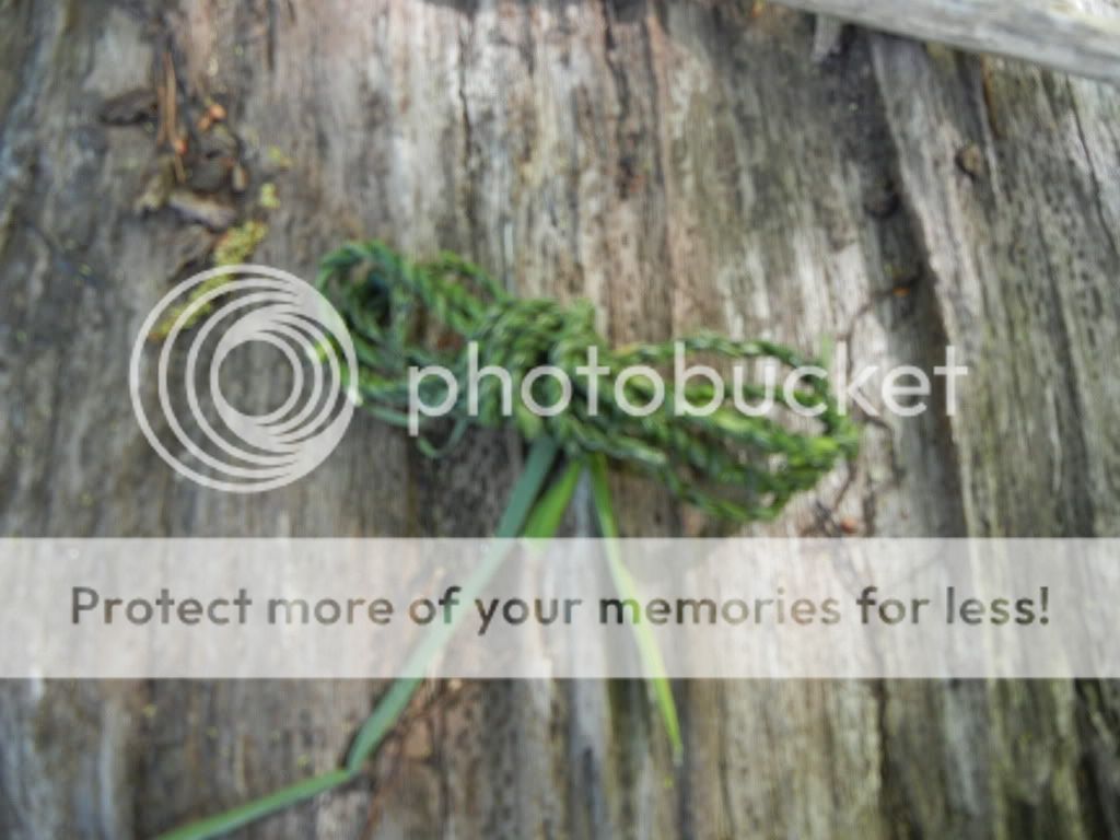

I decided to try making twisted cordage from some sawgrass growing out back.
The only real trick to working with sawgrass is to remember that the "teeth" all face the tip...you don't want to run your arm along it the wrong way.
Anyways, I started by splitting the blades lengthwise. Then I just did a reverse twist.
Ended up with about 2.5 feet total, fashioned it into a makeshift lanyard. Not too shabby for my first attempt at twisting some cordage. Its alot stronger than I expected, I'll try to take some pics of a weight test sometime this weekend.

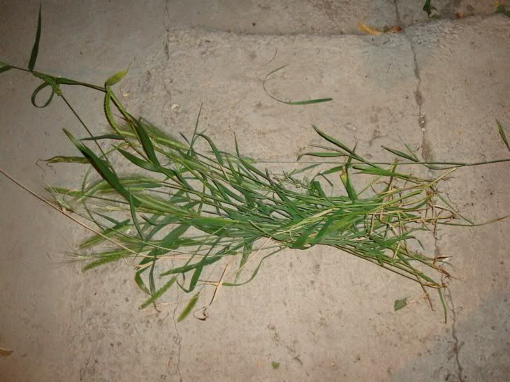

I spent a couple of hours Friday night and Saturday morning learning how to make a lariat braid. Today (Sunday) I harvested some tall grass and and tried it out.
I found what appears to be 2 types of grass. I chose the grass on the left which seems greener.
Here is the raw material after cleaning

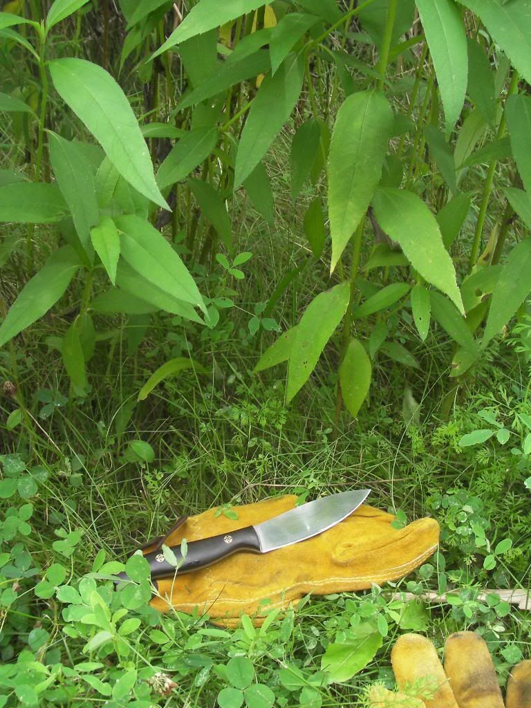

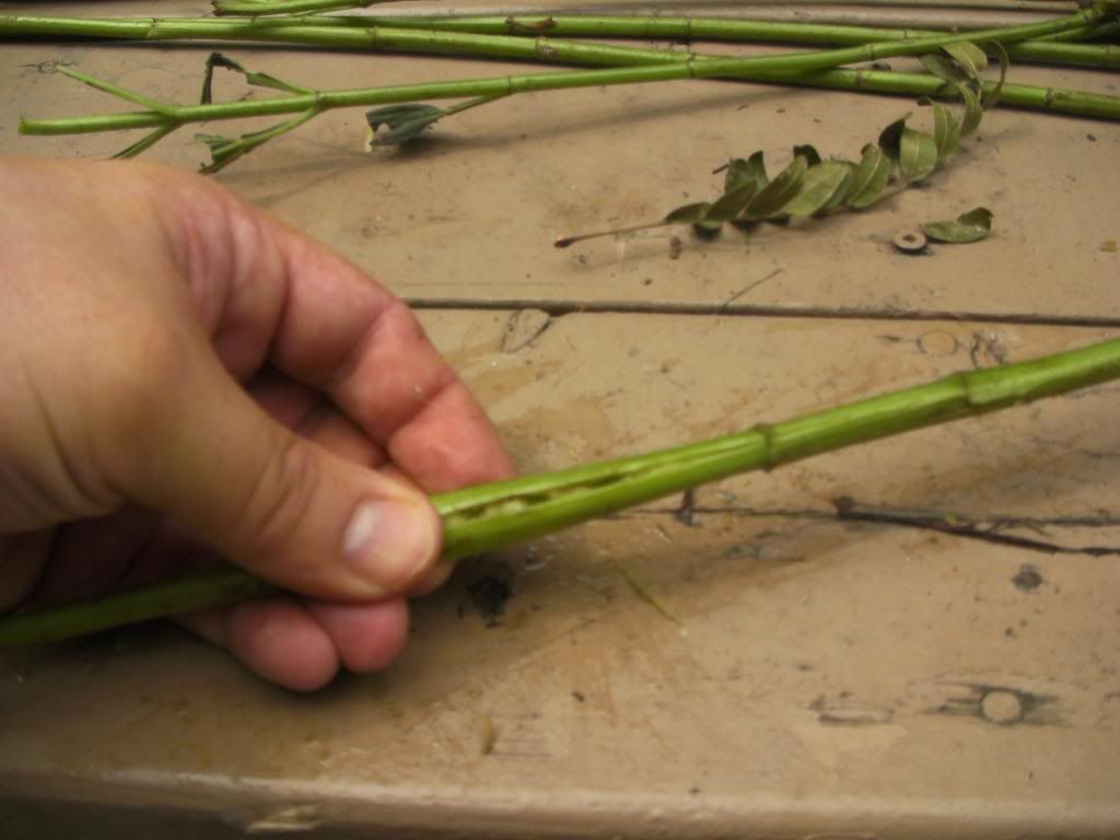

Okay, here is my go at the contest generously being sponsored by Rotte - Great Idea for a skills contest BTW.

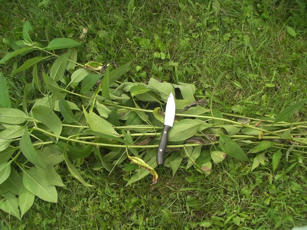

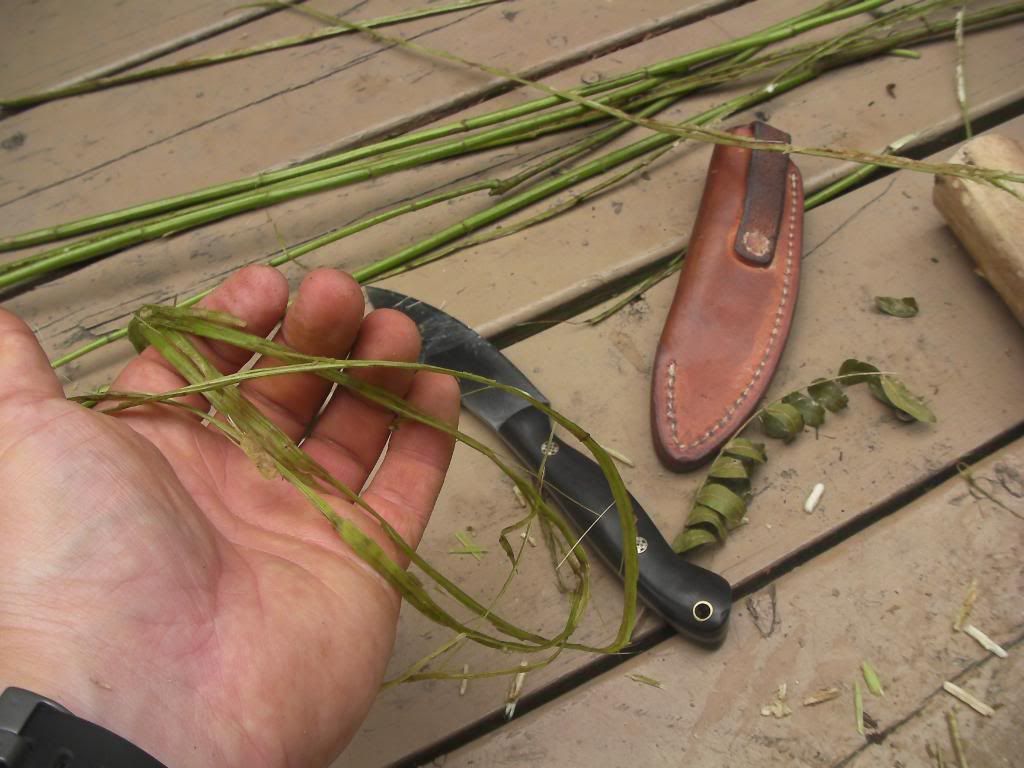

Today, I went to a local field and came upon some stinging nettle. Better wear gloves before harvesting!

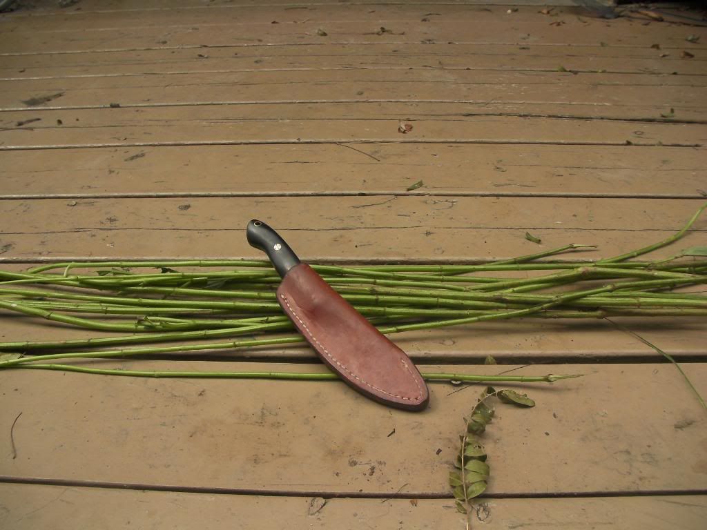

After carting my harvest home, I then de-leafed the stems and made sure to rub the stems down with my gloves to get rid of any more needles.

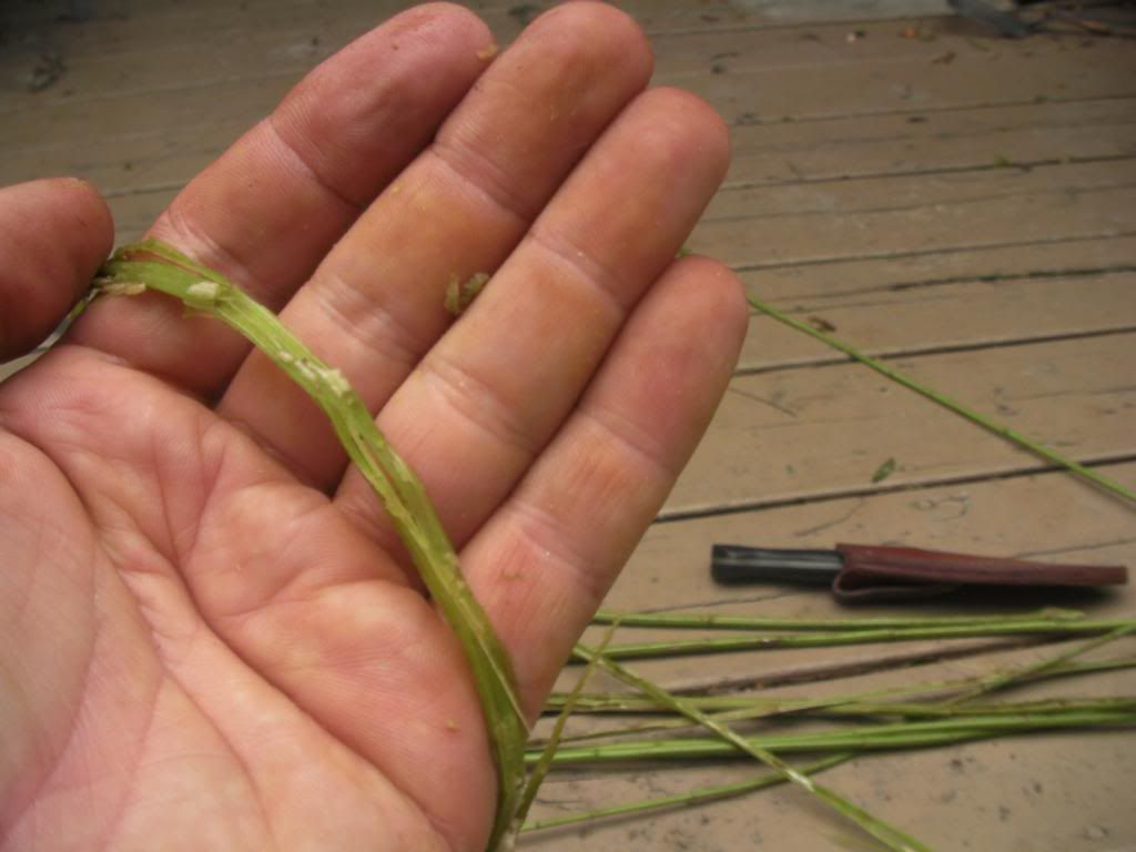

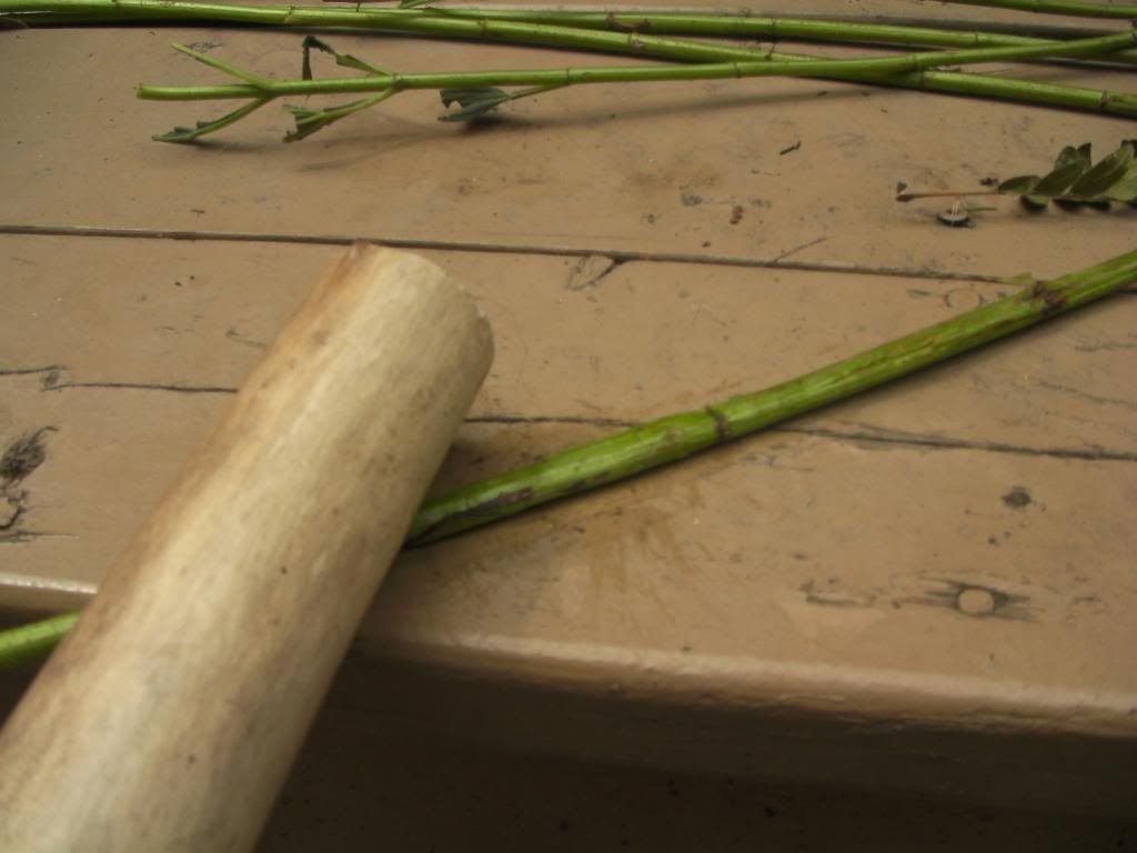

Lightly pounded the stems to split and separate it into quarters.
Then peeled the outer bark. Lesson learned, it pays to take your time on this part and don't get to cocky trying to pluck out too big of pieces of pith.

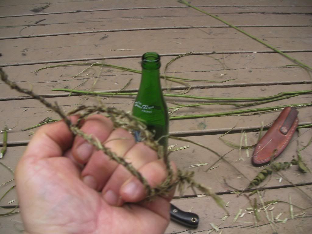

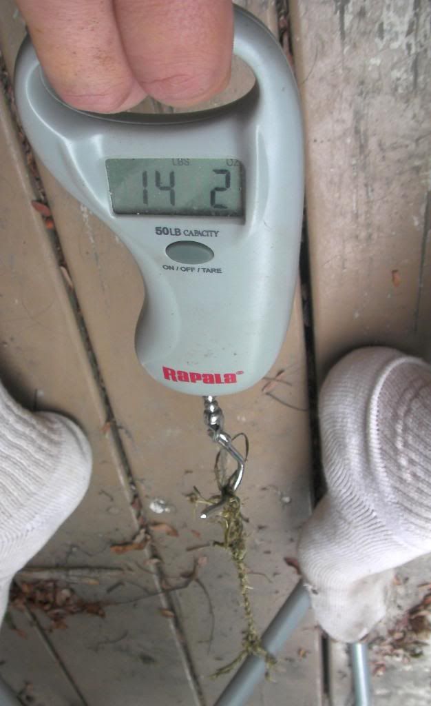

Then I proceeded to reverse wrap the fibers. I made about 6' of two strand twist, then folded it in half to double it up. This was all done while wet and it would have paid to allow the fibers to dry first and then re-soak them right before twisting.
For the breakage test, I tied it to my fishing scale and pulled until it broke. The picture taken below indicates 14#, but I clocked 16 # 8Oz just before it snapped. Not the best on the weight test, but I have my ideas on how to improve the strands during processing.

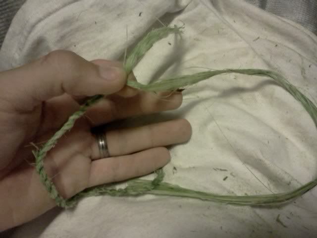

Ive been trying to come up with some new things. Collected a bunch of corn silk today , thought that I could do something with it but failed. Made a cord out of Virginia Creeper but it was just like my other vine cord only not as strong . I"ll keep plugging away and might get in another entry before the deadline.

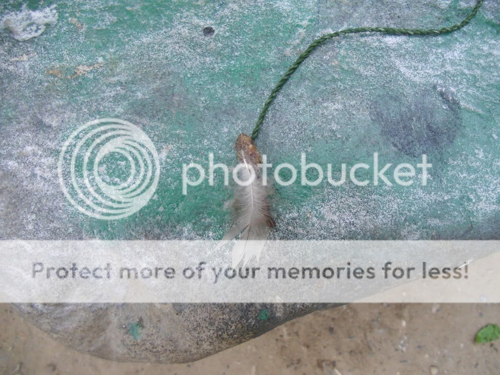

I don't think they are stinging nettles Ken, definitely not like any I've seen anyway ?
