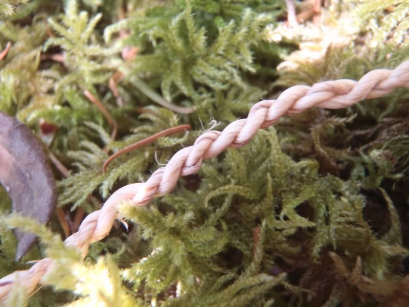

I decided to try my hand at Nettle cordage~

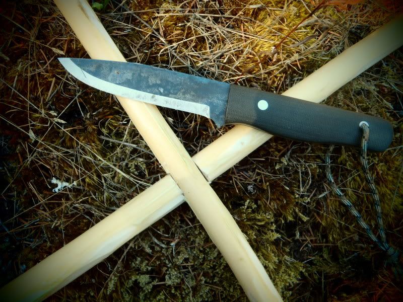

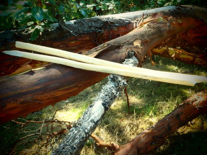

These are the stems all stripped of leaves and stingers~

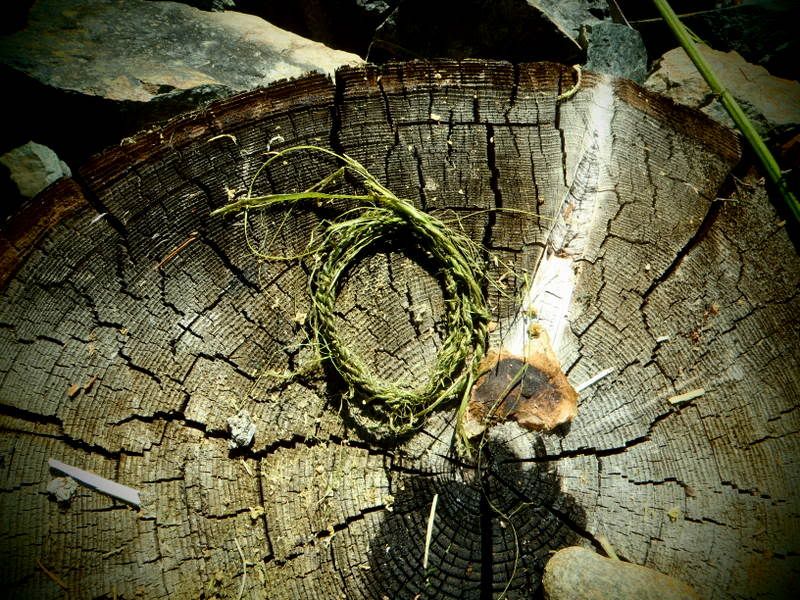

My first Nettle cordage~

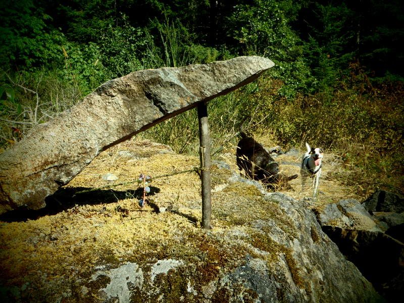

I used it to set up a Promontory peg deadfall trap, worked great and seemed pretty strong stuff !

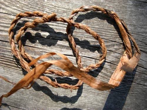

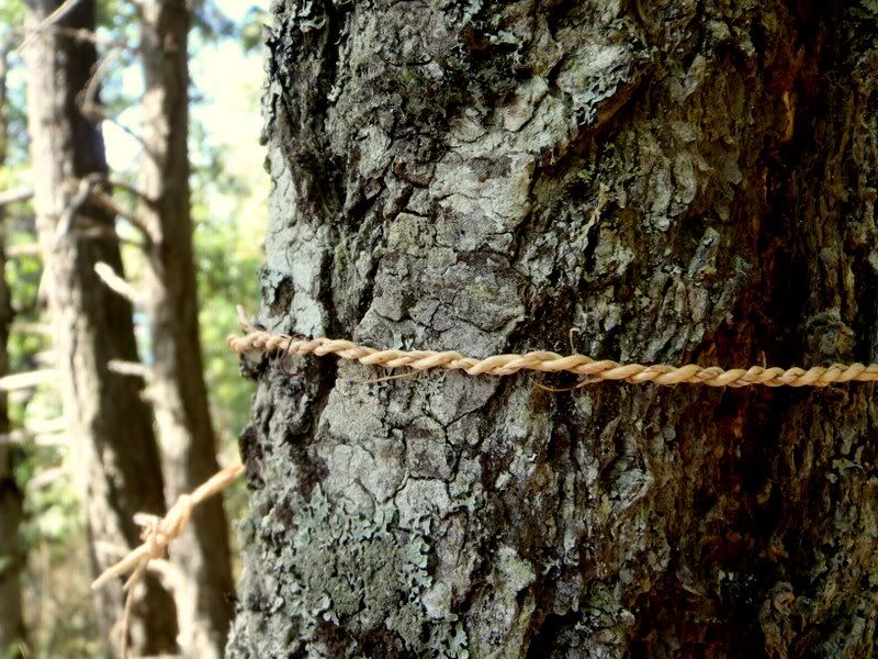

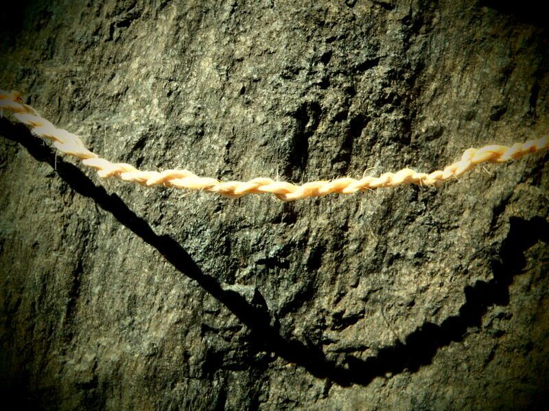

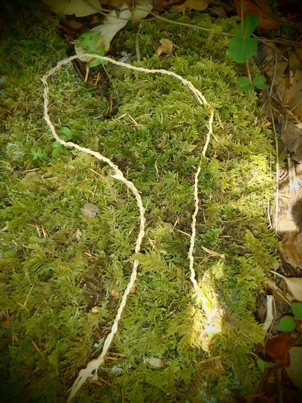

I then decided to make some using the inner bark from a Cedar tree, this was tricky stuff to work with as it made my hands very sticky !!!
I made some more the same day using some small Cedar roots, I love these, probably my favourite natural cordage~
Very strong stuff, could be used for many applications !

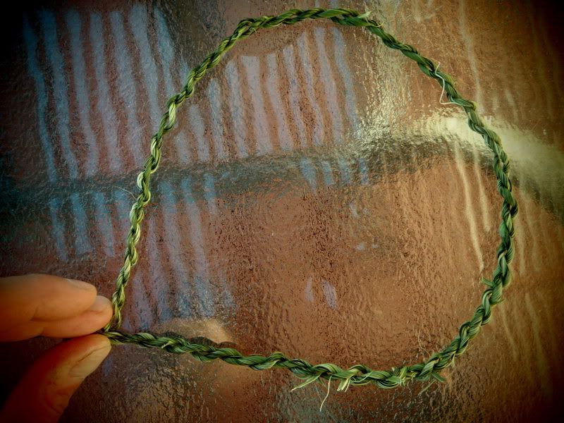

And finally today I decided to make some using some ordinary grass~
I had to be careful with this stuff as it tended to tear if you over twisted it. It still produced some decent cordage though and was stronger than I thought it would be !

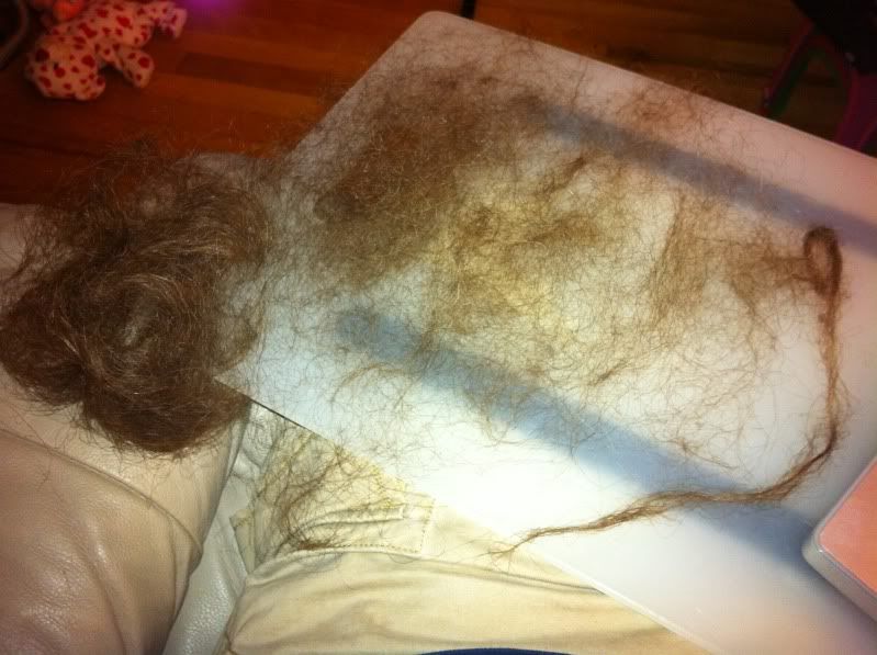

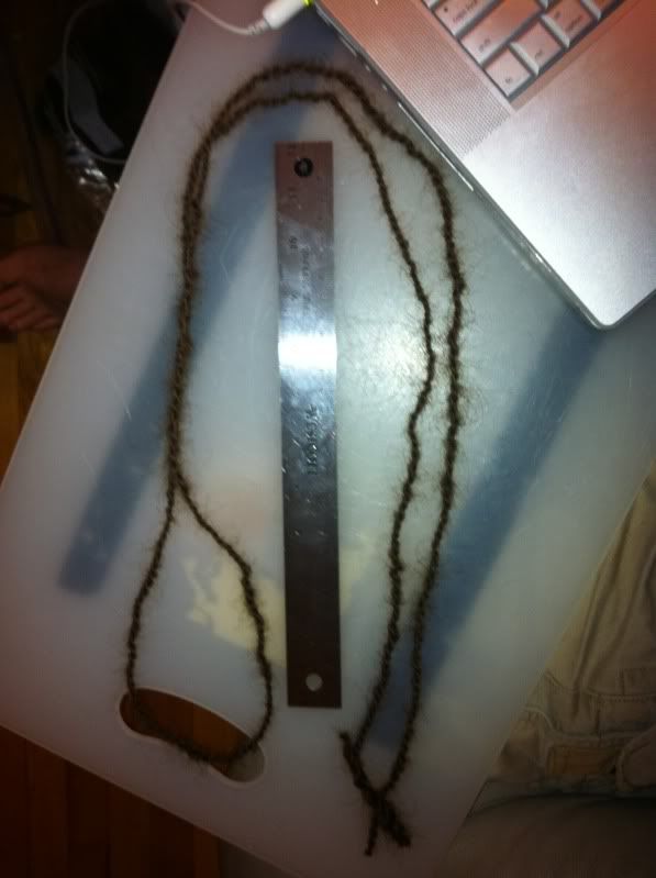

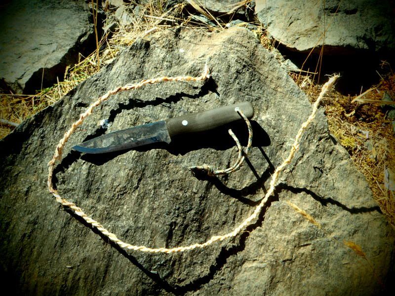

I made my cord tonight. It took about an hour to twist while watching MMA and having a couple Wild Rose Wraspberry Ale's. I need no knife and only one semi-specialized tool.
Here is the first ever cord/rope I made by twisting:
Here is tonight's progression:
Starting out
Preformed:
6', one hour later
I learned using my own hair from a brush as I learned while recovering from broken legs. It is readily available for most of us, fairly weatherproof, UV and moisture resistant and very strong. I'm not good at keeping the strands the same diameter, so strength is variable, but I have used it in the field to do quick knots and binding with what I can pull loose from my ponytail. I will try a strength test with it tomorrow, I have doubled it up on itself again 3/16-1/4" thick, 2'8" long, I am guessing it will hold well over 100#.
I want to try hollyhocks later if I get the chance. Bed now.

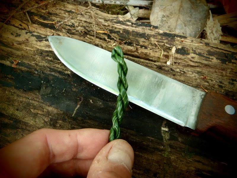

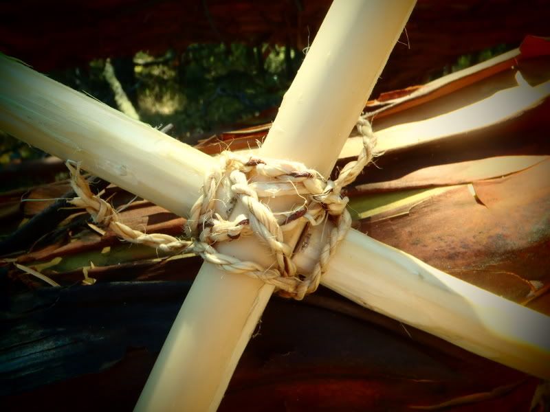

Today, I went for a walk intent on making some cord for this contest. I had never been in this area before, but I did find what I believe to be some Japanese Knot Weed. I have never worked with this material before, but I am pretty happy with the results.
I didn't think to start taking pictures until I had already started, so...
The Gransfors Bruks mini hatchet did an alright job in breaking up the stalk into long, fibrous strands. between the steel and the rock I used though, it was a little hard on the material, resulting on a less than neat finished product. However, in the end, it worked and it was fast and that's what's most important to me.
I then folded it in the middle did a reverse twist to make the final cord.
Then, I wanted to see how it would handle being tied in a knot.
It was not all that flexible, but it did hold well enough here that it could be used for shelter building. As for strength, when tying it off, I pulled as hard as I could on the knot with no outright breaking. It's pretty strong, stronger than I expected even.
It wasn't all that time consuming to make either, but a little messy, as the stalks are filled with sap. No allergic reaction so far, but I don't react to poison ivy either. It was imported as an ornamental plant, so it's probably fairly safe though.

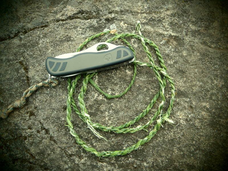

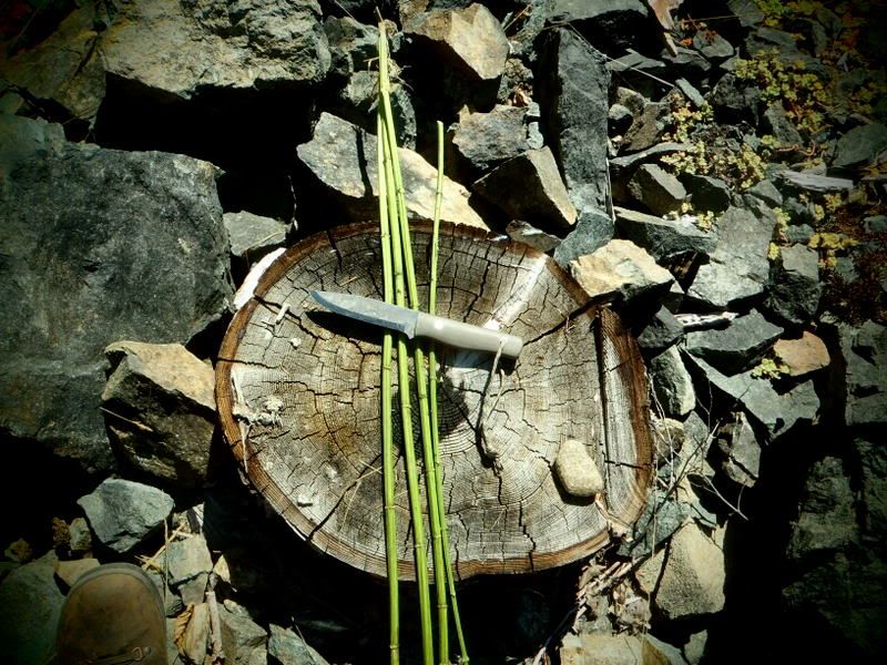

When I took the dogs today I came upon some rushes, maybe Cattail stalks and decided to twist these up and make some cordage as I hiked. Eventually I ran out of stalks and there were no new ones to be seen. I thought to myself why not mix different plants, so I grabbed some tall grass type rush's and started twisting them in with the Cattails.
Anyway what I ended up with was around 3 feet of tough if not very pretty cordage~
Good enough for an improvised dog leash~
And plenty strong enough for lashing a shelter together etc~
