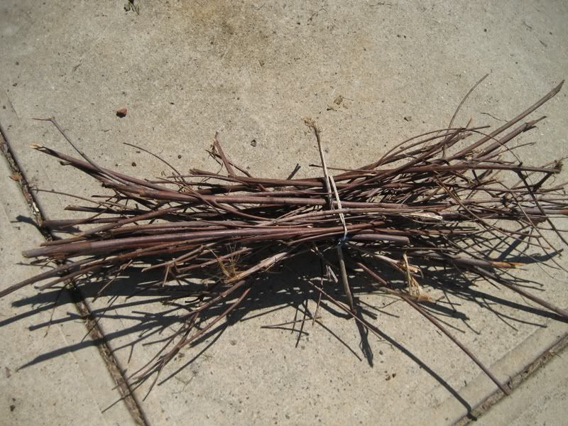

Rainsparrow and I were able to get out and do some cordage work this weekend. Firstly, here is some dogbane/indian hemp we'd gathered and stripped of branches.

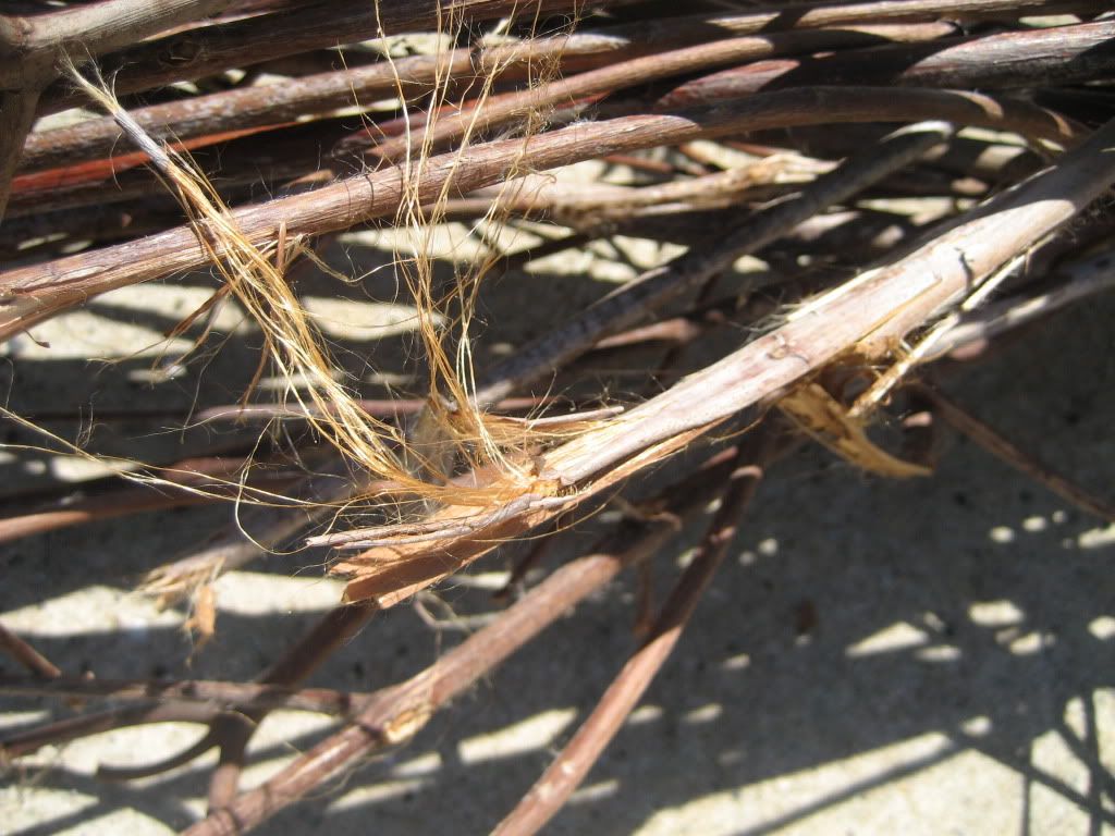

Here are the goodie fibers that are in dogbane.

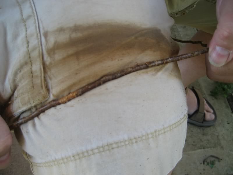

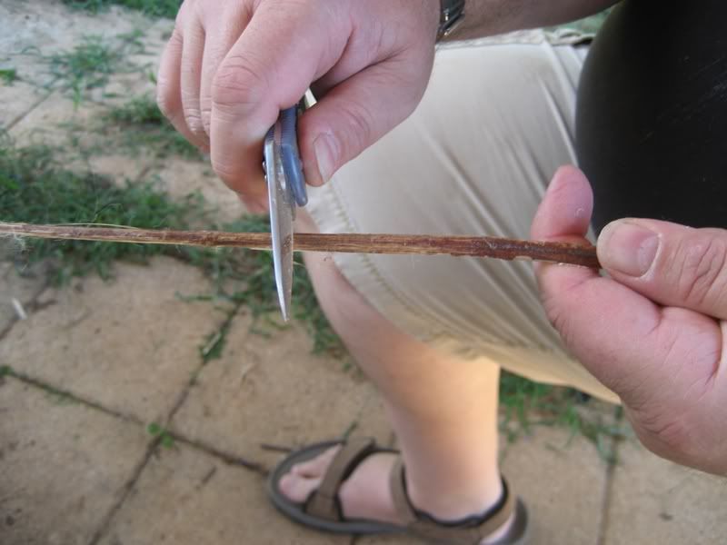

I used my Spyderco ZDP Delica to make light back and forth scraping to remove some of the skin.

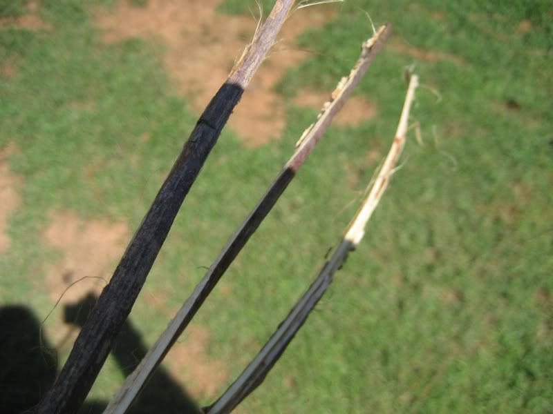

Then, I crushed a stalk or two under my giant clown feet so we could separate the stems from the fibers.

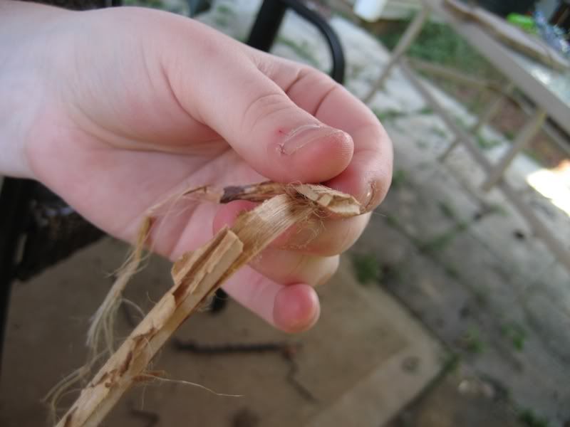

Here are a couple of shots of Rainsparrow and I breaking off small pieces of stem and separating them from the fibers.

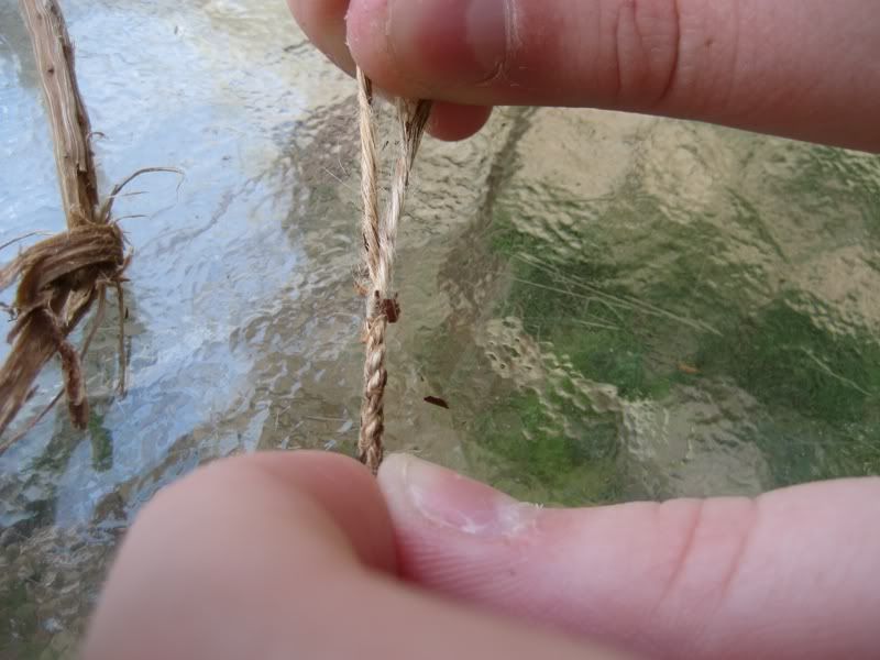

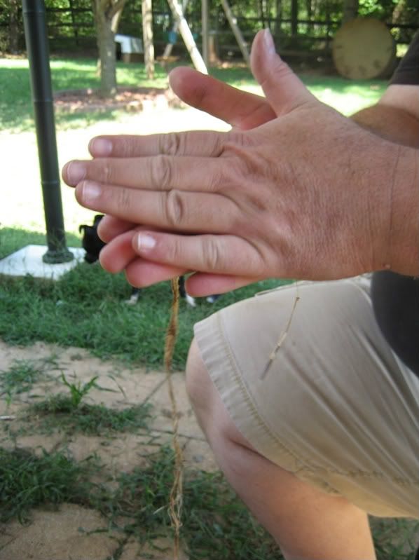

Once I have a length of fibers I wet my hands and roll them a bit so they are easier to group and wrap in reverse twist.
Here is Rainsparrow doing some reverse twist on the fiber groups.

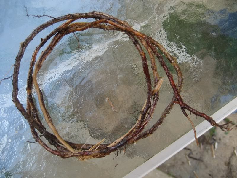

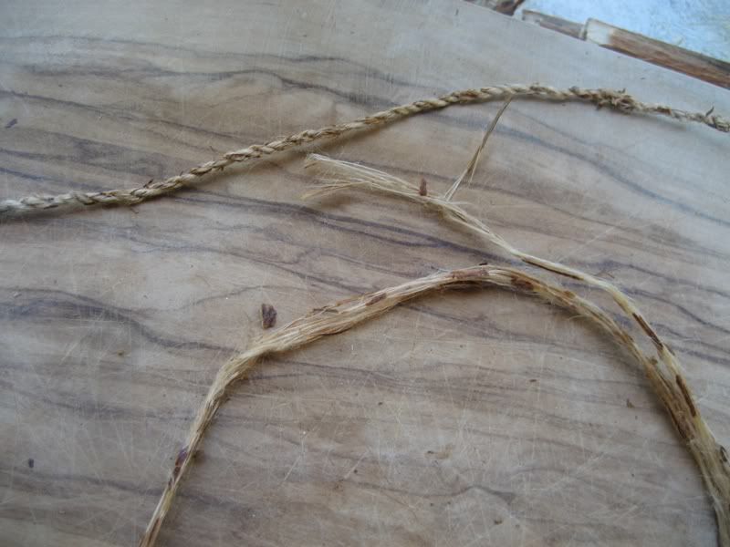

Here is a strand of her cordage next to a loose bunch of fibers.

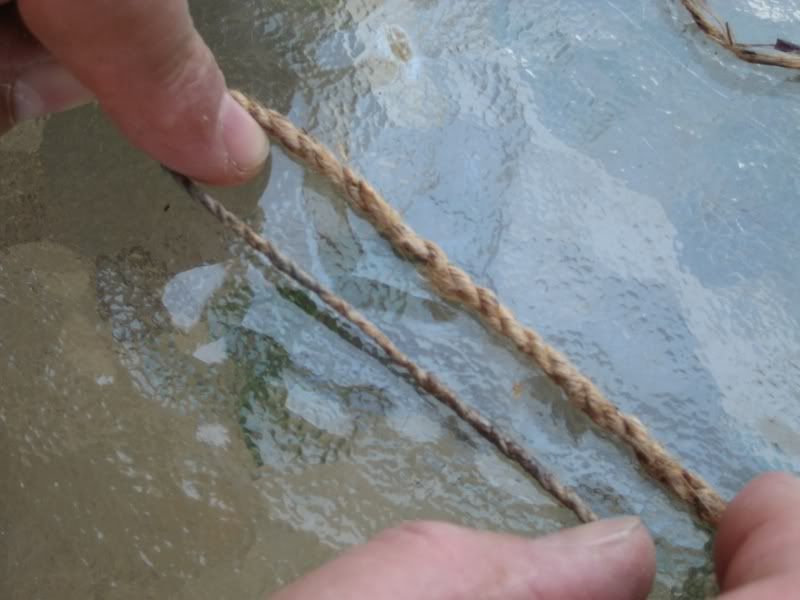

I made a thicker strand of cordage next to her thinner strand.

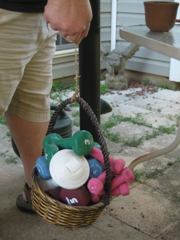

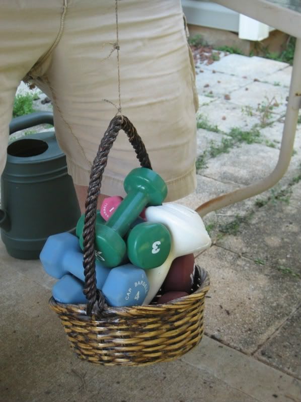

I loaded up a basket with all our hand weights, equaling 33.5 lbs. Both the thicker and the thinner strand held them with ease. To stress the thinner strand even more, I tied two pieces of thinner strand together with a square knot to give it a weaker stress point and it still held fine.

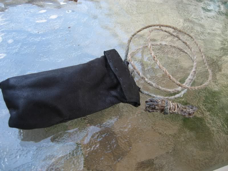

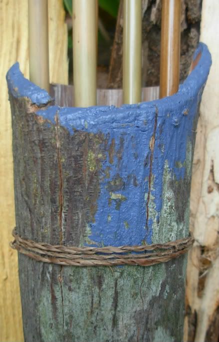

I've found dogbane cordage to be exceptionally tough and durable. Here is a small leather mojo back I've worn for over a year with the same piece of dogbane cordage. Still going strong.
