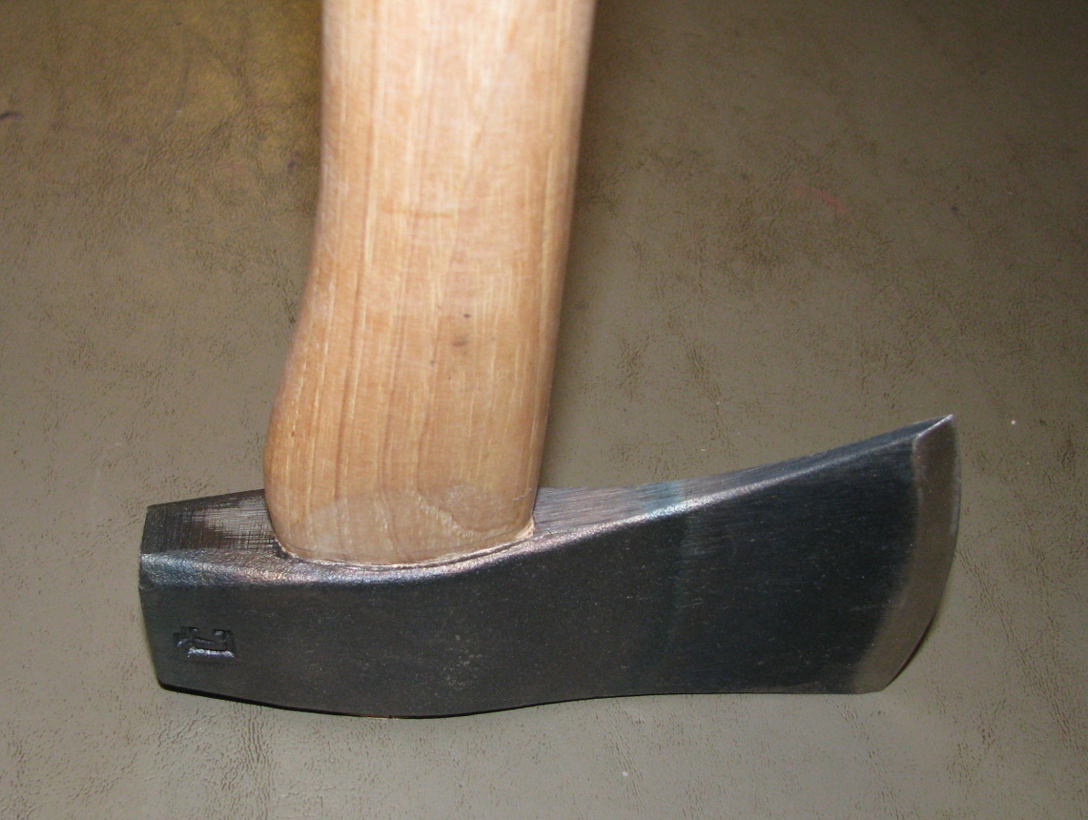

That's exactly why I used them, because they're hard. But I definitely should have pointed that out. if somebody was under the impression that they are as soft as a typical nail, it definitely would have given the wrong idea!
Thanks Josh! Coming from you that's high praise. It is a nice one, it really does feel great. I have a bunch of heads that I think the general shape and swell type will work wonderfully on if I scale it up.
I filed my flying fox yesterday. A moderately worn Simonds file woudn't cut it except with the less-used tip of the file. A new Simonds multi-cut file cut it very well. Based on that I'd estimate a hardness in the mid to low 50's HRC, maybe 52-54. I call that a good hard axe. I didn't file the poll.
I honed with Norton tradesman stones, black Arkansas and a razor hone. It shaved nicely.

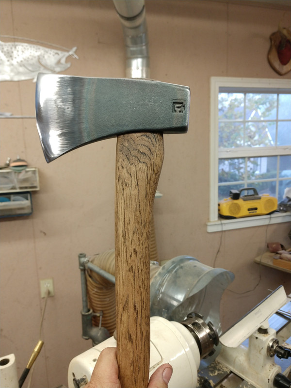

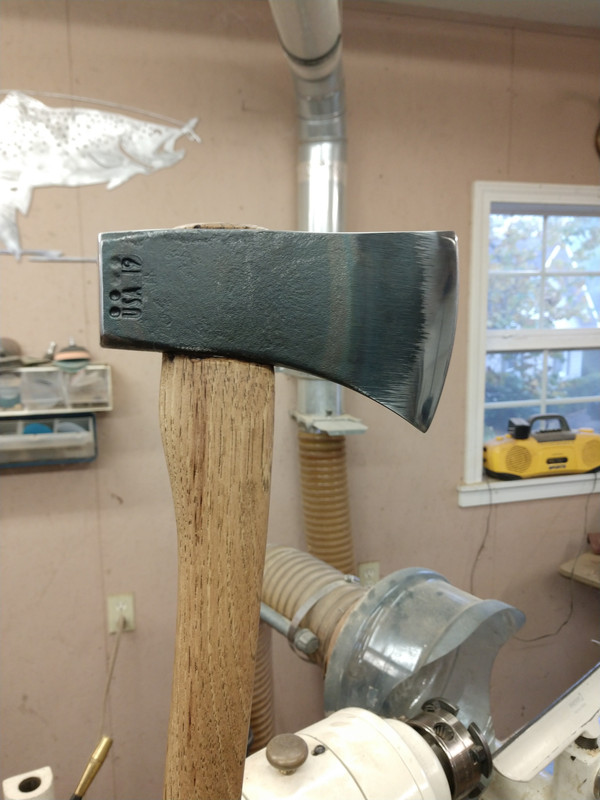

The temper colors appear to have been made by inserting a hot drift into the hardened axe and letting the colors run to the poll & bit. With the poll's small size and proximity to the eye the heat runs into it fast. This explains why the poll isn't quite as hard as we'd like it. Cooling the poll earlier in the tempering process could correct this.
I matched the hatchet with a Harry Epstein #3 axe sheath and gave it to a friend as a kindling hatchet to go with her new Yotul stove. My friend has been living off grid in Thurston Co. for 30 years.
I'd be very surprised if they did it that way. They heat the bit and poll using an induction heater and the colors are simply at the border of where the heating was done. I'm pretty sure they're batch-tempered.
Edit: yeah, I just was informed that they batch-temper them in an oven resembling a kiln. Definitely no hot drift involved.
Now that I look more closely the colors run the opposite of a hot drift temper. Straw is inside of purple and blue. That would indicate that the heat was applied at either end and not in the center.
Borrowed picture from Junkenstien.
So this tempering would have had less or no effect on the eye. One must assume that the eye was already soft and wasn't hardened in the quench.
I already said--they use an induction heater. It uses a magnetic coil that resonates the iron molecules to create localized heat through friction. It's the same technology used for hardening modern saw teeth, and responsible for that same rainbow coloration on them. I use a mini version of one to heat and bend scythe tangs so that heat doesn't migrate into the cutting portion of the blade. :)
You can see one example of such a device at 0:25 on this video. The ones used in factory settings are pretty large and use a coil optimized for the nature of the work being heated.
