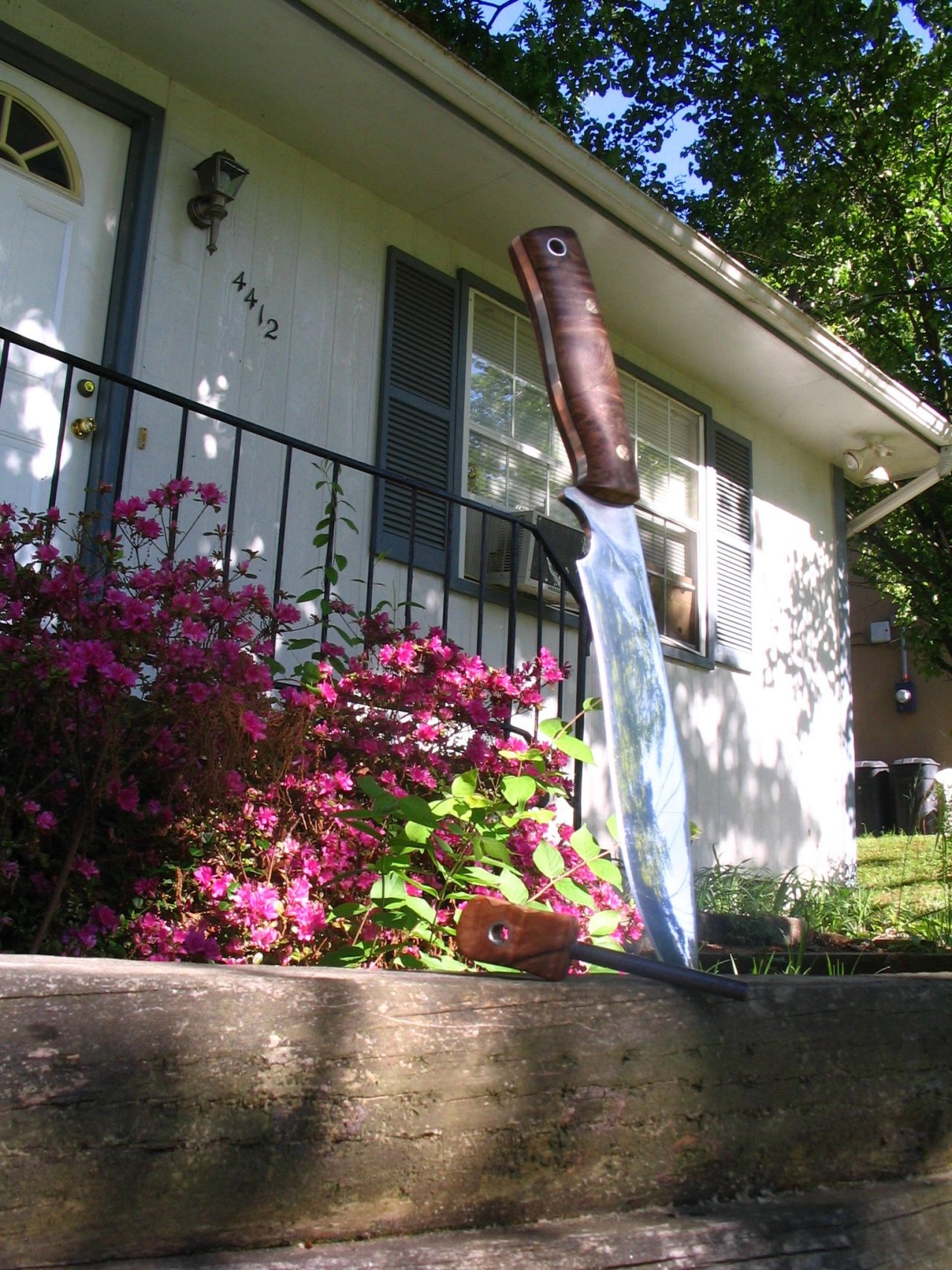

The Spyderco collaboration knives were indeed choppers and have gotten pretty high marks in reviews, even the 6" and 7-1/2" models. I make the same knives in 3V as well as CPM Stainless which are better. In all, the edge thickness before sharpening is about 0.040" which is then convexed about 1/8" up the blade. I've no clue what that angle might be since it's determined by both the angle at which the blade is held and the tension on the abrasive belt. On my knives I do this on a rotary platen which gives me more control of the shape of the curve, but the angle is still a mystery. Anecdotally , that edge which is what I wanted used on the Spyderco knives greatly troubled them because it's the antithesis of their normal edges, so they called it the "Hossom Edge" on the box as a sort of disclaimer. It's not my edge of course, it's used by most knifemakers, but it worked well for the duties assigned in the steel used and I found the label amusing. The steel most certainly would not have done as well for heavy chopping with very fine edge, nor would 3V for that matter. If the edge is too fine it will distort. That's why it's not used in professional cutting competitions. And I might add, that distortion which can occur in extremely fine edges with 3V and has happened with M4 as well when chopping hard materials is not correctable with sharpening. It's a significant distortion of the edge alignment.
Regardless, we agree that 3V is an excellent steel, but like all steels even it and M4 have an achilles heel that bears mentioning.

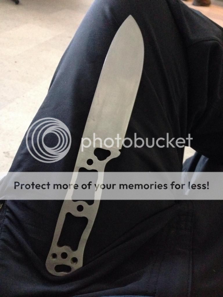

I just completed my first knife grind. It is in to Peters for heat treat. I was unsure of what steel but I figured for my first one use 3V. Because I was free grinding it and filing it already has a convex geometry (the entire blade). I left the edge roughly 1/16 thick for heat treating.
My intentions were to Convex the shit out of the edge.
If You don't mind do you have any suggestions for desired heat treat? I like edge retention. Also how much metal should I leave for heat treating.
Sorry for all the questions. You seem to know a little something.:eek:

For starters let me say I'm impressed with your efforts on this knife. You've kept the design clean and simple, and skeletonized the tang which will give it excellent balance. Since I have the advantage of using a belt grinder, it's easier for me to leave more steel before HT than if you're hand finishing the steel. I'd say you are about right with 1/16". Finishing the steel will take that down to about 0.040", and if you convex that for your edge you should be fine. I HT all my 3V blades to Rc61, even swords. It won't break and that hardness will give you good wear resistance. The quality of the finish you put on the edge will be the final touch in determining how well it will perform and if you get all 3V has to give. I refine my edges to 5 microns (~2000 grit), then polish on a completely worn out belt with white compound before stropping on top grain leather. 3V has a very tenacious wire edge so you need to strop it more aggressively than with most steels to get rid of it. I often find myself wondering if I screwed up the sharpening because it's just not sharp, then strop it a little more, a little harder and pop!! There it is! It always makes me smile when I see how that edge chases hair off your arm. There is just nothing quite like it. Good luck!
I agree, that's a well-designed general-purpose blade. :thumbup: It will certainly be sturdy.
Peters' does a fantastic job of keeping 3V clean and straight during HT. I routinely send them 3V (and other blades) that are ground right down to final dimension and hand-finished as high as 2000 grit. When I get them back all I have to do is sand off the tempering oxides and sharpen them.
For absolute maximum toughness, 58Rc is the way to go. But even at higher hardness as Mr. Hossom mentioned, 3V is still really tough. For a medium size knife like that I would ask them to temper it to 61-62Rc and take full advantage of the edge-holding.

Incidentally, some folks have posted in the past that "You just can't get a nice finish on CPM-3V". I disagree...
That's not buffed, just hand-sanded. The trick isn't how to finish it, but when. ;)

gsx, that hole just behind the blade shouldn't be there ! It creates a weak point and does very little as far as balance or lightness of the blade.
I thought the exact same thing... i don't put any holes near the ricasso area for that reason. your weight savings mean more closer to the rear as far as balance goes and why weaken a high stress area just to save a couple grams. Great thread though... thanks James and Jerry for your imput on HT and toughness as this was something i was wondering about as well. My 3v adventures are only beginning and your imput is greatly appreciated.
I am totally not arguing but here was my thought. I have had knifes break at the begining of the blade grind but not the handle. The total area of the metal behind the last cutout behind the blade is basically 1/2 by 3/16 which is more area or metal then the blade it self. I left that material for being able to batton. On a unground blade i did a flex test and that area did not flex.
However I was waiting for that comment as I had some of the same thoughts in my head. I will do some serious testing and put it to a challenge.
I have done some pretty extreme things in fabricating motorcycle turbo systems which were so far stood the test of time but at the time were untested. I have seen some of these thing now implemented in mainstream systems. That said this was my first knife so I appreciate all the insight and suggestions and will make any changes needed going foward.
But based on the pressure I was exerting I feel comfortable so far. It is over 3/16 afterall. Sorry unground 3/16 CPM3V which is closer to 1/4.
Again thanks. I hate writting cause the interpretation can change.

Talked to Peters this morning. 61 it is.
