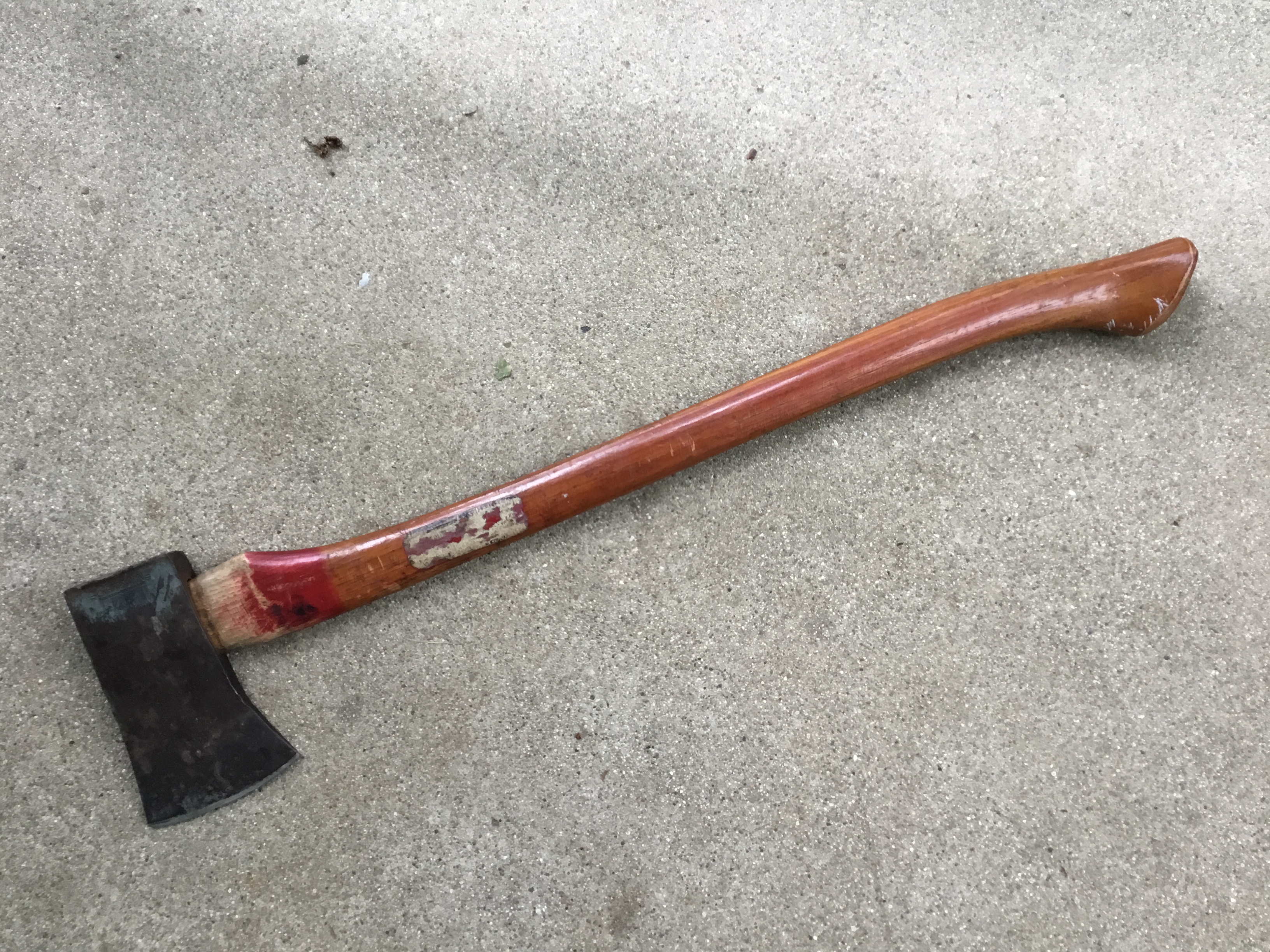

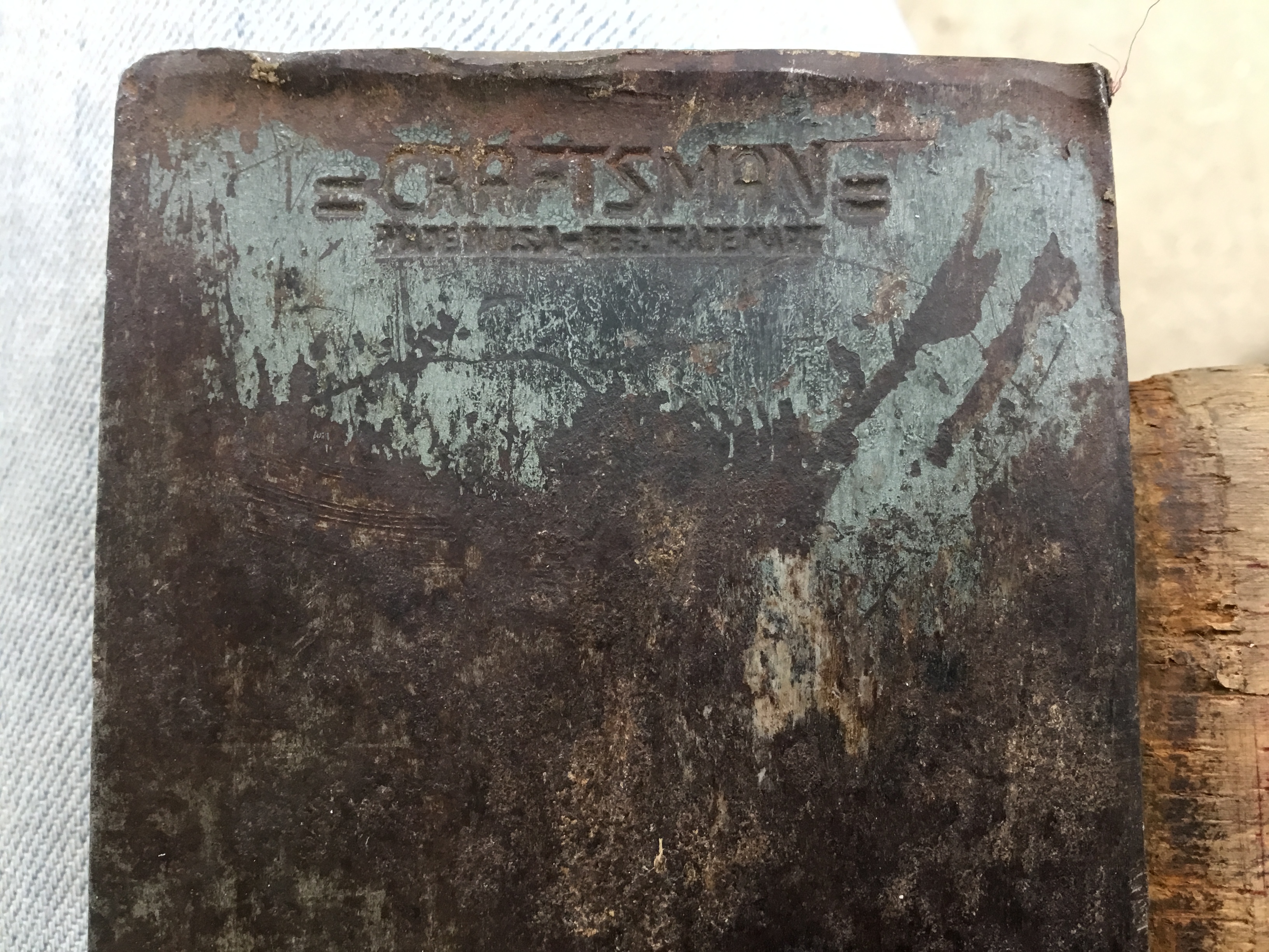

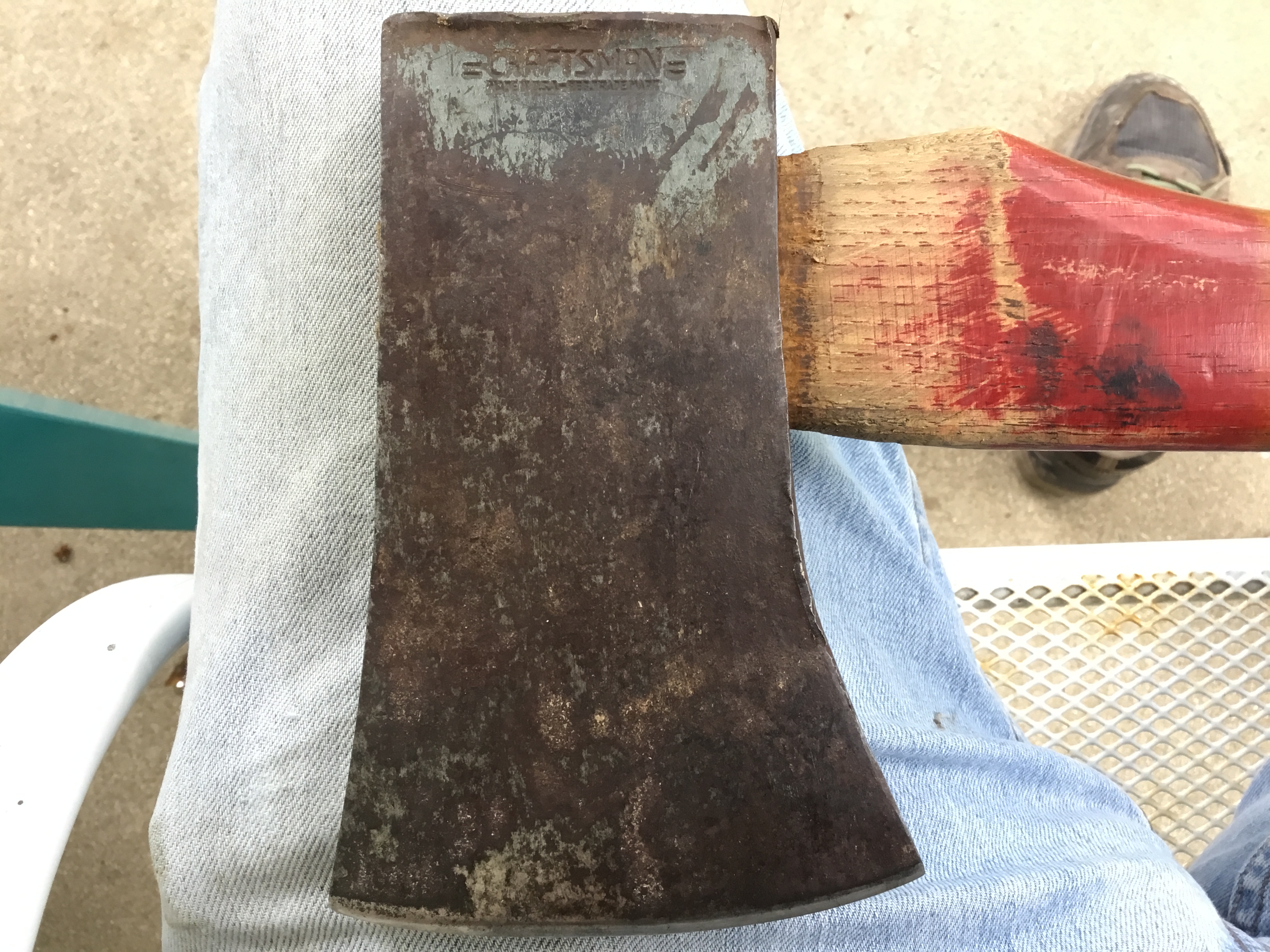

Rookie here could use some help trying to identify the stamp on this Craftsman axe. I went through this entire thread and a couple of others but have not found any info.I posted this in another thread a while back not knowing that this one existed. Received some helpful comments and compliments but at that time no one could identify what the " F's " below the bars signified on each side of the stamp. Was hoping someone could at this time shed some light on that and possibly help date the axe as well.Took some extra pictures with the thought that the profiles might give an indication as to the manufacture. Pick this one up off the bay sometime back for $35 delivered. The head is solid on the haft and appears to have seen little use. Also appears to be properly hung with a nice haft. Won't see a whole lot of use from me since it's really too big for me to swing for any length of time. Got a bad case of old age!!!! Just One of those things I had to have. Would greatly appreciate any of y'alls insights into it. Thanks in advance. I hope to be able to contribute to some of the threads here in the near future as I begin my new hobby. IMG_5030.JPG IMG_5028.JPG IMG_5025.JPG IMG_5029.JPG IMG_5026.JPG

Thanks. I figured from some reading the 3.5# head, but couldn’t find any info on the F1 or specific stamped Craftsman logo. I’m not too sure if it’s a collectible axe or not, but I really like it. Considering it cost $10, I don’t think I did too bad. I’ll have to look into the Vaughan manufacturing aspect. Thanks again!
It's probably from the 50's or 60's because of the convex cheeks. Later they went to flat cheeks (which suck because they're sticky). If the bits aren't terribly worn you have a very good user axe.

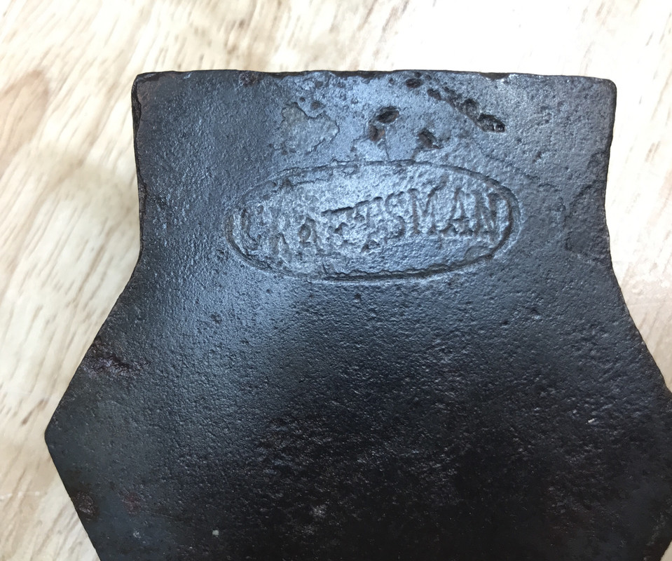

Basically a barn-find: 3lb 7oz Craftsman double bit head with "sideways barn" C and no lines. 4.5" cutting edges. Michigan pattern?
Is this likely from the 70s/80s, or earlier than that? Thanks!
From the bevels in the cheeks I'd guess it's earlier, 50's-60's.
