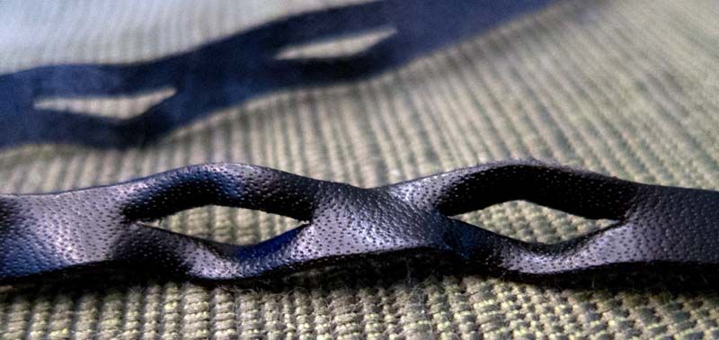

Now it arrives with this, to me, not so well done leather braided fob, a couple things wrong with this,
slits start too far from the hole
slits are too long
slits are too far apart
they could do a lot better but then it would take a little longer to braid it too, almost better to save the time and money and leave it off, IMHO

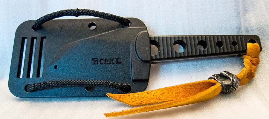

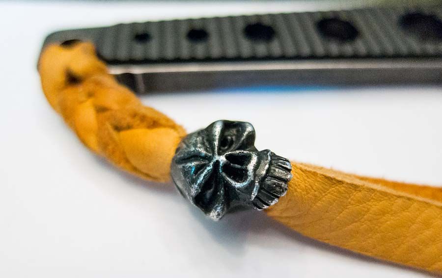

I replaced that braided leather with one of my own, added a skull on there and that allows me to hook my pinky around the skull and provides a grip to draw the knife from the sheath. I removed the stuff that was on the sheath as I don't have a pack I'll be attaching it to at any time soon. But laced some para cord around to make mock belt loops so I can thread my belt through there, works well so far. Easy to slide your finger out near that sharp tip to help guide the blade back into the sheath. You could also make it to ride horizontal, but I'm not overly confident of the retention so vertical seems safest right now.

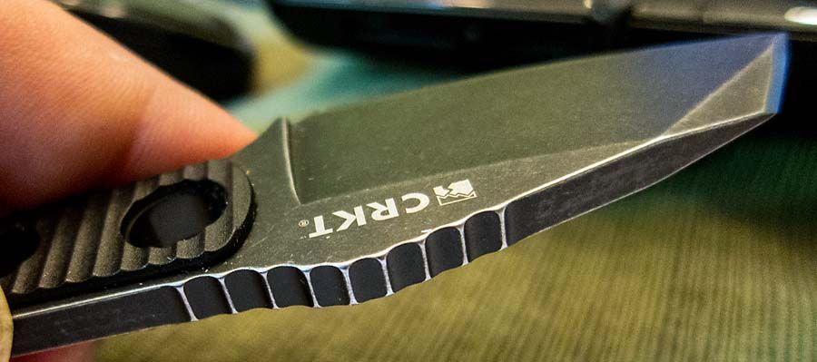

The tip of the blade has a fairly sharp edge that will cut you if you are not careful, on as short a blade as this is, I might end up softening that edge...
NoBother-3.jpg~original
The handle has some nice grip to it, slight jimping on the end, also helps indicate edge side of the knife and the jimping on the spine seems good too, fairly thick blade but the grind comes down cleanly without having an abrupt shoulder of a bevel to contend with, it push cuts down through a Q-Tip shaft easily, some knives balk at that simple task, if you go at an angle most will cut through, but perpendicular it requires good geometry in order to push cut through. The edge arrived pretty sharp already, nice surprise!

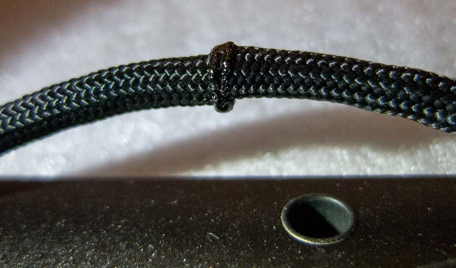

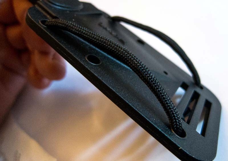

Looking at the paracord setup again, didn't care for the knot in the front, so I opted to try and 'glue' the ends together, so on the back side now I cut the ends so there was a little room for play, then carefully brought a bic candle lighter flame up between the two ends, once they were liquid, I quickly pushed the two ends together, keeping my skin out of the way! It would have been handier to have had another person hold the flame but it still worked. You end up with one continuous strand now, of course I'd not HANG from that bond, but for the purpose of holding this small knife on my belt, I think it will do fine ;)
IMG_0488.jpg~original
IMG_0490.jpg~original
The joint
