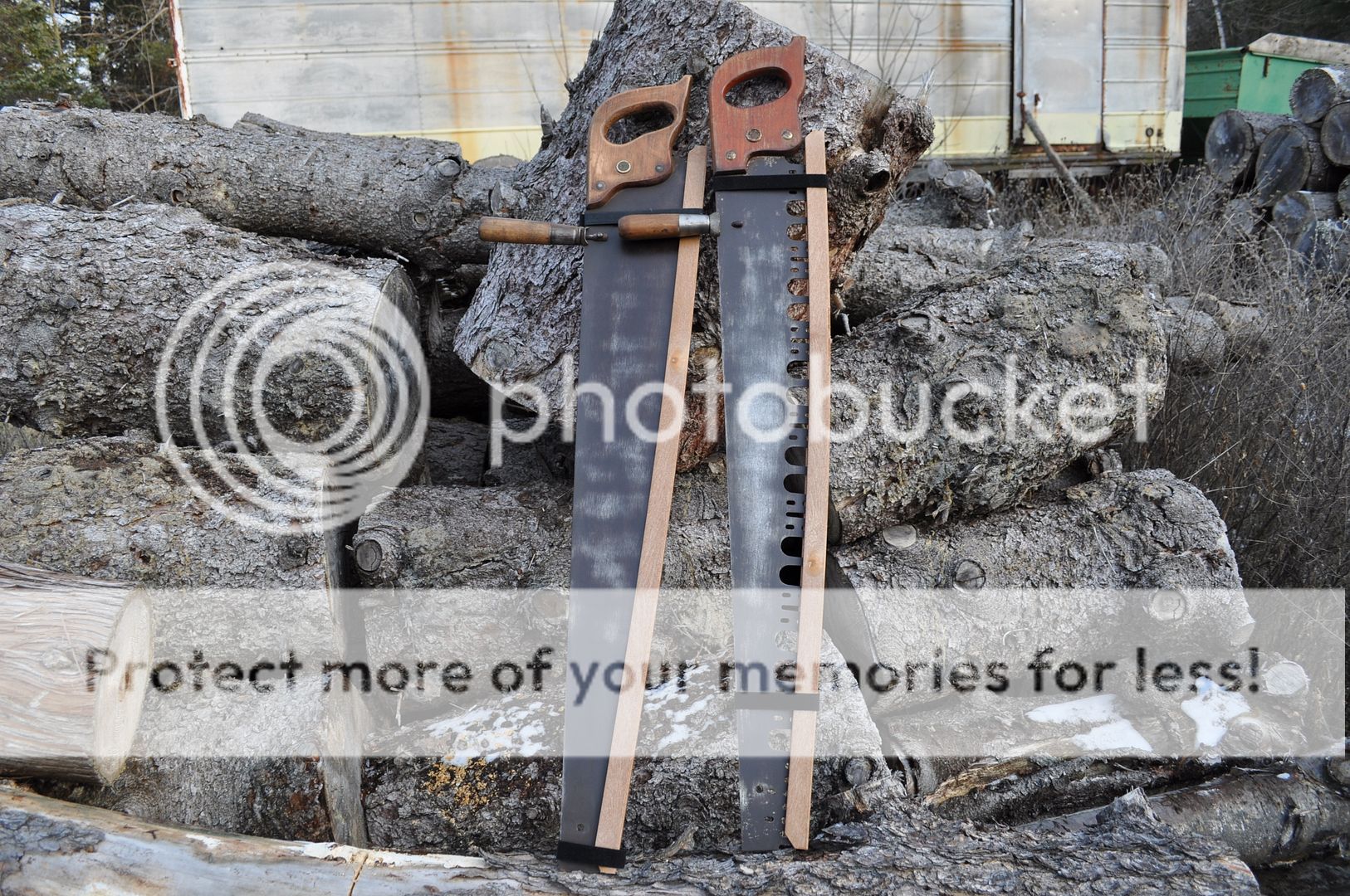

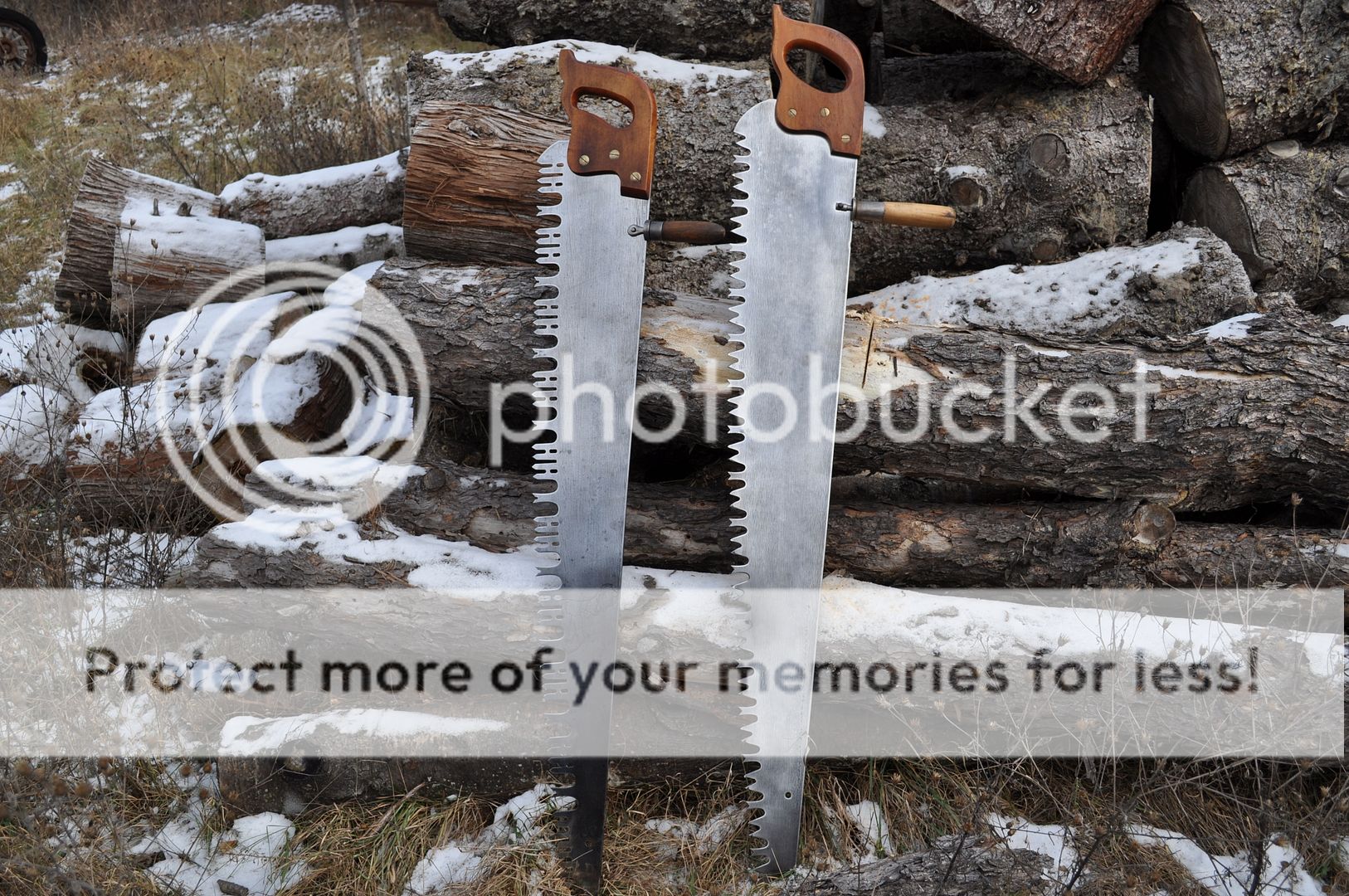

Some of my users.
On the left: Henry Disston & Sons Perforated No. 514 Spring Steel It is a flat ground blade with a perforated lance tooth design, 3.5' long, overall 4 ft., wt. 4 lbs. 12 oz.
On the right: Disston Keystone K 954 Champion It is a flat ground blade with a champion (tuttle) tooth design, 3.5 long, overall 4 ft., wt. 5 lb. 2 oz.
The etching is visible on both these saws, it just doesn't show up in the picture.
The perforated lance tooth saw is a Powr-Kraft. A Montgomery Wards brand name. I'm not sure who made the saw for them. The other one is a champion tooth design. I'm not sure of the maker, but I think it's a Sears saw.
The guards are a fence topping, got them from Lowe's. They have velcro straps to hold them on.

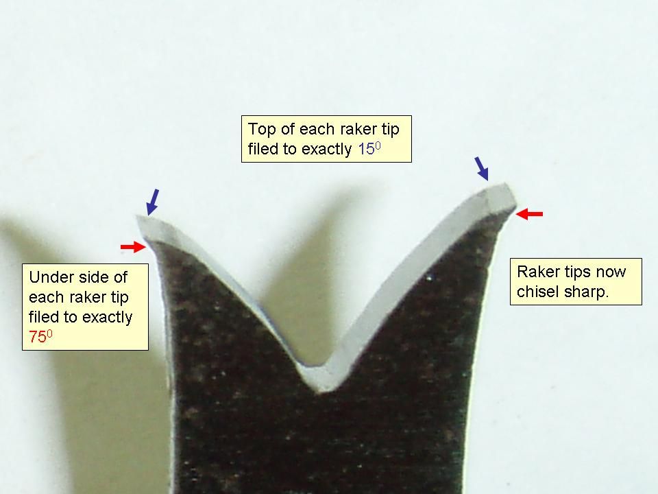

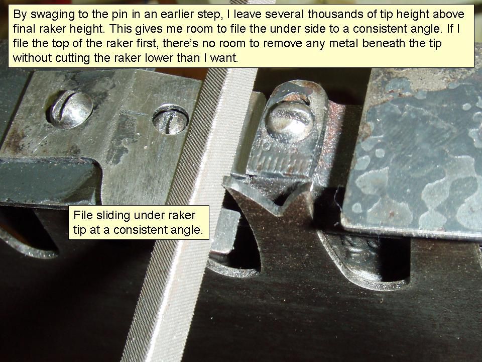

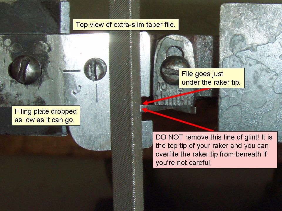

I pay special attention to the rakers when filing a saw and will double-bevel them for consistency and edge holding properties. Putting a slight secondary bevel on the underside of a raker guarantees a good chisel edge that is knife sharp. (See Leonard Lee's guide to filing chisels and plane irons).
Using an Anderson gauge for this one:
One mistake filers make when doing rakers is to not position the shoes atop the two nearest cutter teeth.
This 15 degree underside angle is just a sliver of the swage

I don't think Anderson had underfiling in mind for their gauge -- that's just how I finish the under side of my rakers. Their filing plate is wider than most others and it's easier to keep a slim taper file flat against it.
