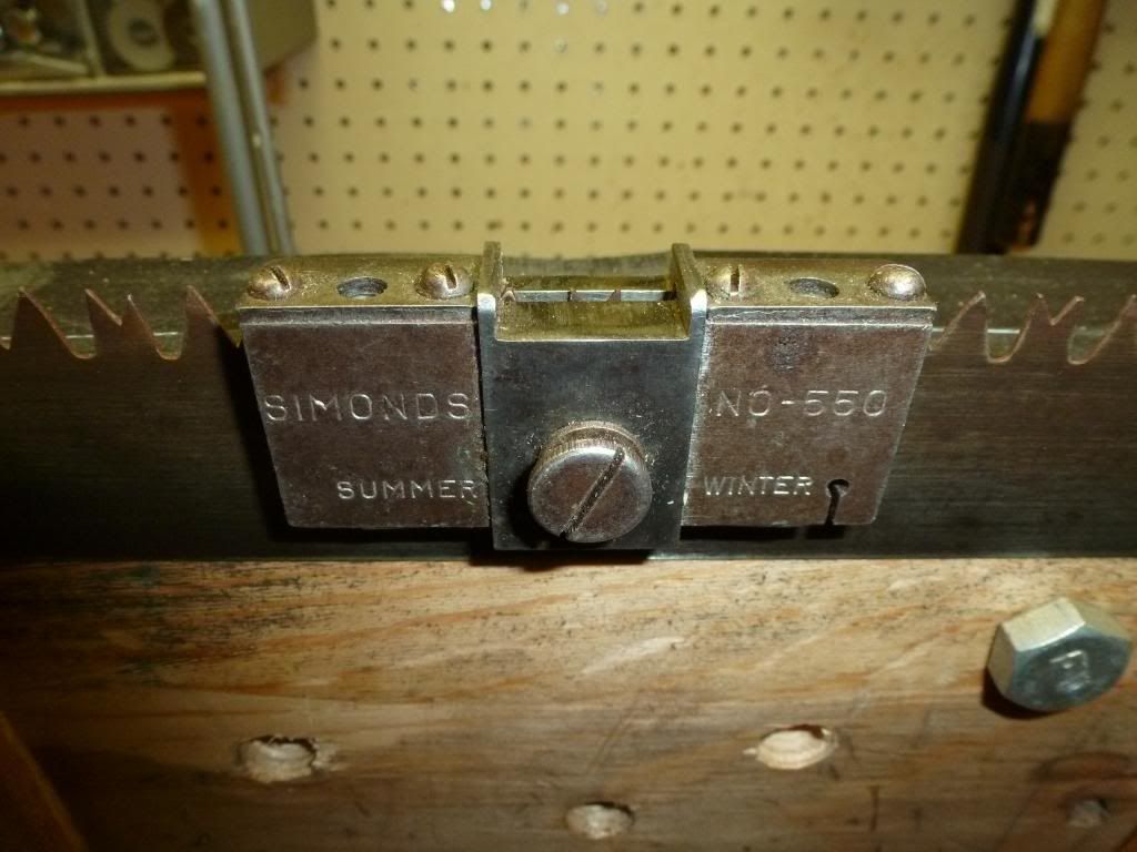

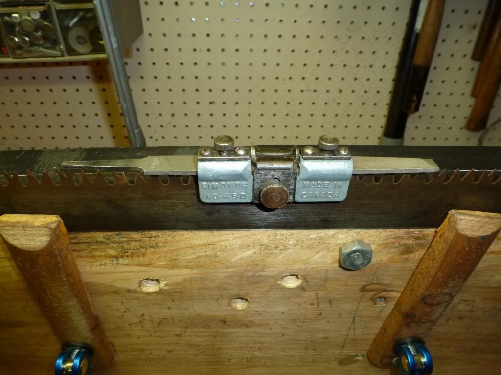

The two smaller gauges work well with small one man saws. They sell for cheap on Ebay because most new filers want to buy the big ones shown in books. They may not fit right if you've already put set in the teeth though. Raker filing is done before tooth setting.
Here are three gauges for comparison including an Anderson gauge for big saws:
Both smaller ones can be used as jointers and raker gauges, but the Simonds #550 has a better filing plate:
I have not seen that type before. The kind I thought would work for me had the raker gage file height adjusted by a wedge shaped piece of metal on each side of the tool. I can see for sure that little Simons is what I need.

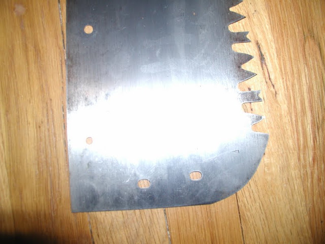

I picked up another one of the same size a few days ago. Its a no name with pererated lance teeth. I am going to soak it in vinegar to remove some rust.
For trail work or something, yes 36" is very small. I filed several 36" saws for a fella last year, and could hardly let go of them though. one in particular was a little perforated lance tooth, thin stock but real stiff and cut so beautiful. They are great for cutting firewood and stuff, which is what I use mine for mainly. Along with felling. and bucking. well, I guess thats quite a bit comparatively speaking (don't own a chainsaw, just 50 axes and about 20 saws).
