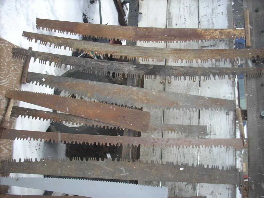

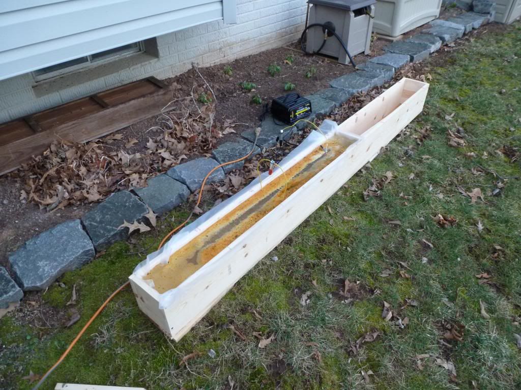

Built one this weekend and ran four saws through it. Worked while I slept and removed all rust. Appears to be a great way to clean a saw.
If you build a removable partition in the tank, you can adjust it for the size of your saws. I did 4-footers in this one:

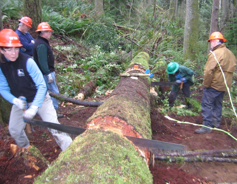

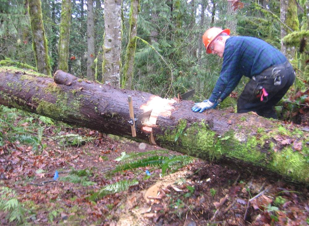

We did a bunch of crosscut work out on the trails today. We had a master sawyer instructing us in some of the finer points of clearing trails. Here we're cutting an elevated cedar. We're going to use this wood for some trail structures later so we didn't want this cut to slab as we were finishing the cut. We've underbucked a v-groove in the botton of the log. We're just getting ready to wedge the top cut so it doesn't pinch the saw.

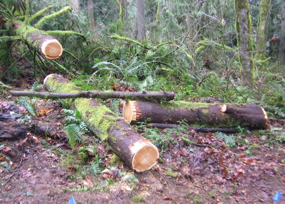

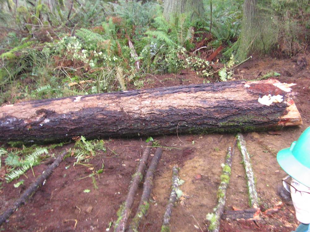

Here are 8' and 10' cedar sections we've cut. These will be used to create turnpikes and to block access to motorized vehicles.
Here's a 12' section another crew has cut.

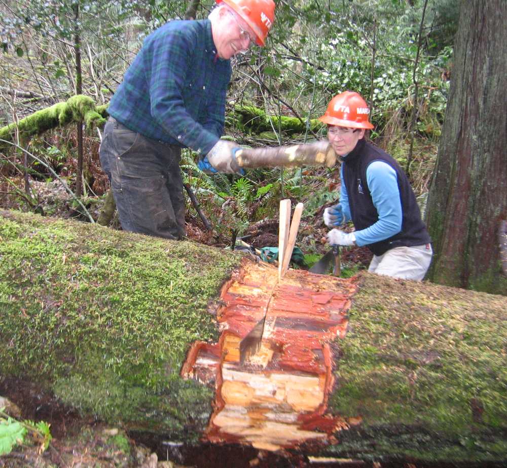

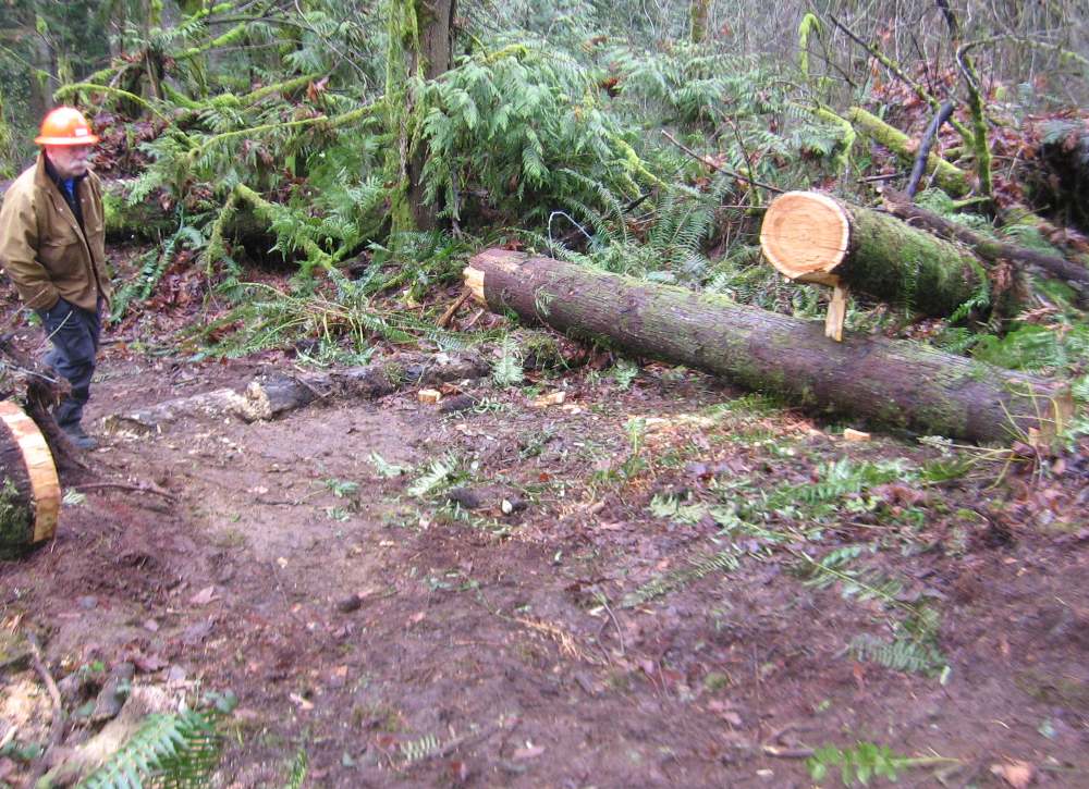

Two sawyers making cuts at opposing angles to create a 'roll-away' cut. If this piece rolls to the left it will lodge against a tree and block the trail. The angle cuts will only let it roll to the right.
Goin' old school! Striking wooden wedges with a trail-made 'bonker' made out of holly - a very tough heavy wood.
The 12' section of 24" Doug Fir rolled cleanly away.

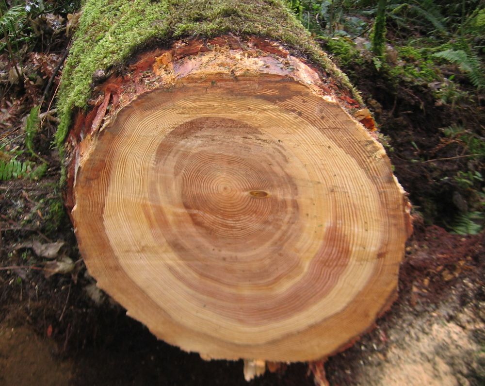

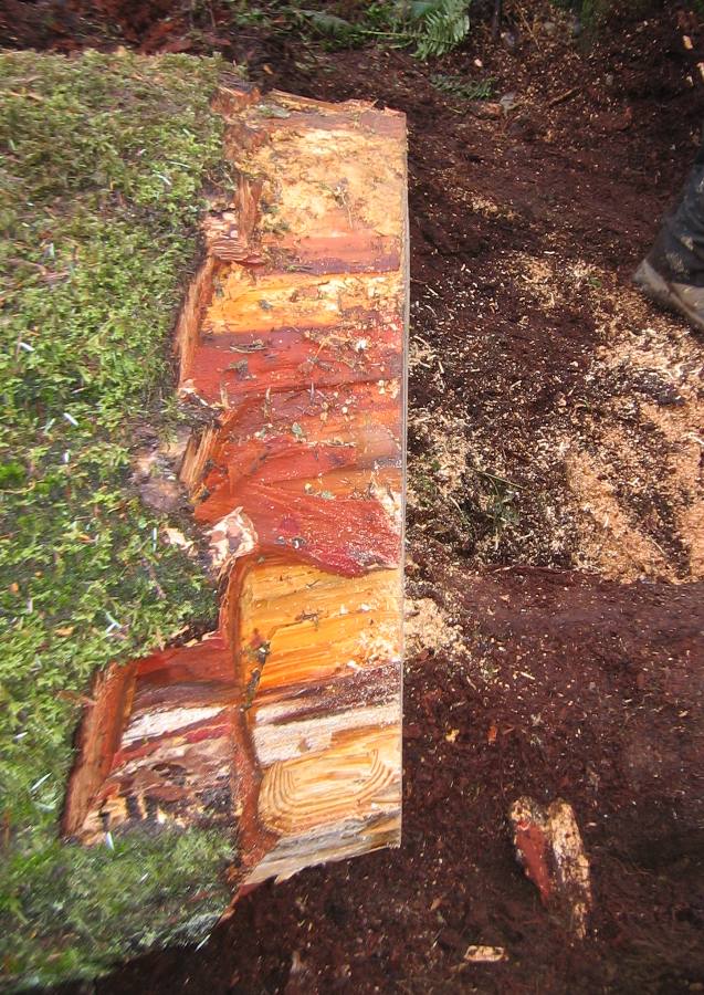

I never did count the rings in this tree. I'd estimate it to be about 100 years old.
A testament to a well-tuned saw. This cut is flat as a pancake.

The woman sawyer looks to be using a felling saw (513?). You can wedge in sooner on those. Nice work!
The two sawyers in the 4th photo are both women and both good strong trail hands, too. And those are both bucking saws but one has had the back bellied out to receive wedges. Good eye!
