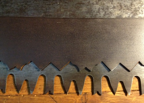

Great photo, Ernest. Yeah, I guess with no radius and no rakers a skilled filer could do the job.
In fact the doctor was at the moment of the photo demonstrating the principle of the racker tooth by scratching across his support beam with his saw file the tracks severing the fibers to be cleared away by the racker. The tooth pattern he is using is one he claims to have developed which cuts on push and pull strokes both for rip cuts and cross cut, called the "Devils Tooth". The demonstration was geared towards woodworking, or carpentry and furniture making where a radius on a saw is not usually used though there were some tree cutters there with saws he said he could do little with because of the poor quality.
Here is a closer view of the tooth pattern on a smaller saw. You can make out the rakers on either side of the deep gullets.
E.DB.
That would be very handy. In Japanese tradition this saw looks to be built to cut on the pull more than the push. The slant in the teeth look like a pull saw. And there is only a push raker on every other set of teeth.
This smaller saw has 5 teeth per set. The earlier one had 3 teeth per set. I can't tell for certain but in the earlier photo it looks like the rakers are only designed to cut on the pull stroke.

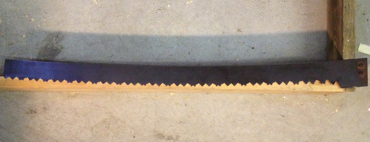

Not exactly sure what this is. Got it for pocket change at an estate sale. 2½ in. wide, 3½ ft. long with an unfamiliar tooth style.
Champion tooth with the rakers filed down to the nub. That saw's seen some use.

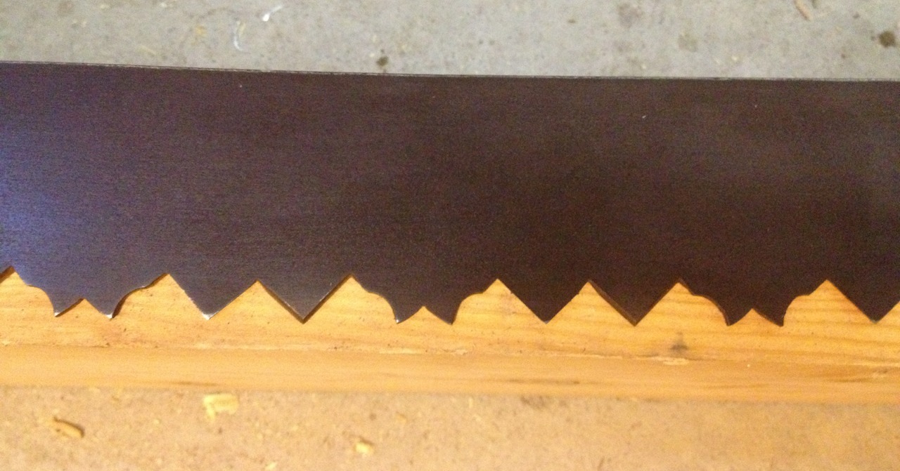

That's the thing though, the rakers seem to be in fine shape. I know it's a champion tooth, I meant if it was a crosscut or some sort of one-man felling saw. Since i've never seen a one-man crosscut that slim before (2.5" wide) It almost looks like it could have been a 2-man felling saw that was cut in half or something. The tooth pattern is wider, shorter and a lot more spaced out than a usual champion tooth and the gullets are pointed instead of round. Wasn't sure if it was a normal crosscut or if it was designed for some specific use.
Same length as a one-man crosscut, but much slimmer with a fatter tooth design. Seemed unusual to me. Are you sure the rakers are filed down? I think they're supposed to look like that. Then again, you could be right, it's possible that it's just been used and filed so much that it completely transformed the tooth pattern altogether. But after looking at it closely, it appears to be in ok condition and judging by the teeth, the rakers seem to be made like that, pointed instead of swaged at the end. But I couldn't say for sure.
I'd just say it's a ribbon saw, champion or tuttle tooth, that had broke in half or been cut, and which has seen a particular lot of *filing* over it's life.
Is the suggestion here that the shape of the teeth is the result of improper filing? I see definite intension behind the configuration and form with the racker teeth not being peened but under-cut with a round file. Whether or not it is standard or effective I couldn't say.
This is right. Those curves beside the rakers are the former gullets of the saw.
The right side of the saw, with handle holes and loop handle notch, shows the original width of the felling saw. That saw has seen an extreme amount of filing. However, if the filer had lowered the original gullet depths relative to the lowered teeth and rakers, there wouldn't be much back to the saw at all. That saw has reached the end of its useful life and is ready for resurrection as knife steel.
Yep, makes sense. In that case, it HAS seen a lot of use. Time to scrap this one and use it for knife steel...
