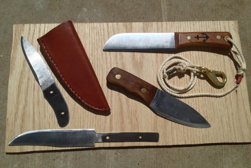

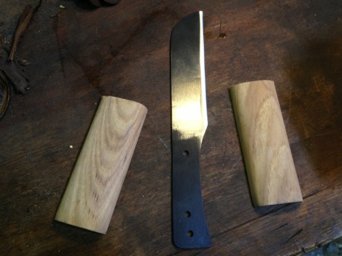

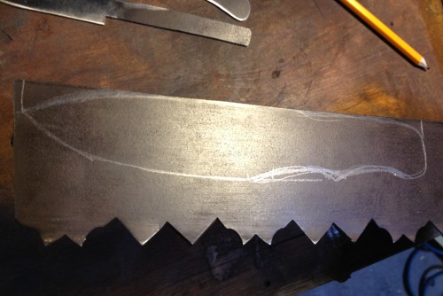

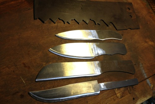

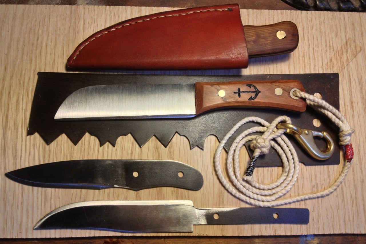

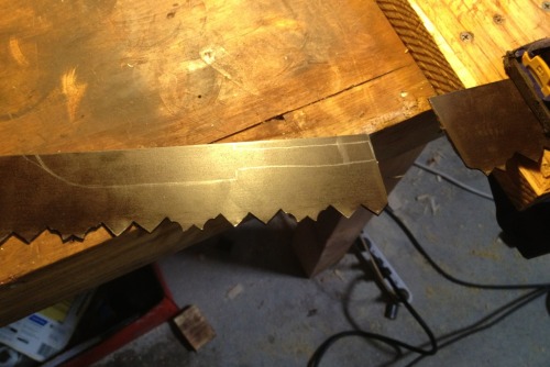

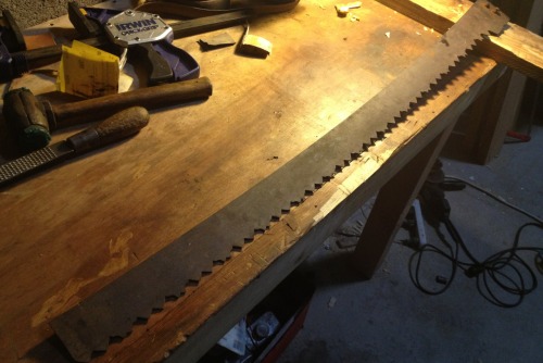

Here's what became of that weird old chunk of saw...

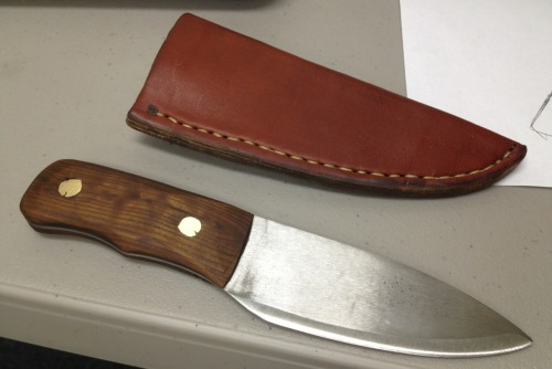

Whatever kind of steel it was, it was good. I had to have a machinist guy I know drill the handle holes, using an industrial mill and he still had some trouble getting through it.

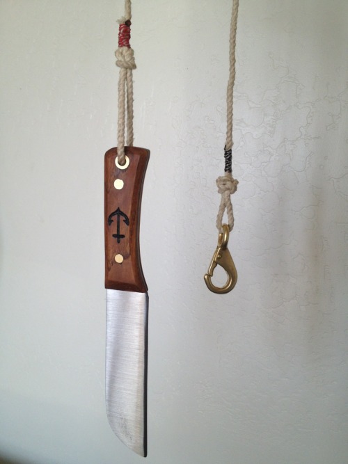

Carved the handle for this one out of a Black Olive branch. Made the sheath from a scrap of Latigo

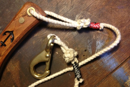

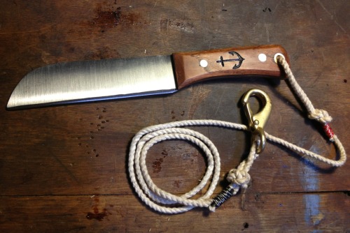

Used a scrap of hickory from a broken axe haft for the handle on the rigging knife
Knotted and whipped
Done for now. I'll finish the others and make a sheath for the rigging knife another time.

Very nice. Saw steel is famously difficult to drill. I usually end up chucking a chainsaw stone in my Dremel tool and grinding out a depression that I will then hammer a hardened nail through to open up a hole big enough to get a small chainsaw file into and take it from there.
Dang, dude! You been busy. Nice work on those knives.
I've had success drilling saw blades at slow speed with cobalt bits. Start small and step up to larger bits. Use cutting fluid. Keep the drill under 1000 rpms - around 600 rpms it good.
That is good information. I have a few old carbon steel kitchen knives that could use new scales and modern knife rivets are much larger diameter than the old ones. Besides premium drill bits has anyone tried a Dremel tool carbide cutter?
Slow and steady definitely wins the race on this track. :)
I've got a bench-top drill press and I'm either going to mod the pulleys for lower speed or find a variac with a power rating high enough. Could also use a pulse-width modulation motor controller. One thing to remember when slowing down electric motors for low speed work: make sure it's in the lowest "gear" already. They get sizzling hot if you try to pull too much current at low RPM. :eek:
Great looking blades, Warner!
-Thanks 300. Great story and information. :thumbup:
-Thanks trailtime. Yeah, i'll say. Thanks for the info, i'll have to give that a try next time.
-Thanks Peg! Yeah, he used cobalt and carbide end mills to finally get through it. Thanks for the info, i'll remember that for next time.
-Thanks Skiv! Good info on the drill press mod.

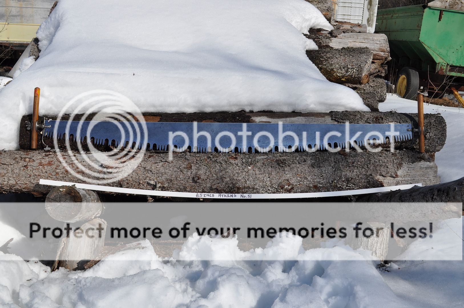

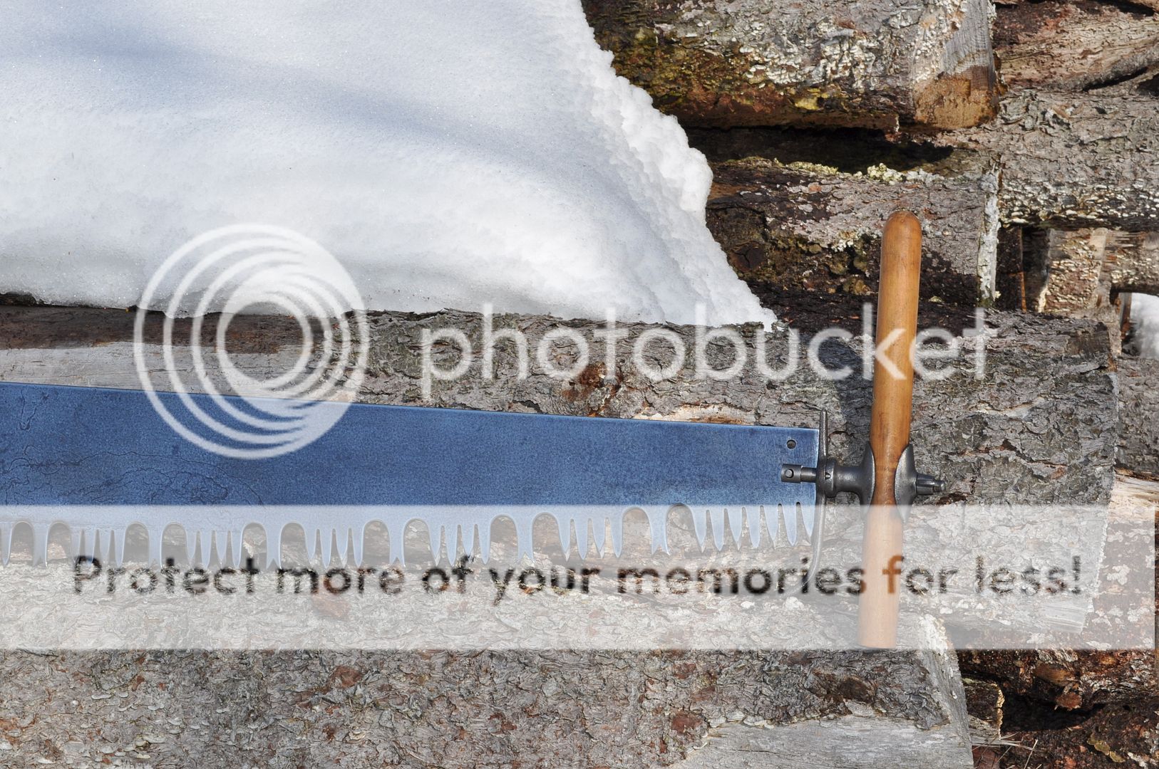

From my small collection of crosscut saws. Both of these saws are precision crescent ground blades. They are considered by many to be the Holy Grail of two man saws for the collector and user alike.
Simonds Royal Chinock No. 503, 78" Lance tooth design
[URL="
Correct Simonds No. 503 western handle
[URL="

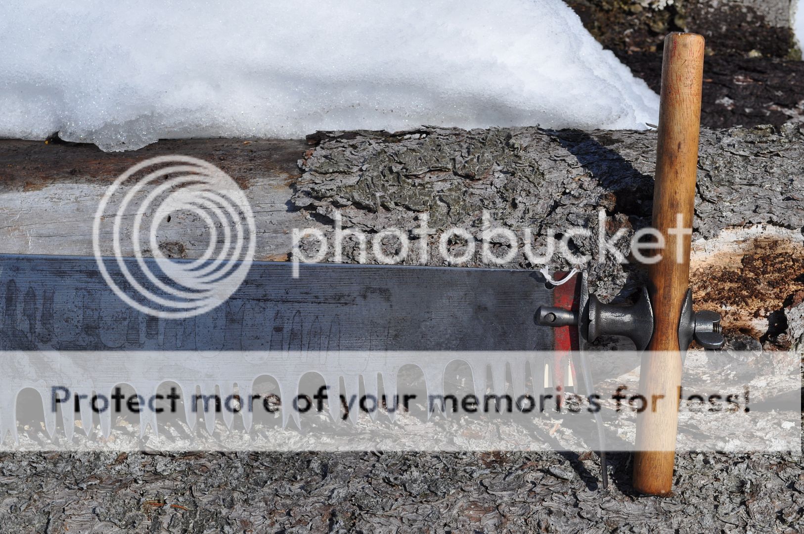

Atkins No. 51, 85" Lance tooth design
[URL="
Correct Atkins No. 51 western handle
[URL="
The plastic strips below the saws are fencing edging (from Lowes). I use them as saw guards. They come in 8' lengths, just cut them to size. I use Velcro straps to hold them on.
Tom
Tom

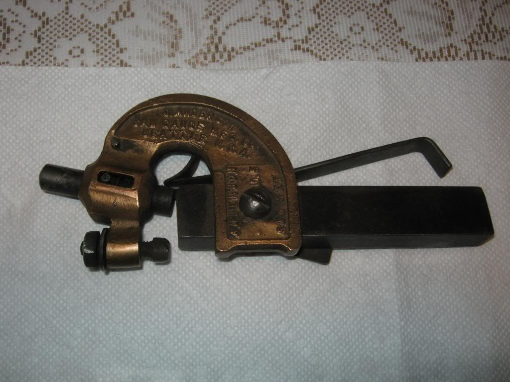

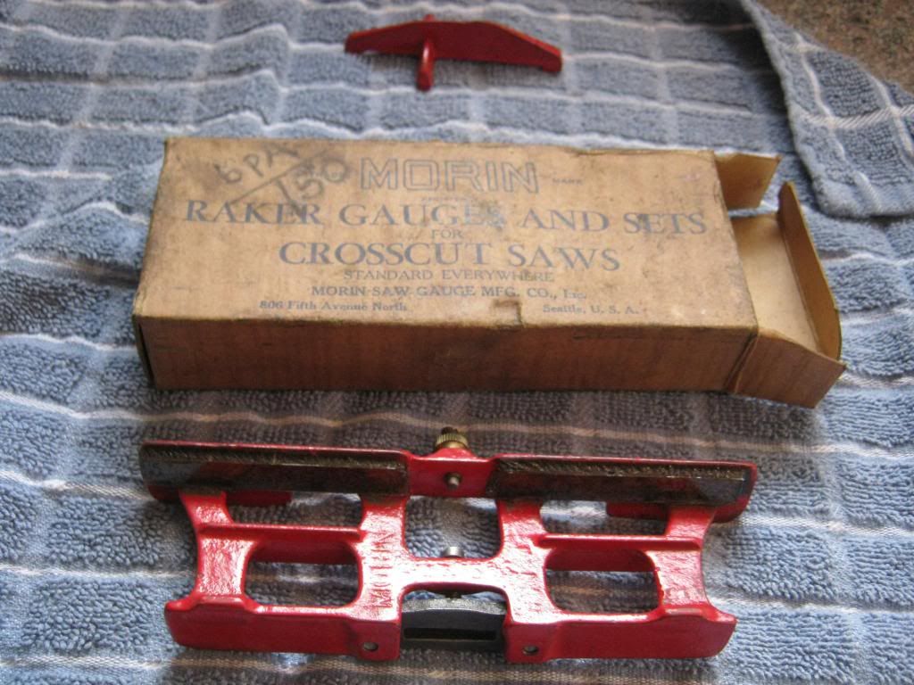

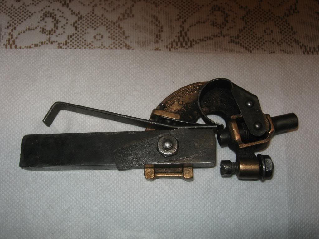

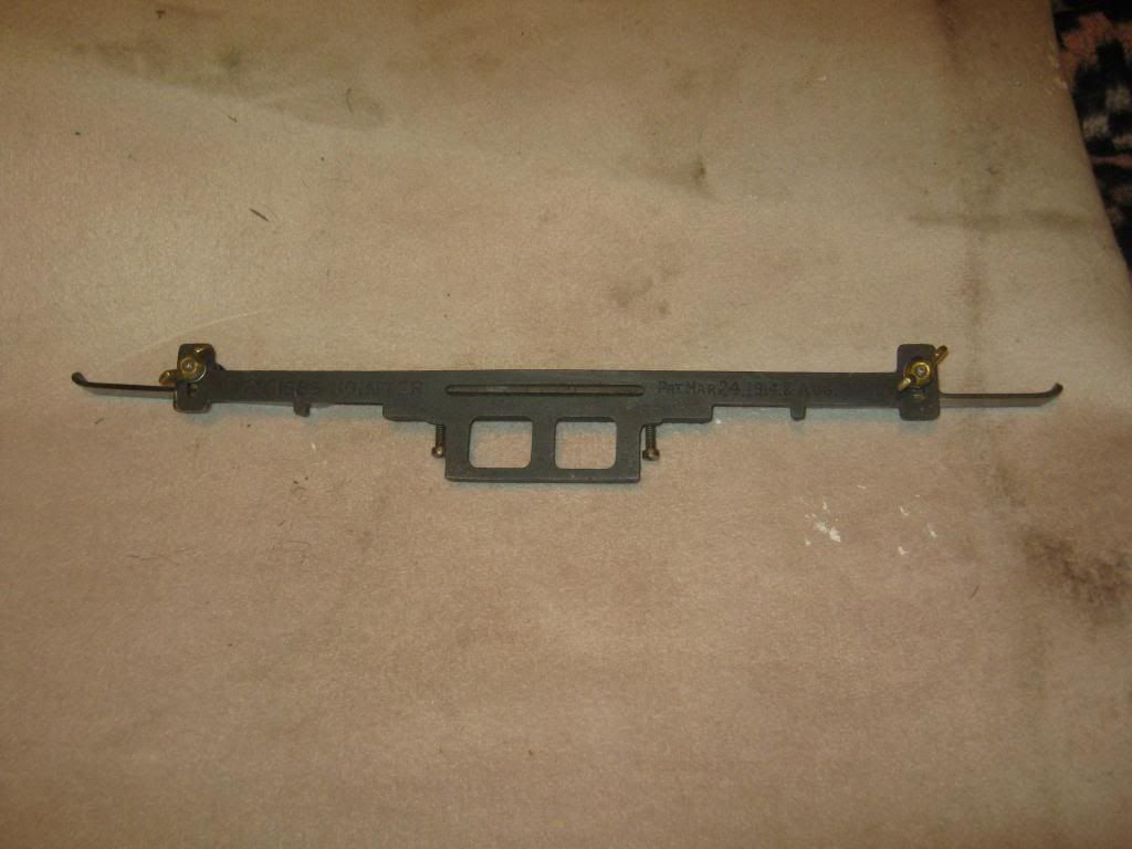

I'm a big fan of the Anderson raker gauge, it's the only one I ever use. Not as Grail-like as a Martin Winters gauge, but a close second for a mass-produced tool.
