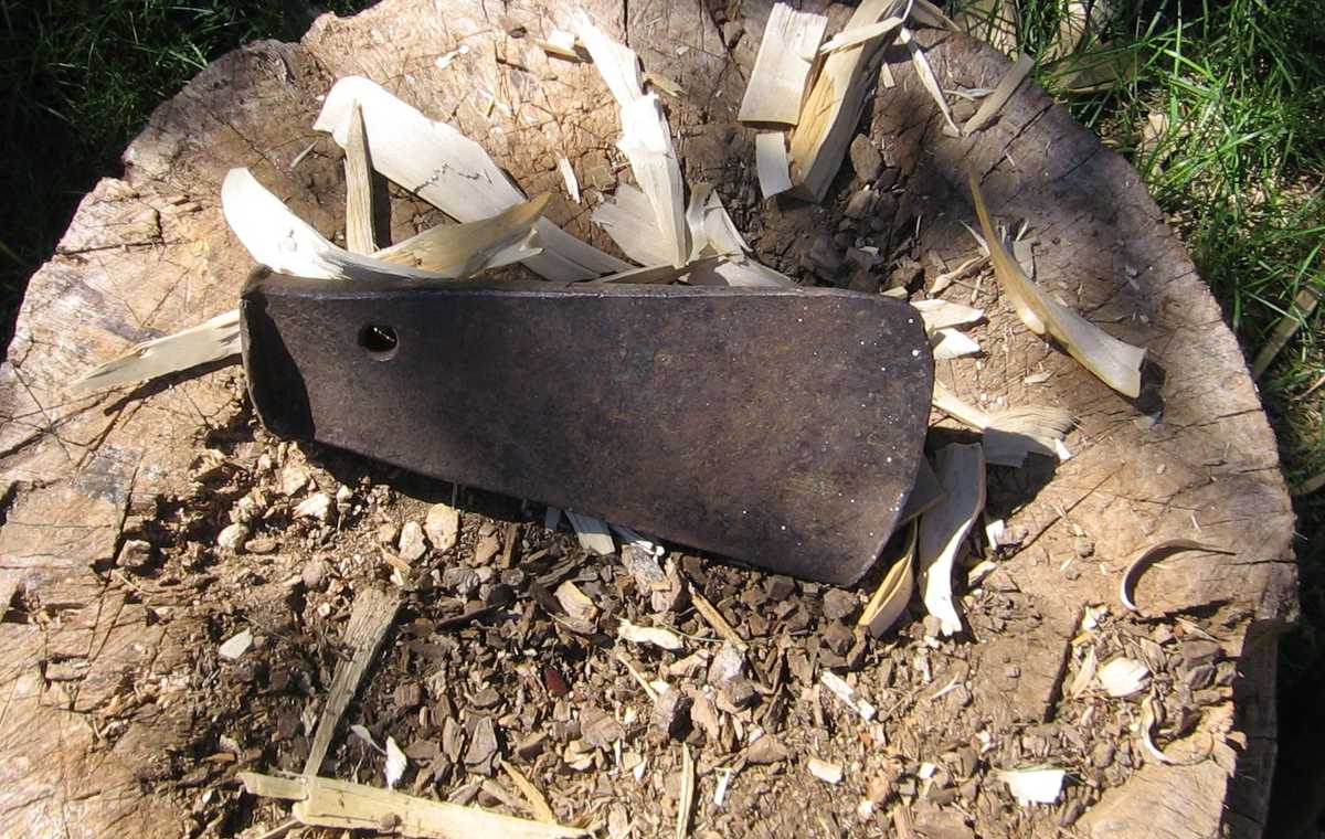

Here's something a few of you sawyers will recognize.
I use mine for hanging wedges to stabilize trees that may twist. Also effective in holding the kerf in frozen wood that would spit a plastic wedge.
