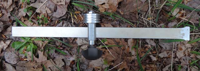

I found this underbuck tool at an antique store today for $4. I can't even find one on the internet to compare prices. It's in as new condition and doesn't appear to have ever been driven into wood. I'm pretty sure they didn't know what it was.
Dang. That was priced right.:thumbsup:
Nice score! Fitting :thumbsup:
The supplier of that parts list, Reid Tool Supply Co., is no longer in business. I found the company who bought them out and last time I checked they still carried the sheave (the critical part). I'll see if I can dig up a link when I get home to my desktop computer.
Correction/addition. That pulley is now available at Amazon. That thing was near impossible to find a few years ago.

I'll give you a pro tip on using the underbuck. The Forest Service website explains how best to align your undercut with the top cut. But that's the wrong way to go about. I set up the bottom cut first and cut just far enough to set a good kerf. Then I start the top cut, easy to align with your bottom cut. Work the top cut just until the first hint of bind. Then go back to your bottom cut to finish. Works like a charm.
In setting up the bottom cut I first decide where I want cut. Then I hold up my axe with the pocket underbuck attached and see where I would ideally like the underbuck to be placed. With the underbuck located I check where the axe bit needs to be set to achieve that cut. Then I set the axe. I might make several attempts before I get it just where I want it. Lastly I adjust the location of the underbuck along the axe handle until it's exactly where I want it.
Using this method it is a pure joy to underbuck.
For axe selection choose an axe with at least a 33" haft. 36" is better. It gives you more spring, more flexibility and more space for the saw between the axe handle and the tree. A thin bitted axe will set better and easier than a thick bitted axe. If you have the luxury of bringing a dedicated underbucking axe then consider a fiberglass handled axe with concave beveled bit!
A concave bevel is miserable to buck or fell with because it's so sticky. But it's that stickiness that makes it such a great underbuck.

I always opt for the minimum number of tools -- crosscut saw, axe, wedges. However, not everyone can stick an axe tight enough to act as an underbucker. I've seen a lot of people fail at setting the blade of an axe, as it takes a good wrist snap to sink it deep enough to hold. Punky wood is also a drawback. Just about anybody can drive a steel underbucker into a log.
Whether or not to bring an underbuck also depends on how many people are in your group, how much you have to carry and whether it's a back country or front country trail (close to the trailhead). We'll often spend several days to a week working at one front country location. We cache our tools on the mountain and go home for the night. The next day everyone has light packs and it's no big deal for someone to carry up a full size underbuck tool. On a back country multi-day work party where you're living out of your pack I would never carry more than a pocket underbuck.
After a windstorm, icestorm or fire you can have hundreds of trees down on a section of trail. Many will be elevated and an underbuck can make them much easier to clear.
