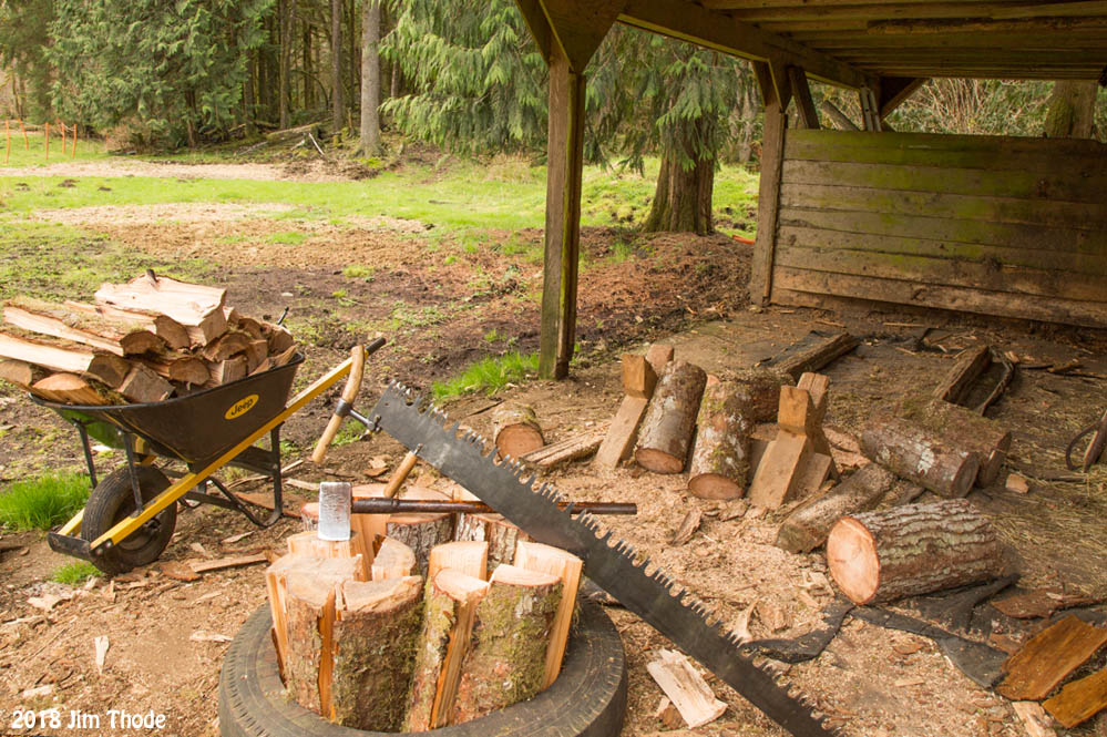

I previously posted my winter exercise a few weeks ago:
After about three cords this is what it looks like now:
Jim
I'm guessing you usually grip the curved end of that handle? Looks like a more natural fit in the hand.

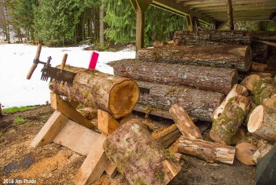

Here's an action sequence of a crosscut and a snowy day.
Yes, with the curved handle it is much more ergonomically correct. It just fits the angle of the hand.I'm guessing you usually grip the curved end of that handle? Looks like a more natural fit in the hand.
Great photos of what looks like single sawyer falling! Other then mine I've seen few photos of single sawyers. The Forest Service has a hard time understanding that single falling is very doable and actually safer (twice as) then two fallers in the danger zone.Here's an action sequence of a crosscut and a snowy day.
Thanks,Great photos of what looks like single sawyer falling! Other then mine I've seen few photos of single sawyers. The Forest Service has a hard time understanding that single falling is very doable and actually safer (twice as) then two fallers in the danger zone.
Jim
Thanks,
As far as the FS, it seems that way sometimes I'm sure. But there's no hard and fast it has to be two in the saw policy. The policy does allow two under the tree, for crosscut unlike power saw work though. And it encourages less time under a tree.
Locally, whatever the saw program managers opinions are, influence things quite a bit.
I do it a lot. I prefer it, usually. I'm promoting it in our district. Probably making no headway in the big picture. However no one questions me on it here, and I've done it enough to make it seem like a regular thing locally.
I have it figured as about 25 or 30% slower. Over about a 30" tree, i think two with a longer saw is faster enough to make it worthwhile.
I put a bunch of pics in the "use those axes what they were made for" thread, all those were done single as well.
They were road hazard trees, this one was going off its lean and had to be wedged.
There doesn't appear to be much hanging that one up. Did it slowing come down on its own from there? Or is that an action shot?
