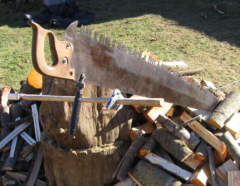

I do have a classy old vice,but it's for smaller saws,maybe a foot-long jaws...Is that too short?...I could cobble one out of wood 3-4',if it's better to keep the longer section clamped...

I'll answer one thing right now. A perfectly good vise for up to about 5' can be made from a couple 1 x4 as long as your saw. Clamp the ends with a C clamp, then put it in a solid bench vise.
It works even better if you have a leg vise you can walk around.
I work my saws vertical, so this does fine for me, when I'm home and not at work, where I've got a regular saw vise.

I happen to have this vise...its a crude version of carpentry but works well.
