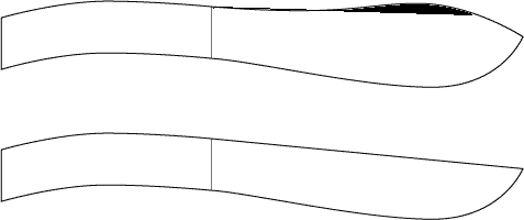

The hump creates a more obtuse tip angle ...
No it doesn't :
http://i7.photobucket.com/albums/y269/CliffStamp/misc/nessmuk_tip.gif
The top knife has the hump cut off and the tip profile is not effected, nor is the belly of the blade.

Cliff Stamp said:
No it doesn't :
Geez, Cliff, way to split hairs. You just changed it to a smaller hump, albeit one with a peak in it, now. Just a really blunt clip point.
When you said...
Cliff Stamp said:
I don't see this, if you run the spine straight out from the handle you would cut the hump right off and not effect the tip at all.
...it sure sounded like you meant a straight spine out to the tip, with no hump. Since, after all, that hump was the topic.
Whatever. :rolleyes:
I think what was meant was that the extreme hump is not absolutely necessary to achieve the described effect in tip strength. A typical drop point is the same idea. However, doing it the humped way allows you to have a narrower/lighter knife in the back than a uniform-width drop point, which can be a plus or a minus, depending on your preferences.
However, the wide hump IS useful if you like really getting up on the blade for fine control in skinning or other tasks, as it gives your hand a little more room to grab and manipulate, and the curve is more ergonomic than a flat back. My grandfather used an old knife of this pattern for skinning, and that's exactly how he used it. I was always too afraid that my blood/fat covered hand would lose on the slippery blade to do this, but I have to admit that he could pull a hide off an animal a lot faster and cleaner than I can. Then again, it might also have had to do with how much experience he had in this, which certainly dwarfed mine. ;)
Oh, I agree, it's sort of a drop point taken to extremes. :D But you gotta admit, there aren't many drop points that leave that much steel at the tip. It's a unique design, and the more I look at it, the more practical it appears!
Remember, Nessmuk also liked to carry a large moose-pattern slipjoint, which provided a nice sharp pointed tip if needed, and a hatchet for heavy wood work. I haven't read his book yet, but I'm guessing the fixed blade knife was more for skinning and food prep than wood splitting or caping.
Yeah, I noticed that too. Out where you're batoning, the knife is deep; the rest is slim, and the point is sturdy. Very efficient.

Cliff Stamp said:
There is no hump in the knife in the above picture, it is a standard drop point.
Actually, a clip point.
But even that is a matter of perspective:
Look at it that way, it's a hump. And still useful. And still has a stronger tip. ;)
Let's just agree that that you misunderstood my point, and that I misunderstood your point, and call it a draw, OK? I've got better things to do this evening than to try to baton a clue through that knotty skull of yours. :D
A clip is straight or concave, the above is convex so it is a drop, considering the blade width and the point relationship, some would call it a spear.
-Cliff
There's very little curve there, and I've never seen a drop point with a break like that, but if you want to call it a drop point, be my guest. Or call it a spear point, if you like. Heck, call it a tanto. Or call it Mary and take it out to dinner, for all I care. More power to ya. :rolleyes:
