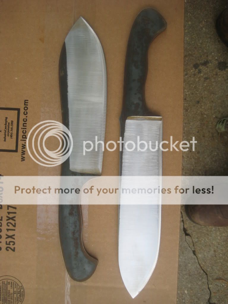

Got it. going to do some hand work on the blade today or tommorow and heat treat them on Wensday. I ordered some new belts so those should help with keeping everything crisp and clean. going to wait on tapering them till i have the sharp belts rather than screwing them up wiht dull stuff.
here are the profiles. i tried to get a good background to show the profiles on. Got the handle tubing and flaring dies sorted out so that should work out well. if you want to change anything to the profile it should be done before i heat treat it. and i dont want to scare you with the contoured bevel on the edge. the finished grind will all be fared in together. there will be no abrupt line like there is now.
I really like them...like the way you tapered the blade on the chopper a little with the visible little hump on the spine...and the drop point is spot on.

So you want that type of blade finish? hand sanding takes the marks horozontally instead of vertically as on the benchmade, is that what you were wanting?
Chris,
i don't care much for the sand marks if they are vertical or horizontal, once i cut with it, those horizontal marks will be messed up anyway. If i had a preference yes, i would like the horizontal sand marks by hand, they make for a prettier blade...
what i was referring to above was not the sanded finish but the grind of the finished blade. I would like the grind to finish off on top with barely a visible lip at the very top of the spine, meaning full grinds ALLLMOST to the spine on both, I don't think i like the black line on the current 'saber grind' on the Nessie and the chopper can also get a slightly higher grind pretty much to how you see it on the Benchmade chopper, that's what i meant in my initial comment.
I would like a satin looking blade finish on both, not shiny but not dull...i know hand sanding takes a bunch of time and it would be easier to use a fine grit belt in order to accomplish the satin look without the horizontal hand sanded lines, if that will save me some time/money, do that...i would hate to have a real nice hand sanded finish only to see it go to hell on the first chop.
Don't misunderstand me, i don't want to see 'grind' marks up and down the blade, i would like a satin finish, but if you can accomplish that by belt faster/cheaper, go that route.

the grind marks on the Nessie and Chopper can stay where they are, just sand off the black is what i meant, make them blend in nicely yes.

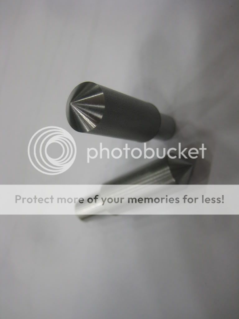

also... i made a set of tube flaring dies for the arbor press a friend is letting me borrow.
