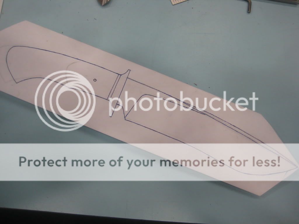

i am actually have a knife in the works (just on the drawing board for now) that utilizes a very similar blade shape but with a hidden tang and gaurd... and a stainless san mai blade. i already forged up the steel now i just have to make it.
...but it doesnt matter cause i got the knives heat treated last night!

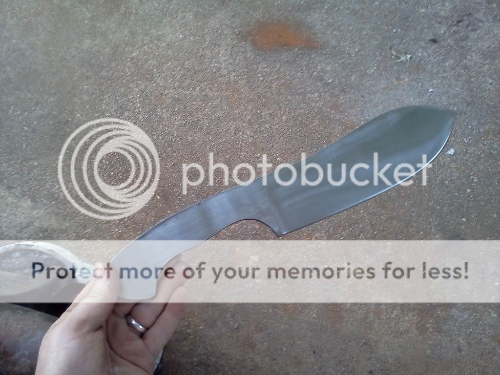

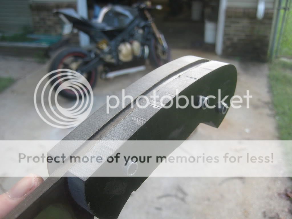

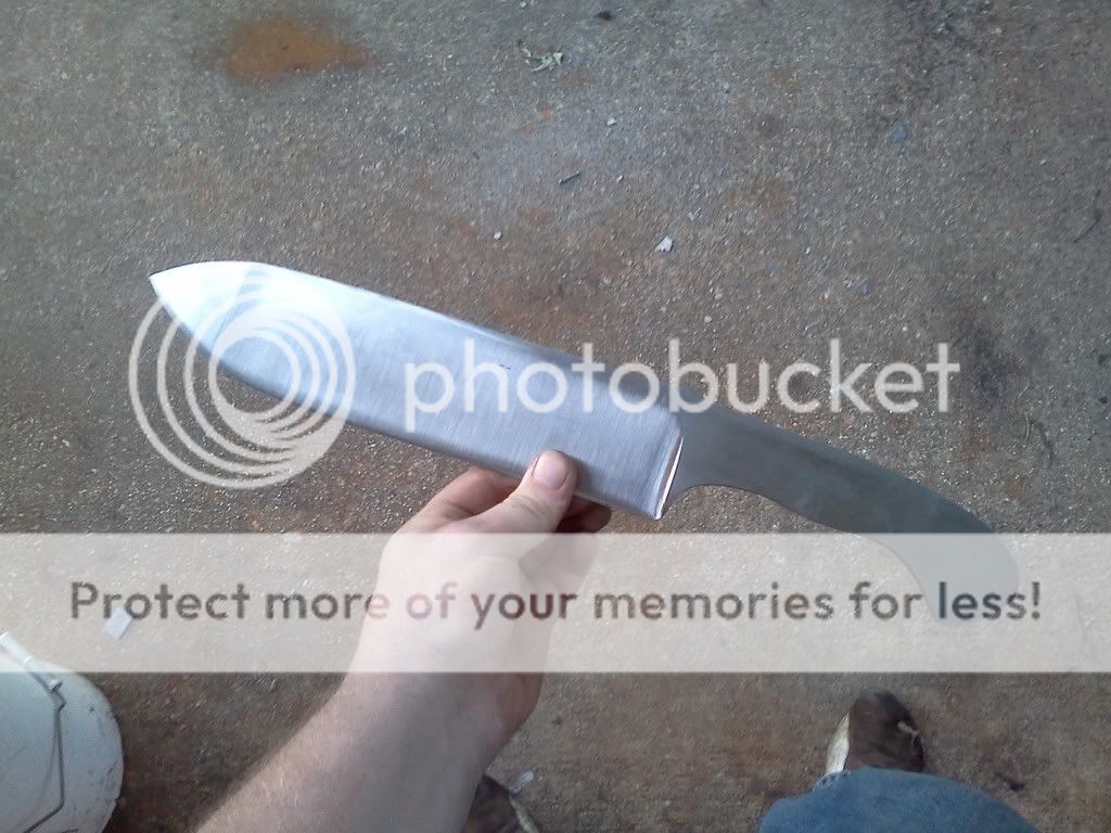

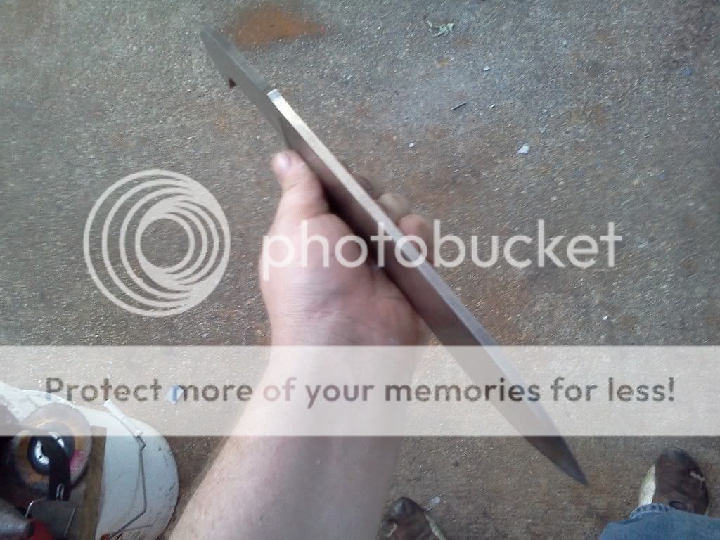

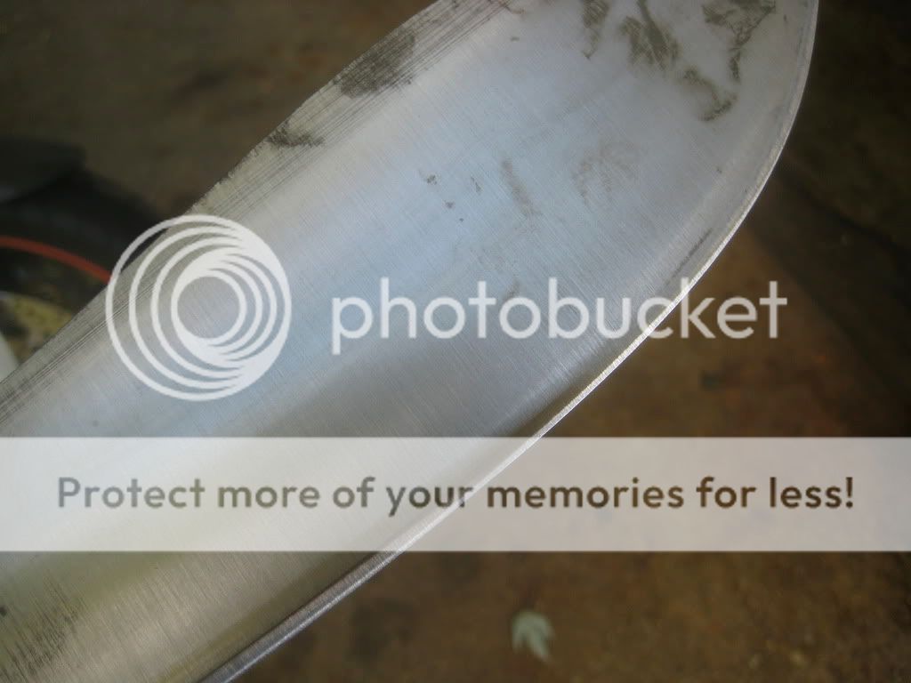

First... i got my belts in the mail. som new 36 grit Norton Blaze belts, and they are freaking awesome. so ground in the taper. it really made a huge difference. what is funny is the nessie has more forward weight than the chopper because even though the blade is shorter is is much wider.
sorry for the crappy pics.. i left my camera at work.
and a crappy picture of the taper

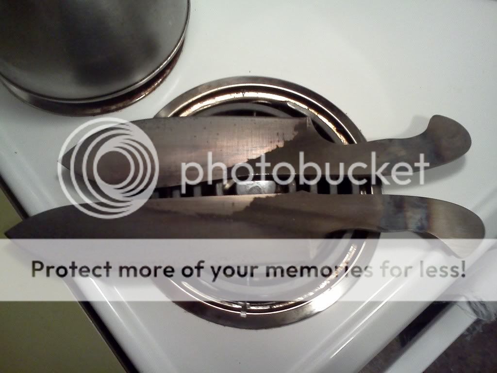

I didnt get any pictures of the knives during heat treat as i was moving quickly and my wife was washing the dishes (not going to interrupt that!) =)

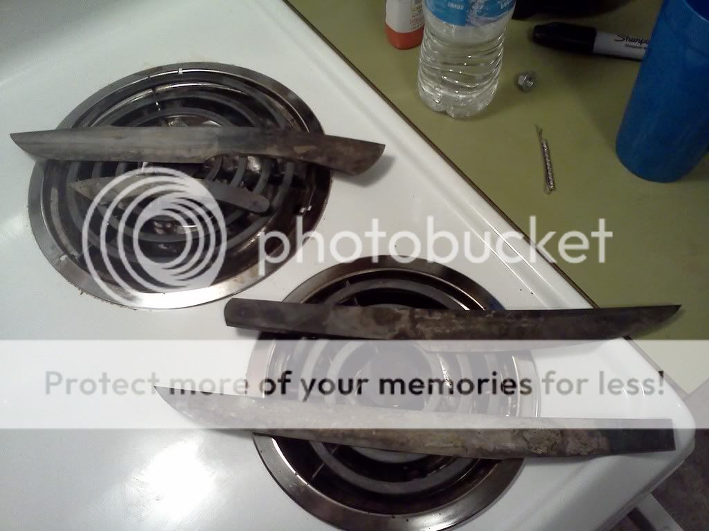

but here they are post heat treat.
No cracks that i heard, and the edge is fully hard. Right out of the quench and into an hour of tempering
...along with the other knives i did at the same time. water quench and no cracks i dont think!
the top and bottom ones are cable damascus so i am excited to see how that turned out.

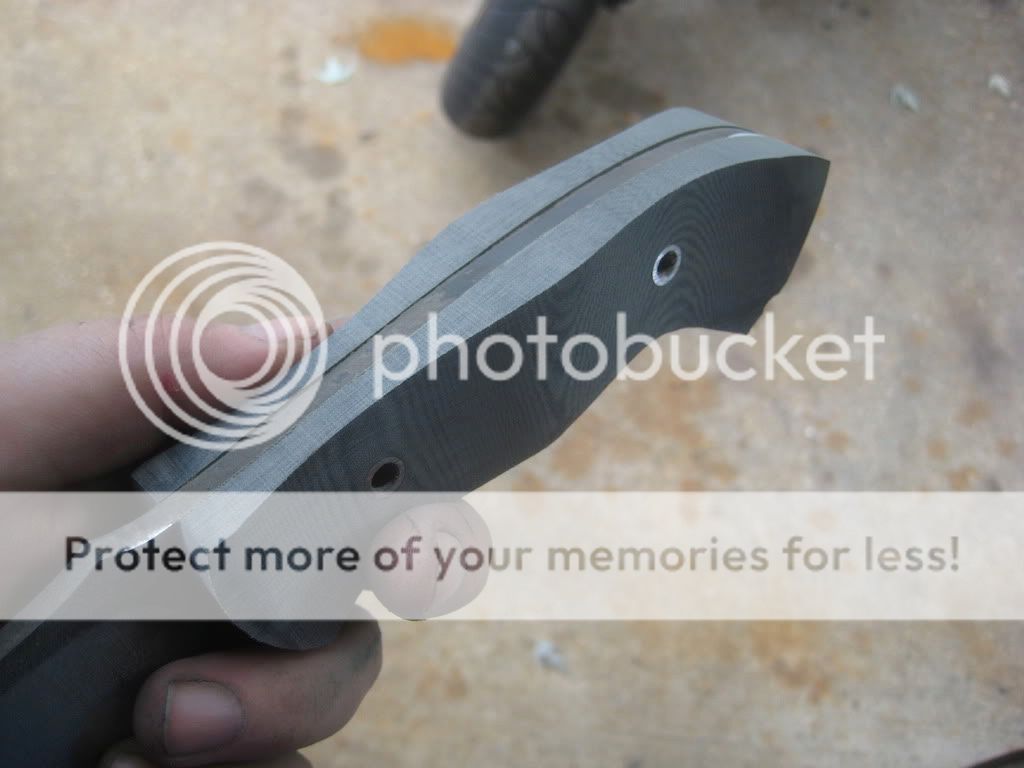

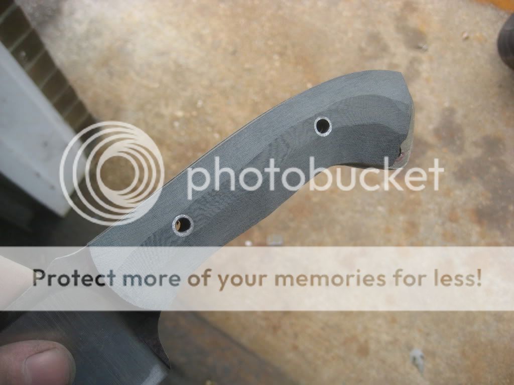

the handle slabs are cut out. i am using .5" black linen micarta to have enough thickness in the material for the palm and pommel swells. i will also most likely get the holes drilled and reamed.

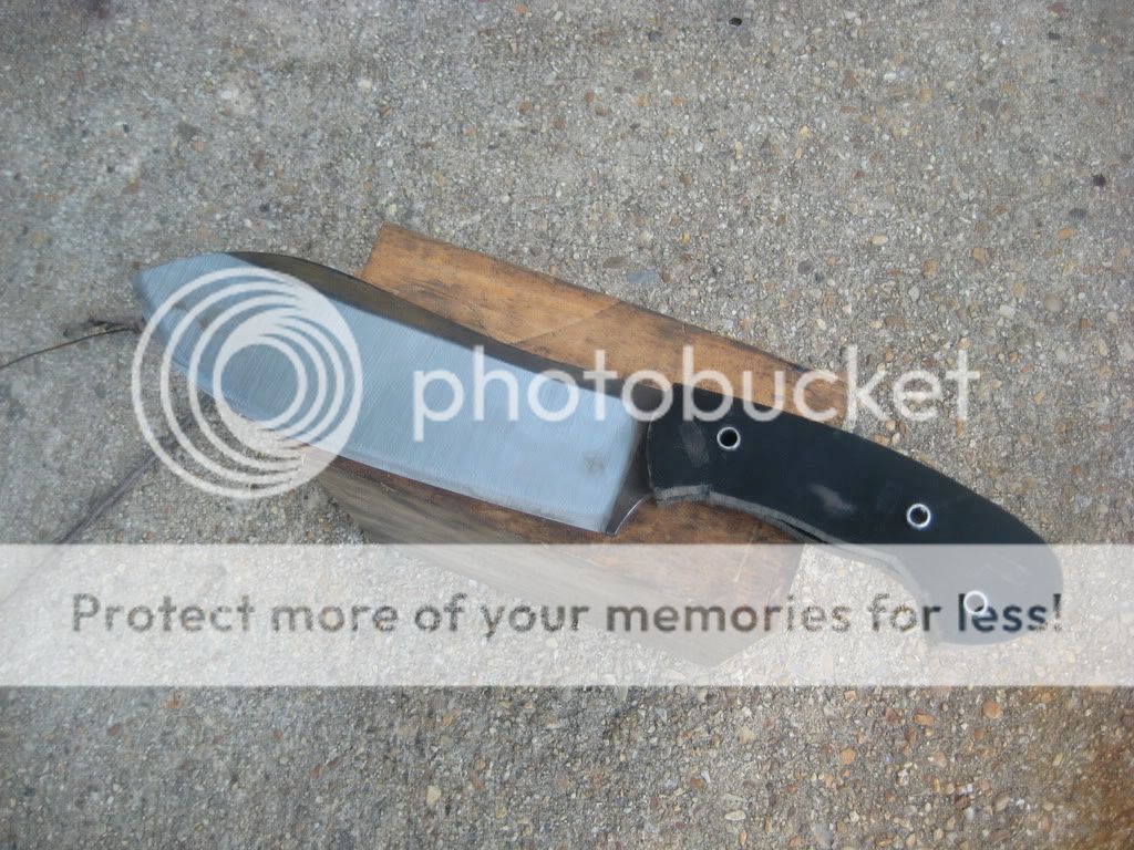

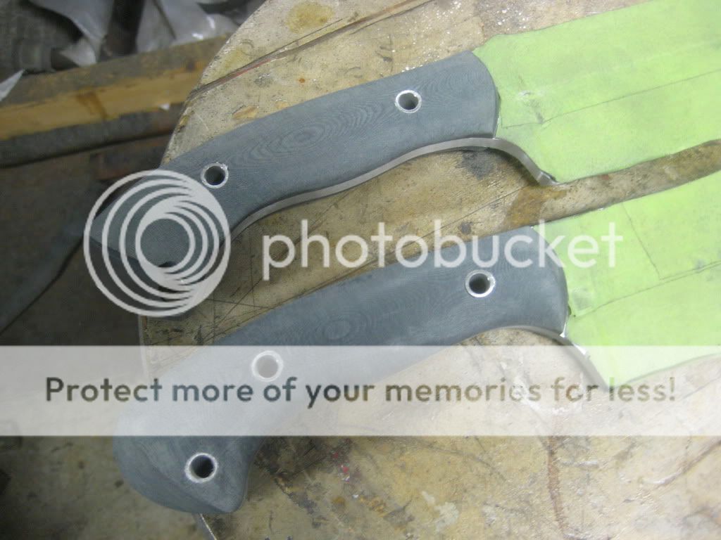

I cut the micarta out to size for both knives
i then drilled the handles and slabs and put them together with a set of sacrificial pins
then i ground in the butt and palm swells
then i roughed out the bevels

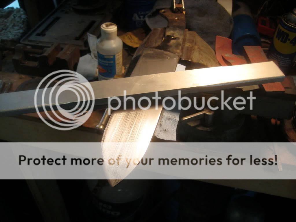

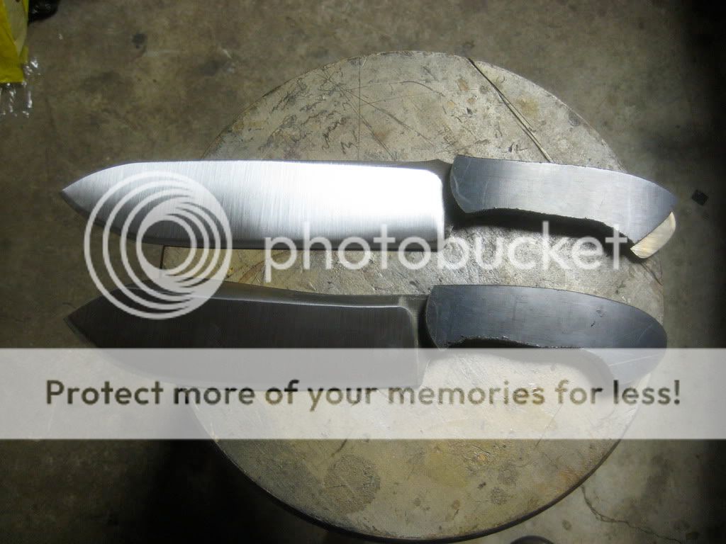

Now with the handle roughed in i finished the grind on the blade.
Before testing:

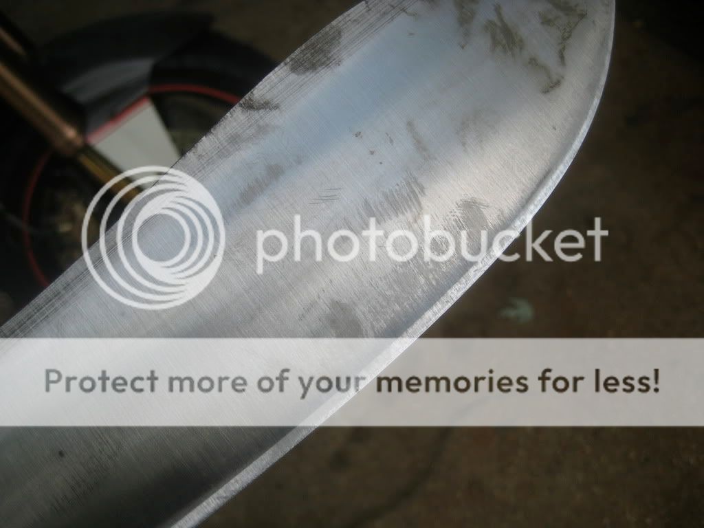

both knives cut through a 2x4 no problem and were still shaving sharp afterwards
Edge after cutting:

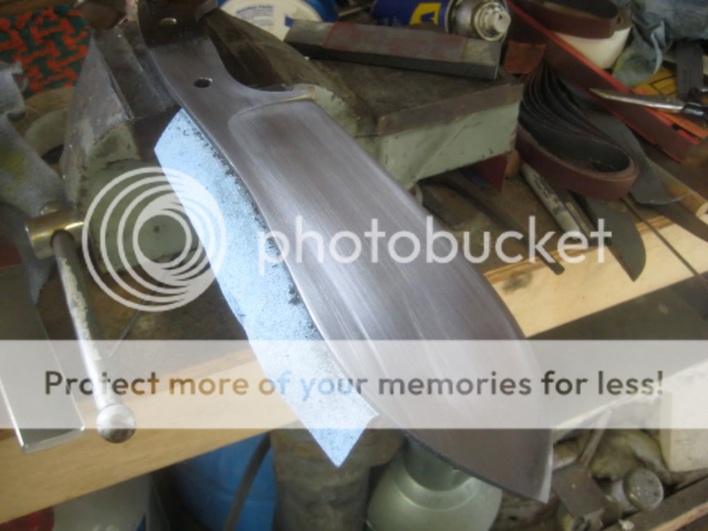

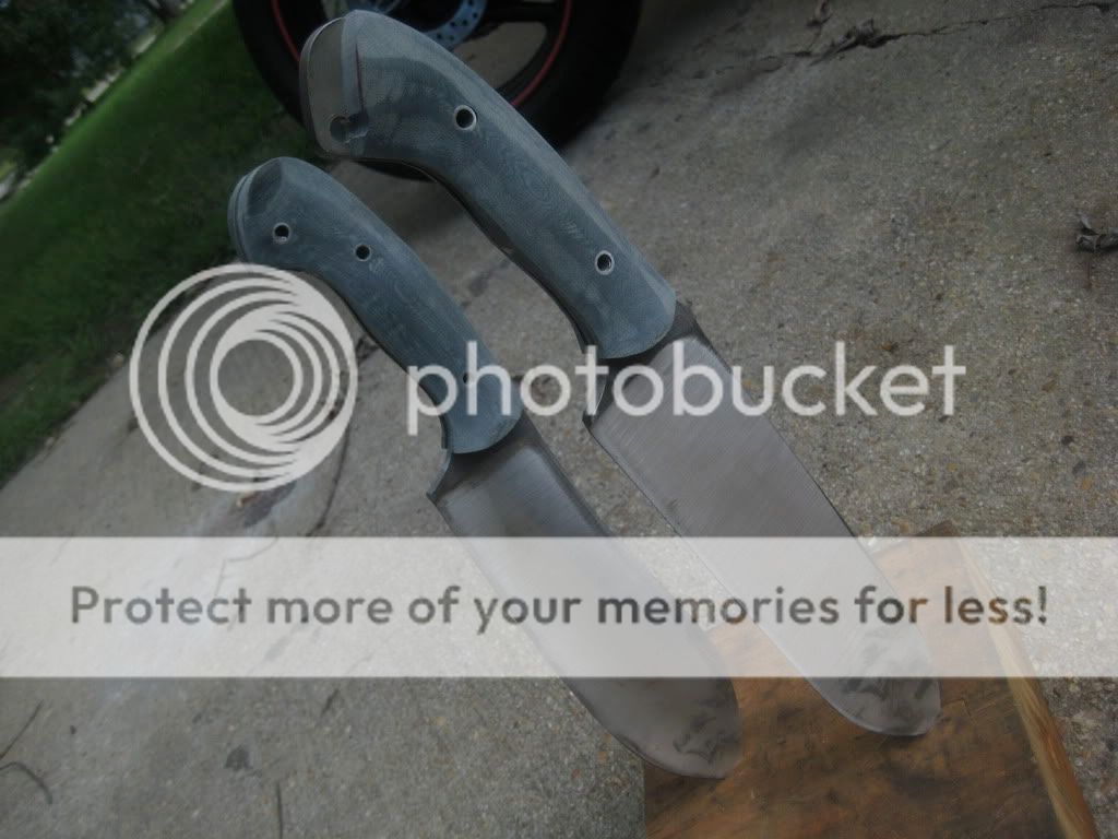

then i pulled the handles off
and prceded to hand finish the blades.
taken to 320 grit and finished with some 600 grit free abrasive (it isnt finished in the picture)

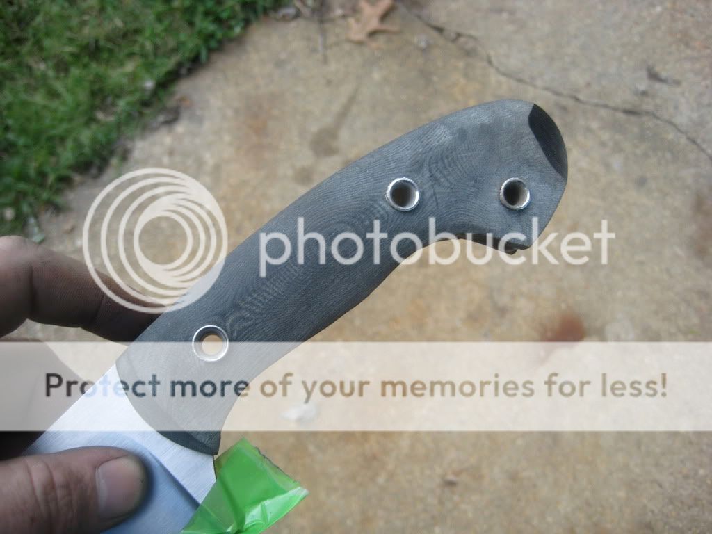

then the handles went back on and the tubes flared
then the tubes got trimmed down and the handles got a little more contour. they just have to be finished to 320 and then they will be done.
let me know what you think

reallly nice progress bro.
one thing that jumps out before i forget...the chopper grip at the lanyard hole, cut it more so it clears the lanyard hole completely and round it out more so it isn't so straight/square cut.
the nessmuk is sick, i love the shape, the chopper will grow on me, i don't love it so much, but the knife ain't finished, that might change...maybe it's the unfinished pummel that just doesn't 'flow' for me right now, it looks nice all the way to the rear where it stops looking nice. Use your vision and do whatever it needs to flow better in the pummel.

on the front part of the spine, at the point (that you're going to grind) give me a nice taper, not sure what it's called when you cut both sides of the spine at a 45% (like a false edge), ONLY where you are cutting the spine to form a point, all the way to the tip.

Chris,
if you can round off the butt end of the grips to look more like this...on the big Chopper, so they're not so straight cut
