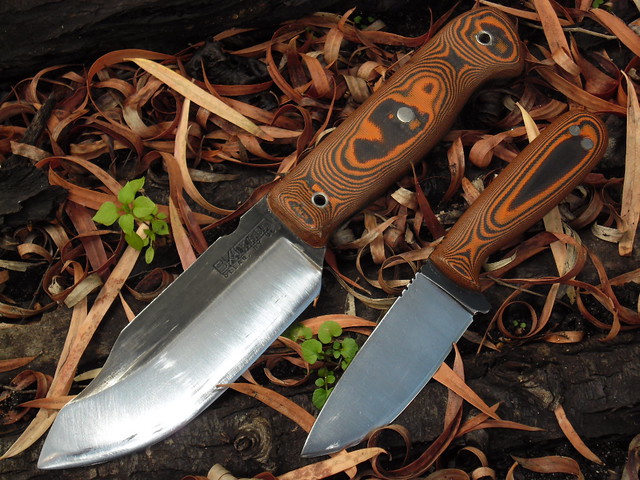

Hey guys,
Finally got this done as of 04-29-2012! Thing has been in the works for weeks now and just sanded down the (tough as hell) pins yesterday morning so updating most of the pics now to show the finnished product so sorry if you visited this and found there were few pics of this beast. Overall I think it came out quite well but one complaint I DO have against this is the scale thickness, they're made of 1/4" G-10 but I think it would be alot better if it were just a hair bit thicker (shame I cant add some liners) and maybe that the I removed to much steel from the front and now the blade has a more neutral balance. Ummm... Yeah... No Idea what else to say about this, maybe that the convex reprofiling job was done by hand and took me 9 (!) hours? Anyway, if anyone ever wants to give something like this a go I'd say go for it! Its not hard, so long as you keep the blade cool when grinding and be mindful of the edge (I actually hit the very back of the edge a bit when removing the front guard ;))Coincidently, I'm beckerhead#205 and this is my 205th post... Kinda fitting isn’t it?

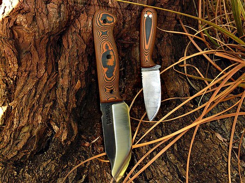

Not to brag but pictures cant show how good these look together :eek:...
NOTE: You can see the epoxy filled handle of the BK-2 if you look closely in the 2nd picture (just the very back of it is epoxy).
004 by CamH_16, on Flickr
BK-2 + BK-14 by CamH_16, on Flickr
BK-2 + BK-14 (2) by CamH_16, on Flickr

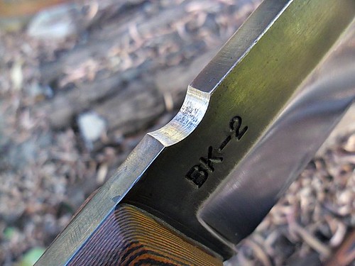

Ferro notch DOES work, just remind me to clean it up.
BK-2 Ferro Notch by CamH_16, on Flickr
Getting better at convex edges so I think its socially acceptable to show this off, unfotunatly the convex edge in this pic is actually to steep and causes the edge to roll. (Its now fixed as of about a week after starting this thread.)
BK-2 Convex Edge by CamH_16, on Flickr
Sooo...What do you all think? Seriously, even if you hate it please post your thoughts.
Just cos I've been asked if I actually mod these or do I buy them or what I'm saying now that yeah, I do this all by hand in a corner of my garage...Not bad for a 15 year old with a bench grinder and a dremel tool, no?...oh wait you hate it? That’s cool I guess... I'm only doing this till I get a job at Ka-Bar...HAHAHAHA like that’s ever gonna happen…
