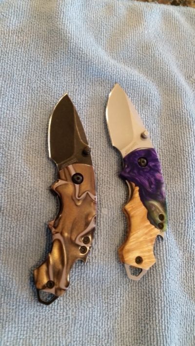

A couple Kershaw Shuffles and a Boker Kwaiken I did. The CF on the Kwaiken is really hard to photograph.

Thanks guys! The shuffles are all in kirinite except for the one on the right of the top picture which is Shockwood. The kirinite is really easy to work with.

James,
It was mostly all dremel work with the "workstation" drill press they make. The shuffles have nested liners so I used a routing bit to carve out the pockets and counterbore the screw holes. Then just sanding drums to shape. The carbon fiber was too tough to work with the dremel routing bits, so I ended up drilling straight through it with regular bits and then added g10 liners so I didn't have to counter bore the cf. Not the most sophisticated set up but it worked.

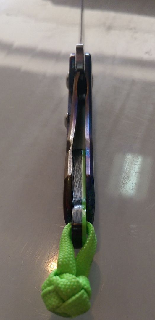

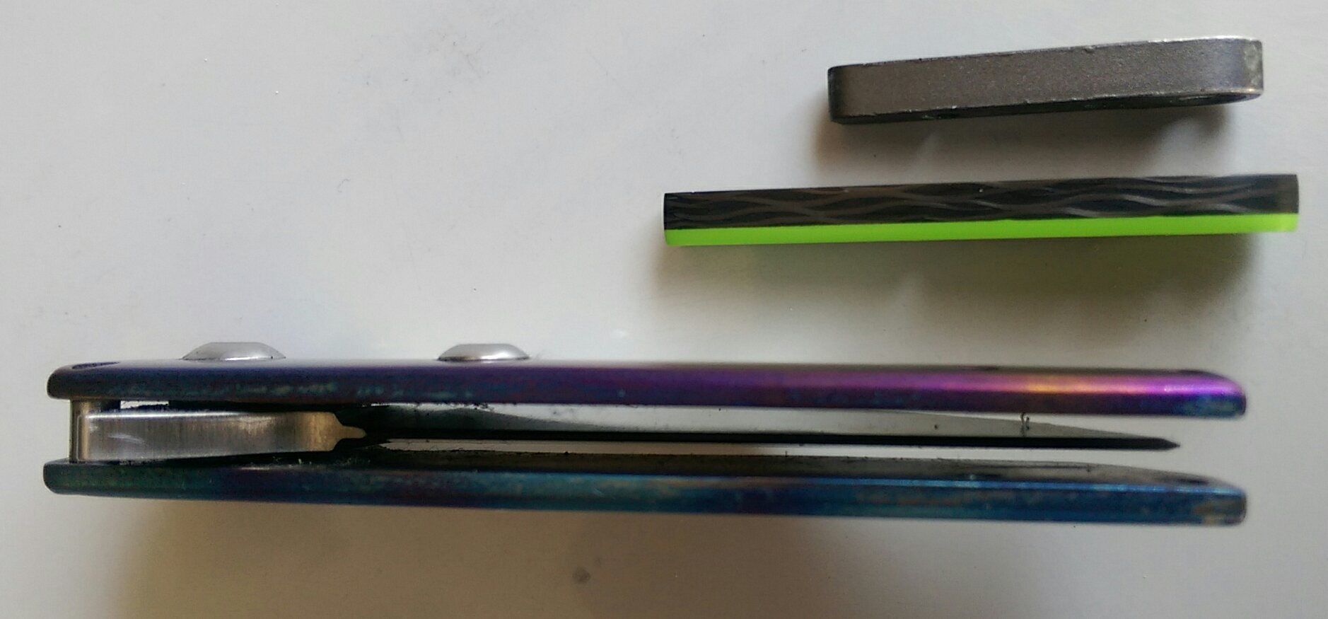

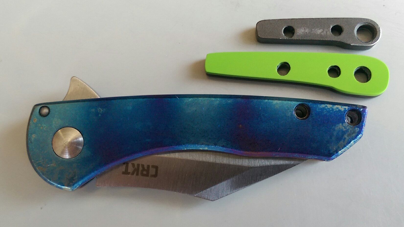

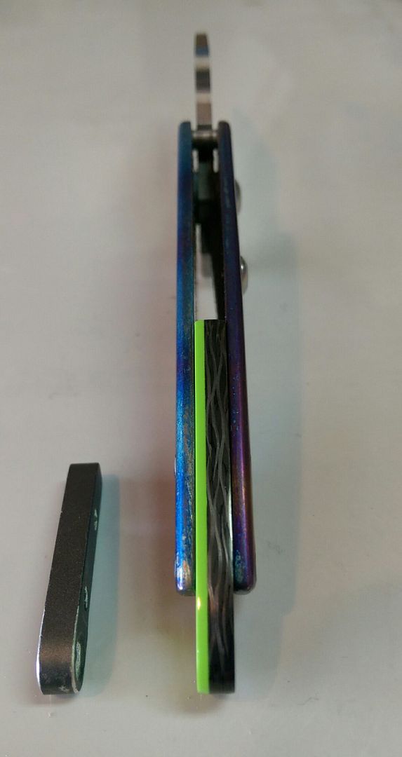

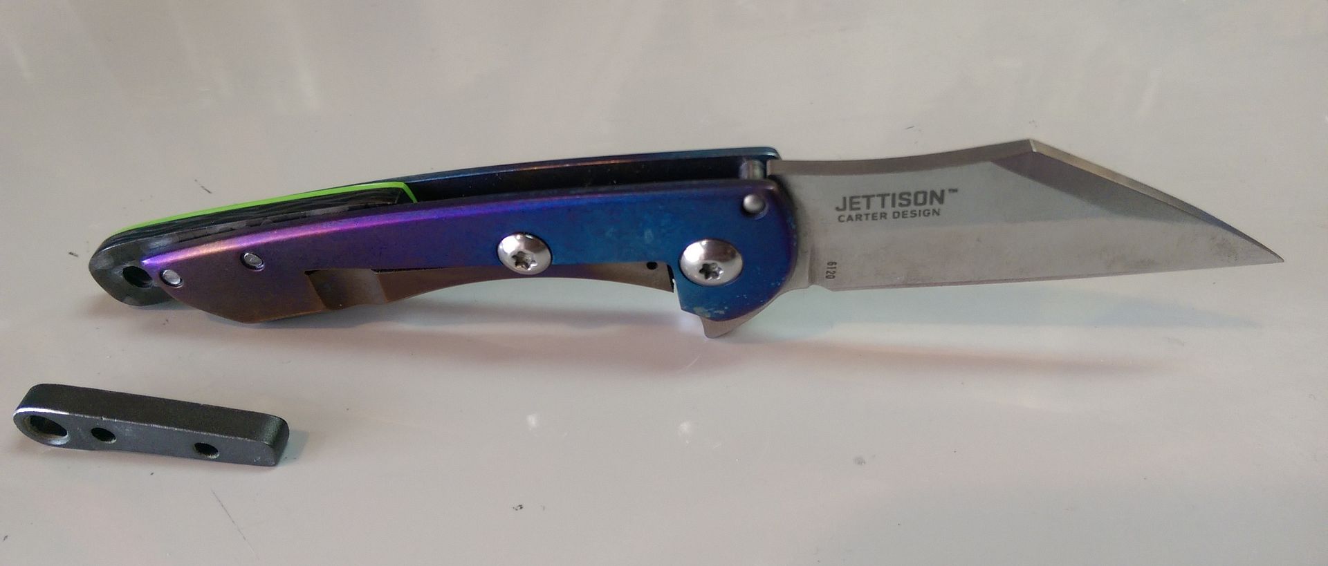

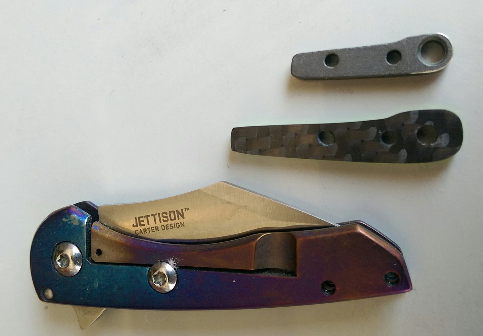

Heat anodized my crkt Jettison and replaced the rough aluminum backspacer with a custom one. Hand layed and vacuum infused the carbon with epoxy and gel coated one side.
The original spacer was .12mm too thin causing the handle scales to pinch slightly. This new spacer fixed that and did more to smooth out the action than a week of flipping.

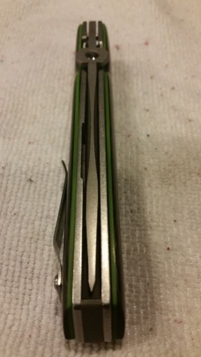

My latest Mini-grip scales...
Still require countersinking the screw holes and shaping to the final dimension. Getting close though...
(Pinstripes look green, but they are actually a pale yellow)
