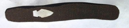

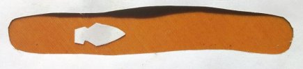

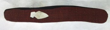

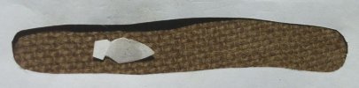

here are some half-assed playing-around mock-ups, first in micarta (color is a bit off since I used a phone for pics, couldn't find my camera)
burgundy linen, natural burlap (shadetree), green canvas, brown/natural canvas, and butterscotch (looks too orange here)
I like micarta a lot but I think the woods below are a lot more interesting on a shadow design like this one.

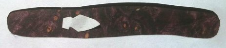

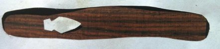

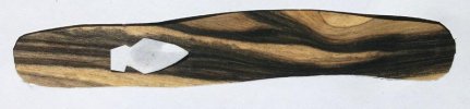

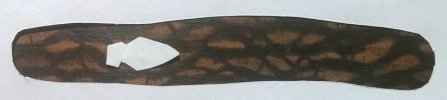

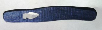

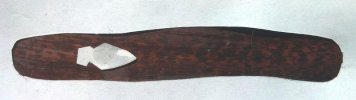

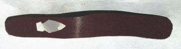

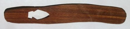

here are some woods: black&white ebony, black palm (cross-grain cut), dyed burl, cocobolo, and a blue dyed koa for fun
the shadows create a cool optical illusion as if I cut out the wood shapes individually, but in fact I just cut the shape out of the middle of a piece of paper and laid it over different blocks of wood, then added a really crappy paper shield. no pivots sorry.

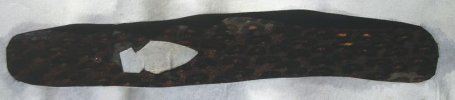

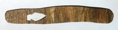

I don't have any horn alas, but here's some more woods:

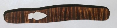

ironwood, karelian birch, high-grade koa, dyed lacewood, and lignum vitae

I dunno about the covers, but that shield is sweet. Joking aside, thanks for the effort. I like that black and white ebony

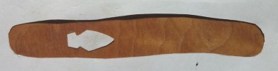

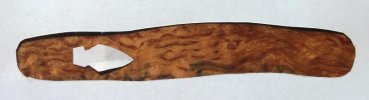

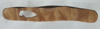

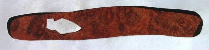

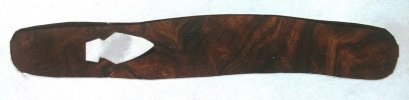

last batch of mock-ups in wood:
mango, maple, osage orange, snakewood and some unknown burl found in a scrap bin

the sad thing is, that was my second attempt at the shield!
For this design I really like the vertical lines of the b/w ebony and the cocobolo, however it's much harder to get consistent lines in many pieces of bw ebony for 300 scale sets, than it is to get similar and consistent cocobolo.
I am also digging the mango, but didn't have a piece that would permit me to orient it vertically rather than horizontally.
Close behind for me are the tight patterns of the black palm and the snakewood. I really need to try again with the black palm b/c that picture doesn't capture it by half.
The lacewood is pretty boss as well.
The lignum vitae seems a little dull visually. It's a good strong wood but lacks visual snap compared to some other choices.

Out of all the mockups you posted, my favorite is the natural burlap micarta. My next favrite is the high-grade koa, but isn't koa extra expensive?
Anyhoo, just my two cents. Thanks for the mockups
Thanks for the trial 'patches' The Black&White Ebony DOES look interesting, Karelian Birch too. As for the Micartas, Burgundy or Natural be top.

Others, like maple, bocote, zebrawood, padauk, etc... are actually very soft and won't hold up to long term use very well. Cocobolo, being a nice oily rosewood, makes great knife handles - although it's very brittle as well. I don't think it would tolerate the stress of a bare head. Ebony is cool, the black & white stuff would have a unique look, but we've kind of been-there-done-that with plain ebony already.
