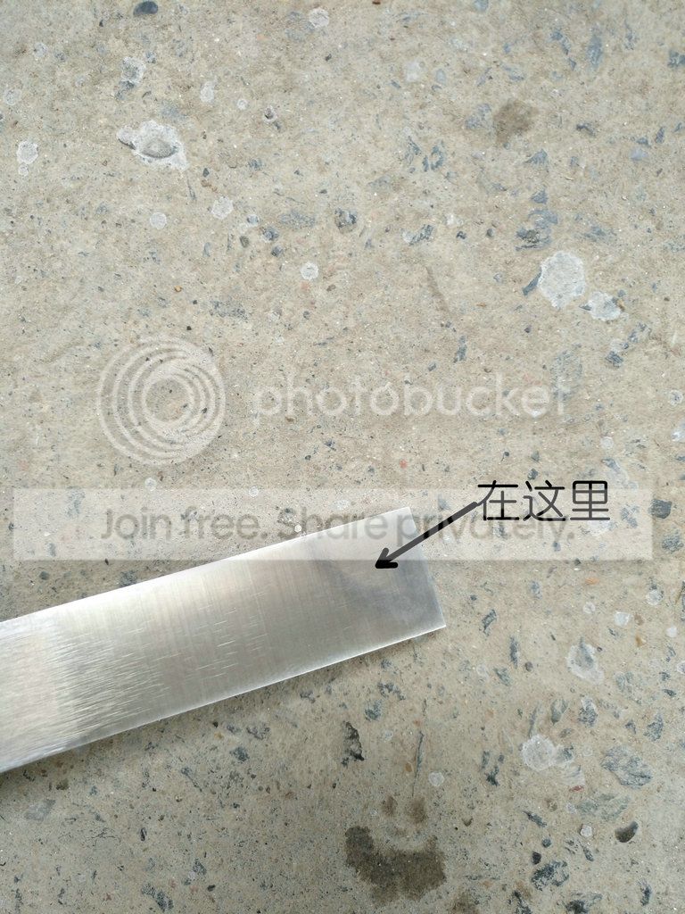

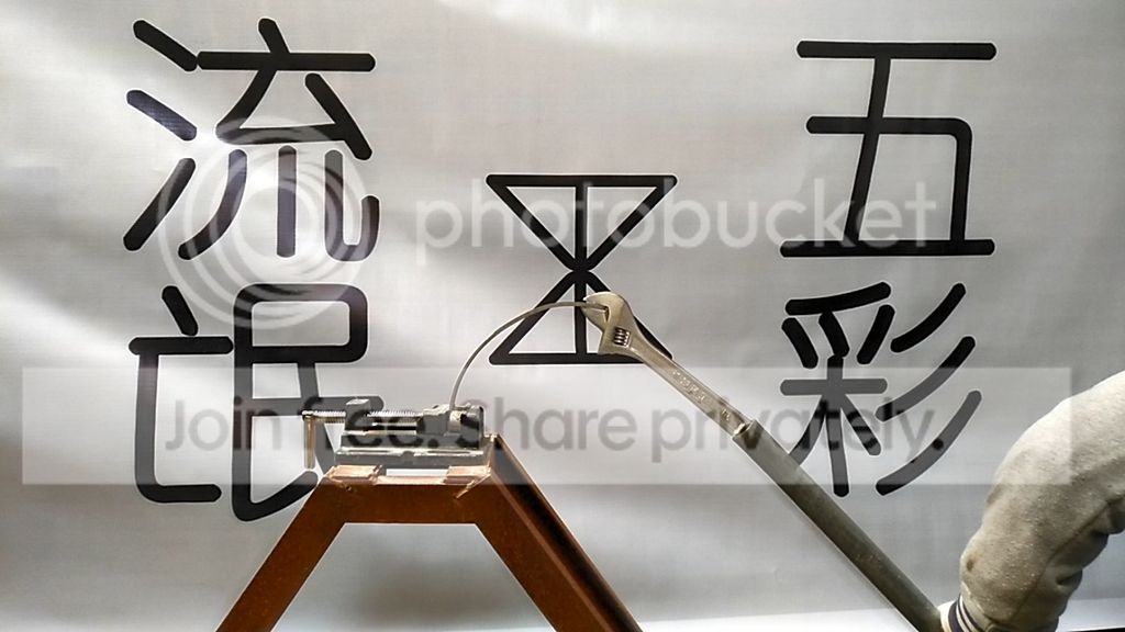

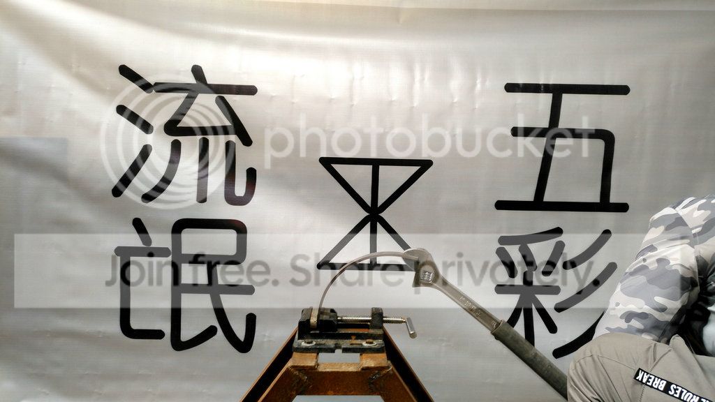

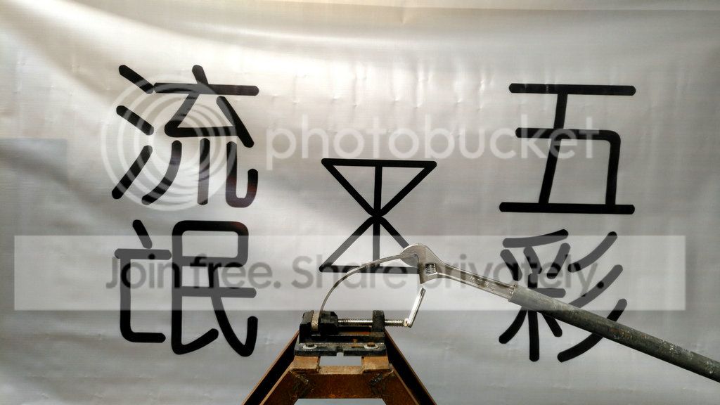

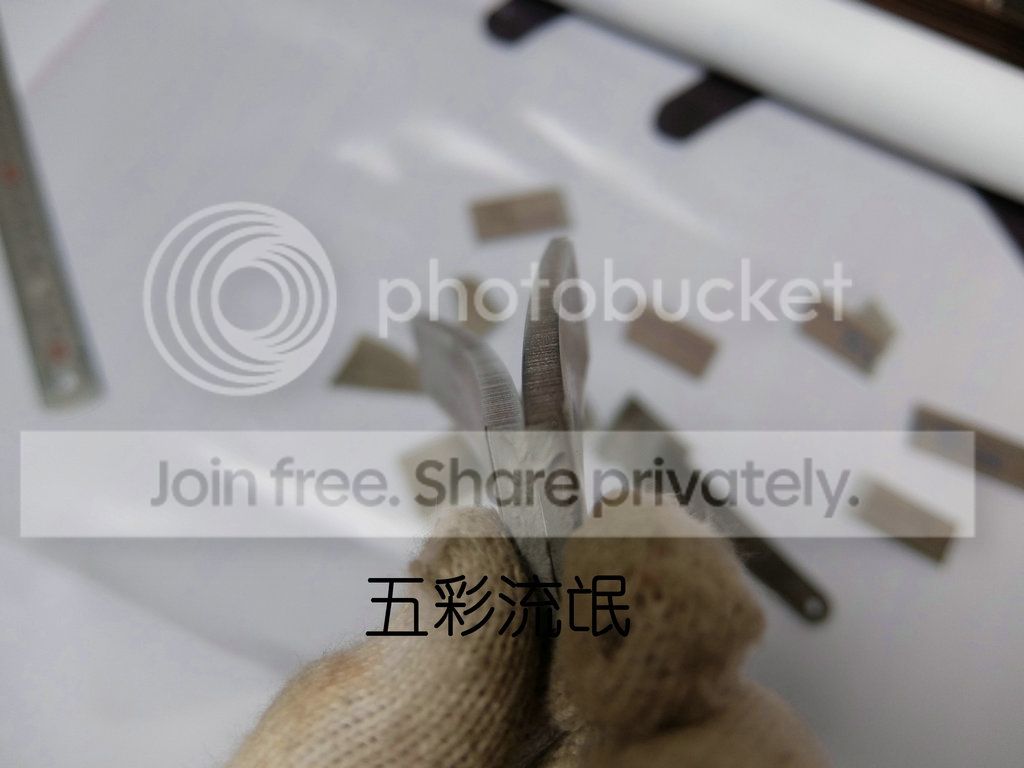

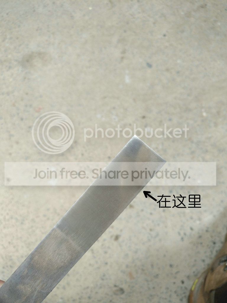

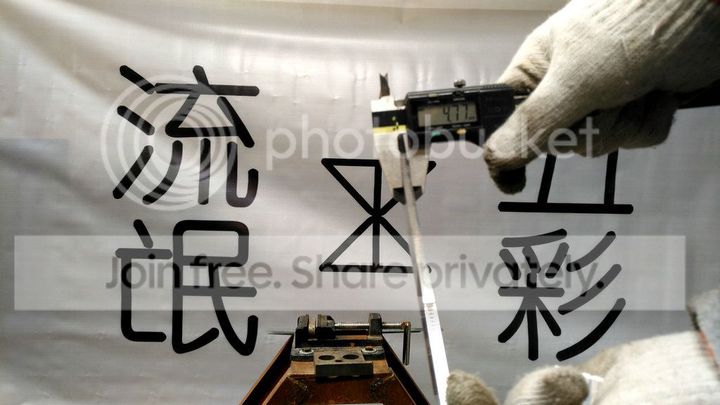

Hello everyone, I am from China. I will not be in English, thanks to Google translation, I am sorry.
The following is my heat treatment D2, 3 processes, the thickness is 4.5-4.7, the length of the photo.
The length-to-thickness ratio is usually 35-40 (long-thick ratio: intermediate remaining length / material thickness)
Hardness: the first, 59-60 HRC. Second, 58 ± 1 HRC
Now you can break to 70-90 degrees. You can use its flexibility, plastic absorption of the impact of effective work. That is, you can make a long long knife.
The first is similar to carbon steel local quenching, the second is the overall quenching. The third is the sample

Impressive flexibility for D2. My experience with it has not been with a knife, but rather making progressive dies and gages with it, where flexibility is not a desirable function, but high precision with a lower amount of thermal expansion is needed. If you're able to get D2 to harden and have that level of flexibility, that is amazing work.

Hello, D2 as a knife material is very common, many brands and knives will use D2 as a knife material. I now do the work is to break through the "high alloy is not suitable for long knife" this view. In China, personal production knife is a gray area, the limitations are great, but I have this heat treatment process of semi-finished products sold to other enthusiasts, and is doing further testing.

Never thought i'd see d2 flex like that. Great heat treat! d2 is a favorite of mine for blades.

OP - look like you are on something here - 60rc 90 degrees deflection... If I may
What are the actual(or estimate) deflection/flex of this bar for: Elastic (bend and return straight); Plastic(yielded/set - stay bend) ranges prior to fracture/break?
Although D2 is fairly inexpensive relative to others & PM tool steels. A long knife/chopper bar is quite expensive compare to 10xx/52100/80crv2/etc. steels.
I like to experiment with D2 because of its known poor toughness - hence, easy to discern/delineate improvement (if any). Here is my D2 chopper, I posted a year ago
[video=youtube_share;31QhteR1SMA]http://youtu.be/31QhteR1SMA[/video]
If I was asked to produce a bar can flex as op did, my thinking would be:
Annealed D2 - can't do it because low elasticity (bend too easily) and not that great plasticity because high carbide volume.
Fully martensite (less than 5% RA) - similar to ^
High RA% matrix - yes, this would be my approach. Excess carbon in austenite matrix, thus remove as much carbon from carbide as possible. 25+% RA while still reach 60rc, which support good deflection ranges. However edge impact load probably only good for few impacts until RA convert to martensite (chip thereof). High RA% also lend to lousy edge stability.

I can hardly translate your words. But I guess I still guess what you mean.
1, the video inside the knife is not mine, this is what I guess the first paragraph.
2, a long knife needs some flexibility, plastic. Because of the long knife in the cutting, there will be a very high impact power, this time, the impact of the steel itself is not enough to support the upper limit of the impact of high impact power. Need to have some body to absorb some of the impact function. Is to rely on the blade deformation. That is how much the ability to break the knife, like the ABS test. The strength of this break can not be particularly large, not particularly small. Different lengths of knives and shapes and uses require different values. The knife is too easy to break the bend in the use of very easy to deformation, not easy to break the knife when the use is easy to cut off, or knock back after breaking. This is my guess at your second paragraph.
3, there are 3 heat treatment process, but it is not what you describe. Residual austenite is needed, a certain amount of retained austenite is good. But this can be bent to 90 degrees can not only rely on retained austenite.
I hope I correctly translate and understand your main meaning.
