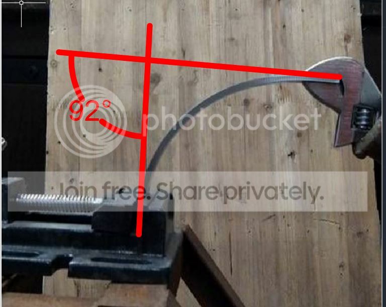

D2 heat treatment, three processes, you can break to 90 degrees.By

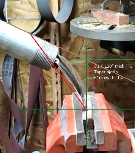

Intersected angle between 2 tangential line at end point. So here is a revised pic. Sure, a pipe isn't accurate on one end. At any rate, here is a revised pic - and it's inline with my guessed angle before - just calculated differently.
Ratio: 112/3.04 = ~37 (https://en.wikipedia.org/wiki/Young's_modulus)

Your test is wrong. First, the angle is defined as the extension of two fixed points. Then,
1, the distance between the two fixed points.
2, the thickness of the material required
3, if the material and section into V type, then need to calculate coefficient.
4, the hardness of the material.
Distance / thickness = aspect ratio
My length to diameter ratio is about 35-40, thickness is 4.7MM, the length is generally within the appropriate range. If the ratio of length to diameter becomes larger, the angle will increase.
question1: Out of this 92º - what is the (or a guess) elastic angle?
question2 (from your links): what is the sharpening angle and behind the edge thickness(cross section at the sharpening bevel shoulder) of your test blade?
edit to add: I watched 2 videos of your tests. I sort of can figure out angles and sharpening angle but better ask to reverse-engineering :D. Maybe understand a little bit more on what you 'referred' as 3 processes ht.
Question/request 3: It would be great to see a video - if you would test a 65rc blade with your 3 processes ht.
I followed a few links you posted. Nice works :thumbup:
I may guess the error of your reply, the translation software is not very accurate.
Question 1, your video inside the test blade is not already polished, cross-section is V-type. If the section becomes V-type, then the coefficient needs to be calculated because the V-type will increase the angle.
Question 2, your video inside the test blade is polished? Polishing will also increase the angle.
Explanation
1, the first question of recovery, elastic deformation only at the beginning of the initial, and then the elastic deformation and plastic deformation is the same time.
2, my test sample inside, a lot of samples of the cross section is rectangular, that is not polished into V-type. Nor polished.
3, i can not translate this question so i do not know what you are asking .65RC? My test sample is 59HRC, part is 57-58HRC. In the correct measurement mode, the hardness of D2 is 65HRC is very high, that is, there is no peak before tempering. I do not know if I have any understanding right.
Note: If the cross section is V-shaped, according to its area ratio need to determine a coefficient, usually around 0.5-0.8. That is, the length / thickness * coefficient or the angle * coefficient, which is an approximate value.
