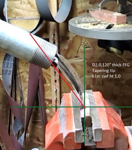

I like to experiment with D2 because of its known poor toughness - hence, easy to discern/delineate improvement (if any). Here is my D2 chopper, I posted a year ago

OP - please share more info on ht & perhaps test/video/etc. Better with more data... than wild guessing and dream up possibility from us.
Here is my D2 61rc blade (my reference as cwf ht 1.0) - destruction bending test. Estimated deflection angle about 70-75 degrees (whereas 90 degrees if the red line is at 45 degrees to the green coordinate) prior to yield (no plasticity, right onto fractures/snapped into 2). Confirmed by 2 broken pieces are dead straight - no hint of plasticity - as I was eluded to my previous post.

Your test is wrong. First, the angle is defined as the extension of two fixed points. Then,
1, the distance between the two fixed points.
2, the thickness of the material required
3, if the material and section into V type, then need to calculate coefficient.
4, the hardness of the material.
Distance / thickness = aspect ratio
My length to diameter ratio is about 35-40, thickness is 4.7MM, the length is generally within the appropriate range. If the ratio of length to diameter becomes larger, the angle will increase.
