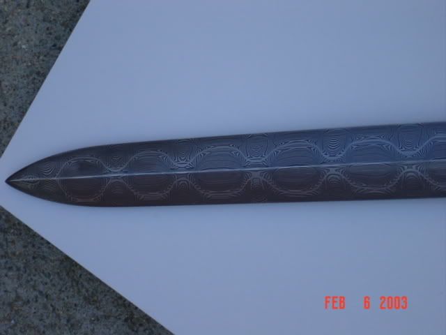

Here's a very interesting mosaic pattern from JW Randall from Reno several years ago. JW appropriately called it the "Mustang Bowie".

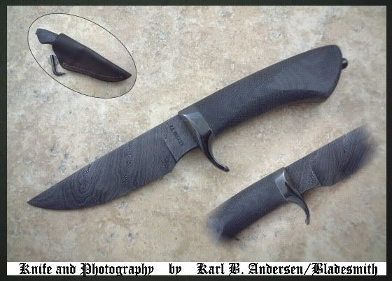

I made my first visit To Jerry Rados' shop almost 10 years ago now. I was having some trouble that he was kind enough to dig me out of.
When I was there that day, I saw something I will never forget:
He had just fiunished his Salt Pot heat treating on a large fighter that he said was headed to Afganistan.
It was 512 layer Random W2/203E.
It also had a rather long tang.
He greabbed that knife and said to follow him outside.
Holding the knife by the tang and with a big sweeping over-head arc, he BURIED about 3 inches of that knife down into a railroad tie. He then swung his fat, meaty, Jerry Rados foot and side-kicked that knife sideways so as to try to break it! I remember seeing his foot FLY backwards from the kick and almost knock him over! Then, he did it again! This time he kicked it HARDER and the blade DUG a huge divot out of that railroad tie!
He said that since that knife was headed for use by a Soldier, if it was going to fail, he wanted it to fail HERE!

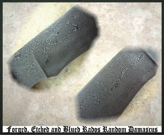

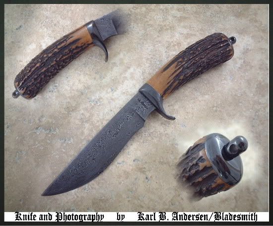

These two knives were forged by me from Jerry's steel.
Since that day, I have never used any one else's Damascus except Jerry's.
Yes, pattern welded steel can be VERY TOUGH!!
In addition to the etching oxides addeing rust protection, I also hot-blue the Damascus knives I make. Extra protection on TOP of the oxides!

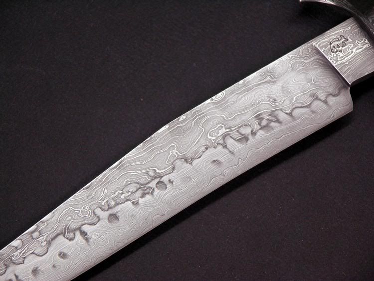

Overall, I think my favorite wootz. Here is a billet made by Achim Wirtz
He also makes some beautiful pattern welded steel.

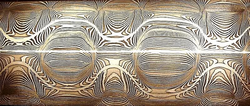

I am not sure I will add any mosaic to my collection, then I see something like this:
Okay...maybe I will?
