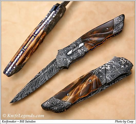

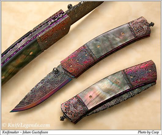

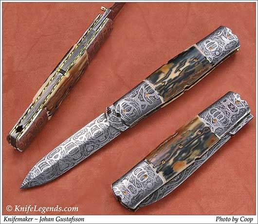

Great thread and some very impressive knives. I find mosaic damascus fascinating and amongst the most incredible pattern welding i've seen is that of Pierre Reverdy shown in David Daroms book on Fixed Blade knives.
I agree. I'm crazy about mosaic dasmascus, however believe you may give up a little strength as a compromise for beauty.
I was hoping one of our damascus makers would expand on the subject of mosaic vs strength?
It depends on how the final weld was done. Some guys are lining up tiles that are barely reduced in size at all when they are forge welded to prevent distortion. That is not a using knife, it's an art knife. If you want a mosaic damascus using knife, talk to the damascus maker so that he knows what type of mosaic to make for you. It seems to me that most mosaic damascus is reduced enough in forge welding to give you a complete weld, but it never hurts to talk to the maker if you actually want a using knife. Do people order mosaic damascus knives to be users?
