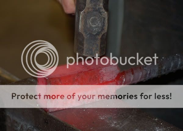

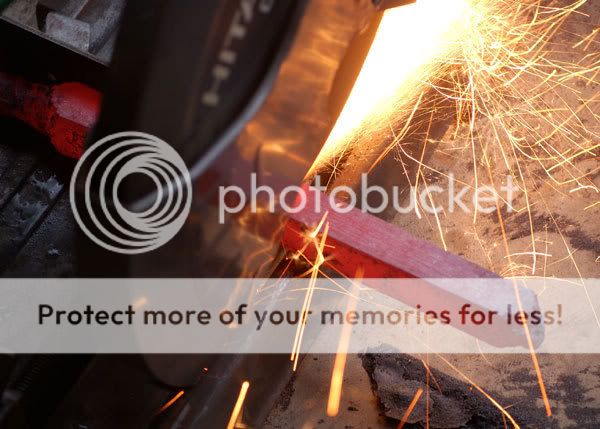

I mark the billet at the halfway point and cut it about 90% of the way through with the chop saw. You can hot cut it with the press or the hammer, but it kinda distorts the billet and keeps the mating surfaces from being flat. It really makes no difference, but I like doing it this way now.
I clamp the billet in the vise and grind the scale off the surfaces to be welded with an angle grinder.

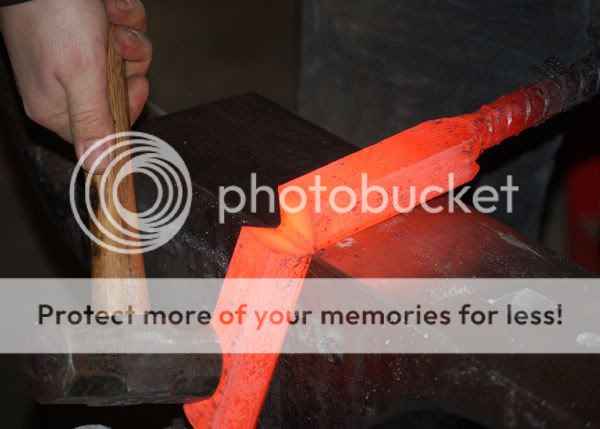

I heat the billet up again and fold it in half over the edge of the anvil.
...and then back on itself.

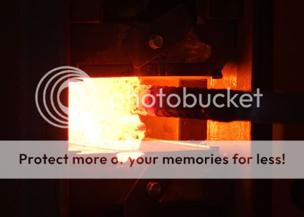

...then back in the forge. We started with 30 layers and now we're folding those 30 layers back onto themselves on edge. So we don't have 60 layers, we have 30 layers twice - side by side. We're gonna repeat that until we have 16 "sets" of 30 layers side by side. I call that a 30/16 "W" pattern.

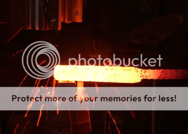

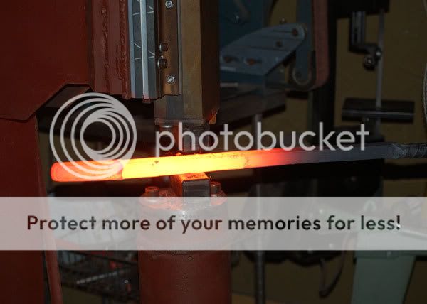

...and back into the press
...and back under the power hammer...

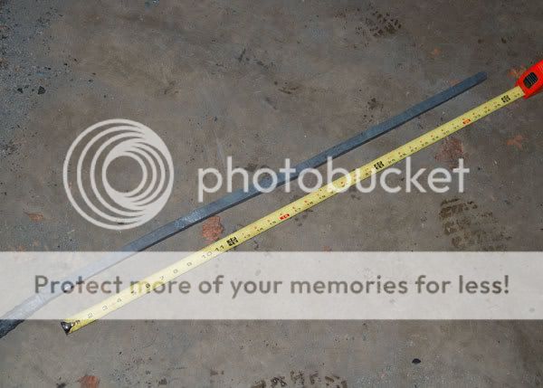

After all the folding is done, I'm going to draw it out into a long, square bar.

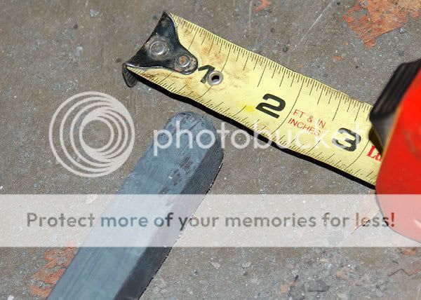

And here's the finished bar. Almost exactly 3 feet long,
...and a little over 5/8" square
Cutting off the end, and a quick etch, this is the basic pattern we have so far.
