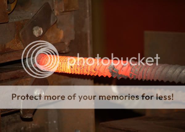

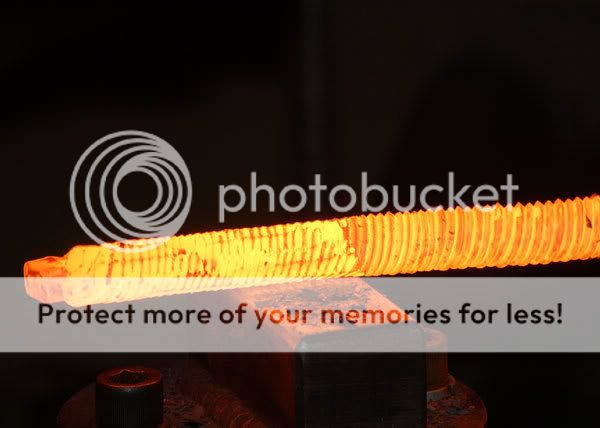

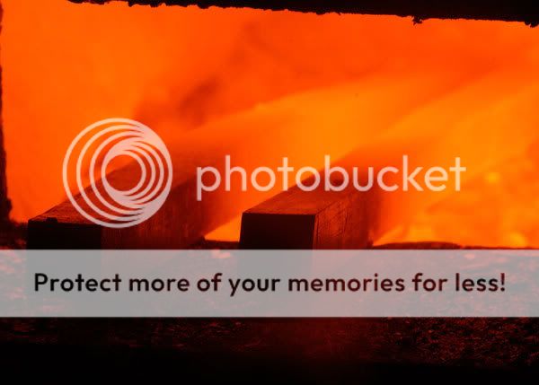

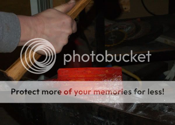

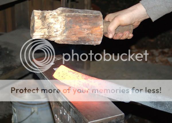

I cut the bar in half - two pieces about 18" long and reheat till toasty...

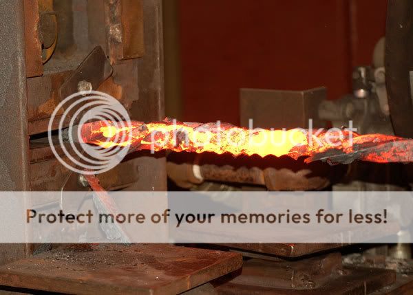

When hot, I clamp the tip in the press (it's faster than using a vise and I don't have to work so hard) and I grab the other end and twist with my bare hands. I might, I mean you can't see it can you?!?!?
...and twist...
...and twist...
...and twist. Sounds like a 50's song.

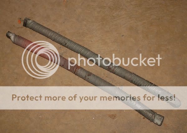

I twisted one bar clockwise and the other one counterclockwise.
More tomorrow...
now that's a coiler!
Nice tight twist Burt. Really looking forward to the rest of the project, and revealing the pattern.
Thanks much, Craig

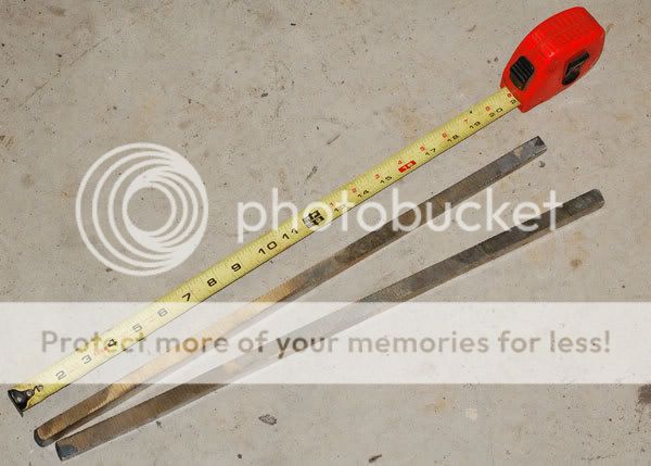

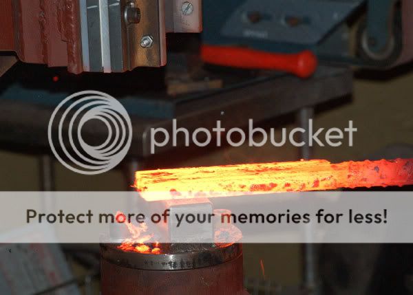

Then I flatten out the corners on the twisted bar.
Then I square off the bar. I'm going for a rectangle maybe 1/2" x 3/4" or so.
Then I grind off the scale to check the integrity of the bar.
The two bars after grinding are about 21" long and rectangular.

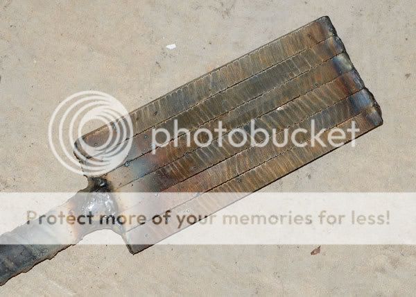

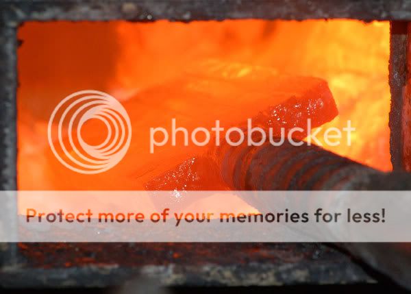

The bars are each cut into three pieces and arranged alternating left, right, left, right. Then welded onto a bar.

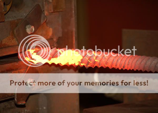

Re-heat the new six-bar stack.
Before it's at welding heat, I re-flux and just "tighten" up the stack.

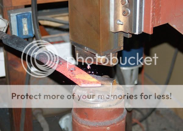

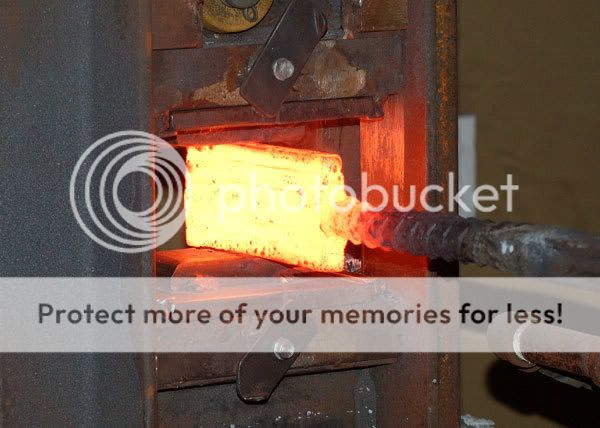

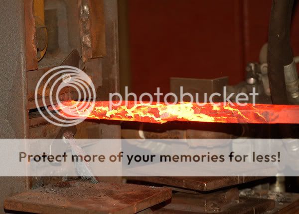

Like before, the first weld is in the press.

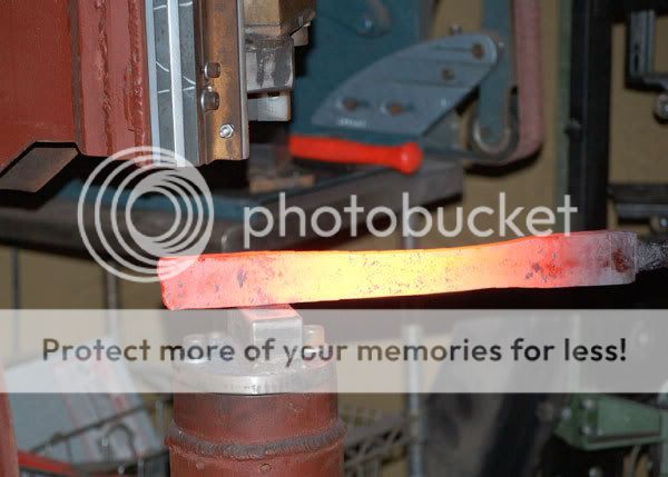

Then under the hammer.
Then I flatten it out.
I forge it down to nearly the thickness of what the blade will be.

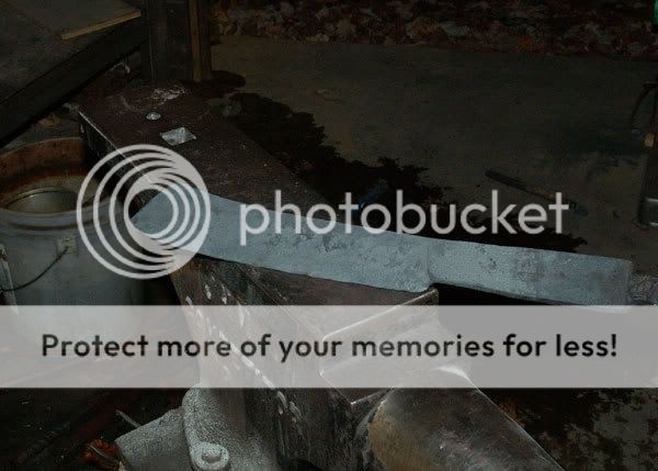

Once it's close to the final blade thickness, I can start forging the "preform" shape. You'll see that the blade will be wider out front than it is at the ricasso, so my preform reflects that.
Using the drawing dies, I start to pull down the blade bevels. The hammer does the grunt work, and I clean and straighten everything up on the anvil later.
...about finished with the hammer.

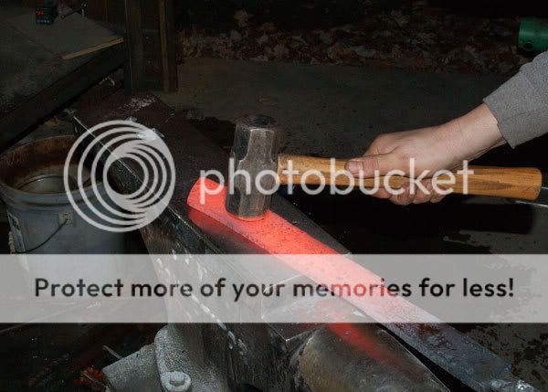

Correcting the curve with a very high tech tool.
Cleaning it up by hand.

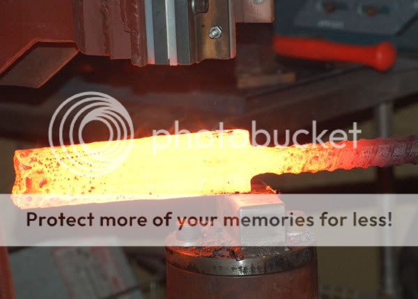

And nearly done with the blade.
And this is what the blade looks like after forging. Now for the tang...
That broad blade profile is going to make a nice canvas for the damascus pattern.
