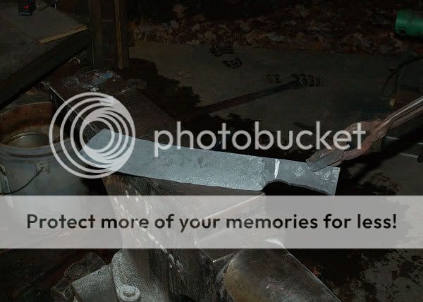

I cut the knife off the bar and guesstimate how much steel I'll need to draw out the tang.
Tang end is reheated and drawn out.

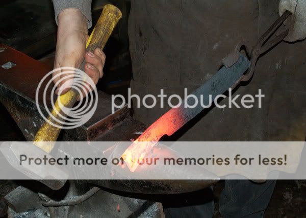

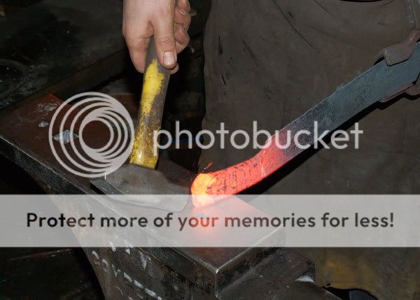

I curve the butt over the horn of the anvil and start to round off the back. An no one start giving me crap about my plastic handled hammer. I like my plastic hammer....
The I bring the forward end of the handle back toward the blade.
And adjusting again with that specialty tool. These are for sale by the way...

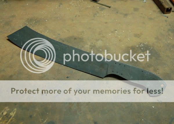

And after a little more work, here's the forged blade. This is as forged. No grinding has been done at this point. I actually came back the next day and cleaned this up a little more on the anvil before I started rough grinding.

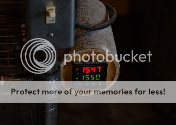

Here are a few normalizing shots...
I put the blade in the preheated oven.
Here's the controller, set to 1550F. I'll normalize twice at 1550 and once at 1500. Then it's annealed (sort of) at 1400F and allowed to cool in the oven.

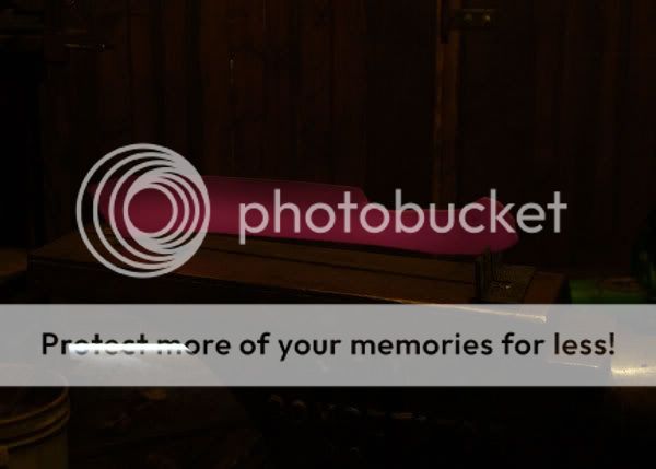

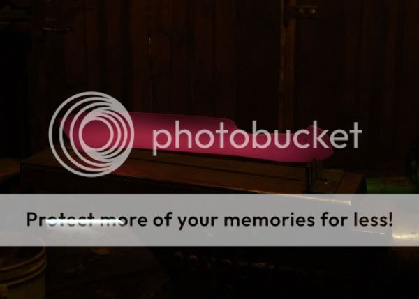

When normalizing, the blade is brought to temp, and removed to air cool. Here's a couple shots of the blade cooling.
Probably 10-15 seconds after removing from oven.
And maybe 20-30 seconds. You can't see recalesence in this blade because it has O-1 and O-1 will not show recalesence (the "re-brightening" of the steel upon cooling)

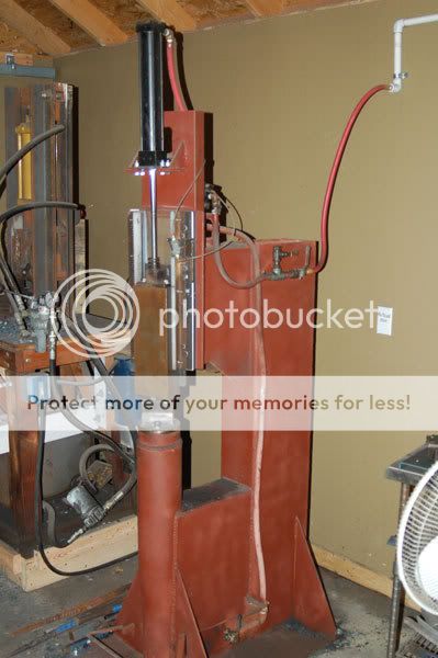

John,

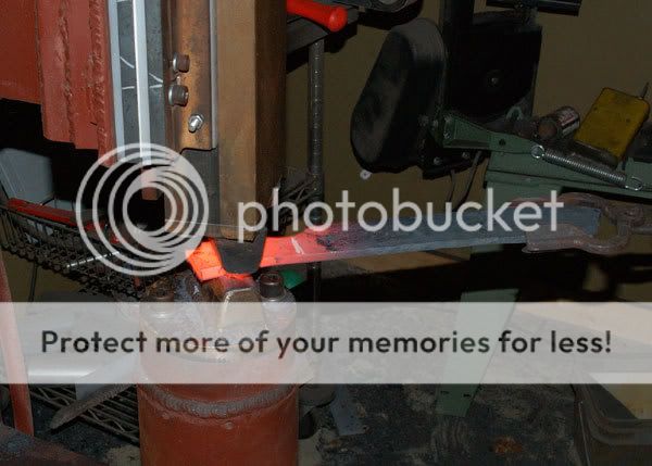

Here's a shot of the hammer:
I got it in a trade with a friend. It's a homemade hammer that's probably 15 years old. It came to me in working condition with a 35 lb head. It worked for over ten years for the previous owner and I broke it in a week. So I rebuilt the guides, dies, die mounts, and air cylinder kinda loosely based on the Kinyon style guide designs. I didn't buy the plans, just looked at photos and talked to a couple guys.
It has a 70 lb head and really works great. It eats a lot of air, but as long as a compressor can keep up, it works perfect.

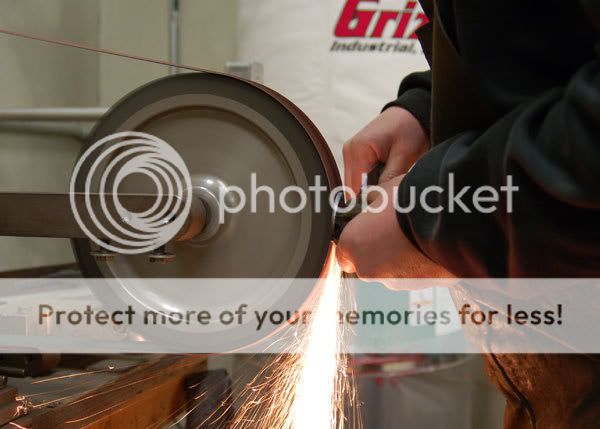

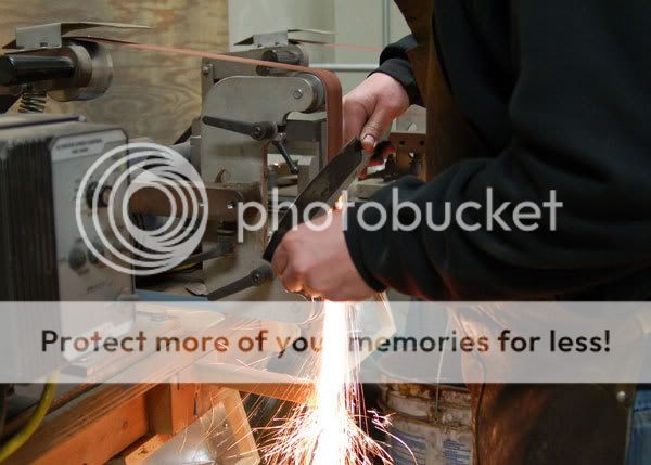

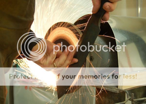

A little grinding on the forged blade. Got my big mug in the way. Should fire the photographer....
Profiling the edge.

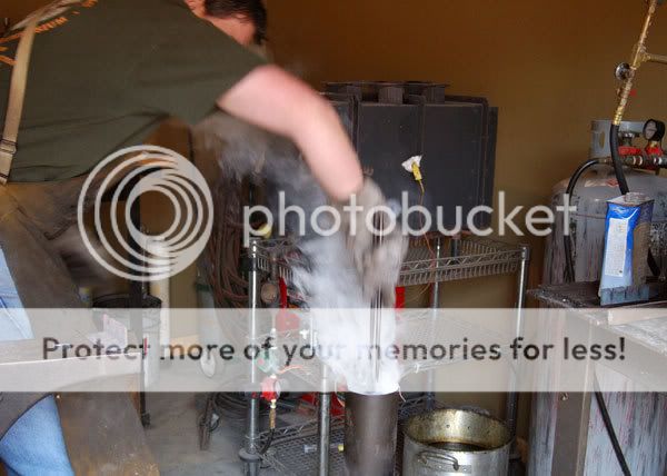

Quenching the blade. You always want to keep the propane tank as close as possible to the fire source. This way, death, if it's going to come will be fast and painless. Hopefully.

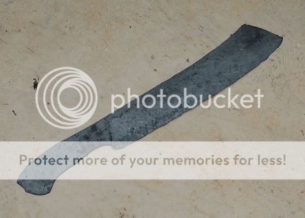

And this is the blade, rough ground, heat treated and tempered. Ready to start finishing. You can just barely see the pattern in the steel.

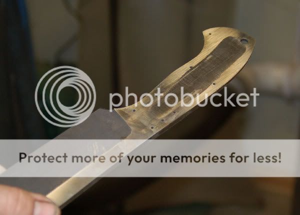

Initial flattening of the tang.
Using the contact wheel to grind a hollow in the center of the tang.
This makes it easier to get the tang totally flat and it helps the handle material sit flat on the steel rather than being held up just a little bit by the epoxy.

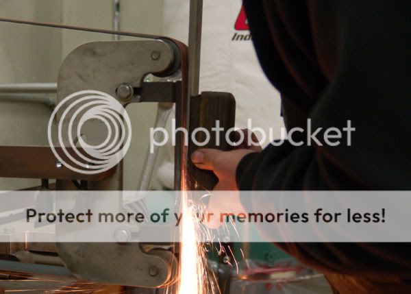

I'm using the disc grinder to flatten the tang, and the ricasso / spine area.
The tang and spine have been flattened and sanded on the disc grinder to 600 grit.

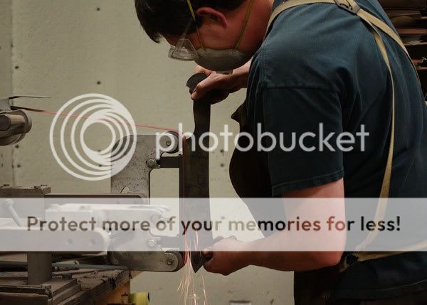

Finish grinding the blade bevels.
The bevels are finished on the disc grinder down to 600 grit before hand finishing.

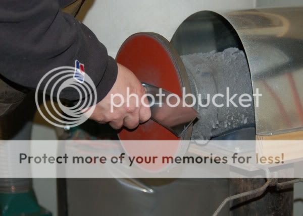

Between the first set of photos and the second set, I added a dust collector to the grinders and the buffer. It does make a nice difference. Maybe I'll live long enough to be killed by that propane tank after all.
