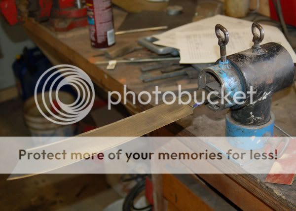

Here's the blade clamped in my handy dandy little knife vise.
I'm not a knife maker. And I've seen the same way (i.e. as shown in the above picture) done by other knife makers as well. Is't it looks highly dangerous :confused: I never want to hear any knife maker accidentally stumble and fall down just in front of that sticking out knife .. please :grumpy: I think there are few security measures not being strictly observed by some of knife makers .. e.g. not wearing a grinding mask .. not wearing gloves .. clamping the knife in such a way that the knife is sticking out dangerously :cool: Any explanation on it .. Burt?

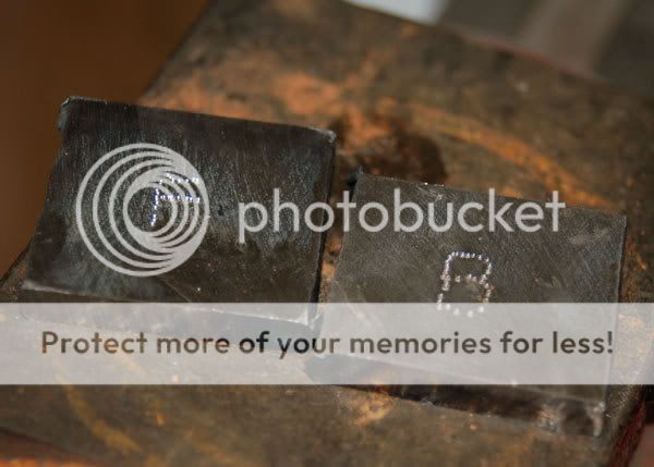

I mark then so they can't get mixed up
Front and Back. Front for me is the side where my logo is etched on the blade.

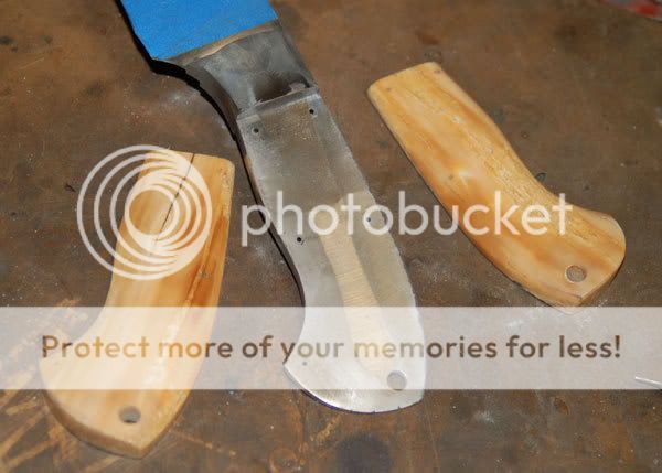

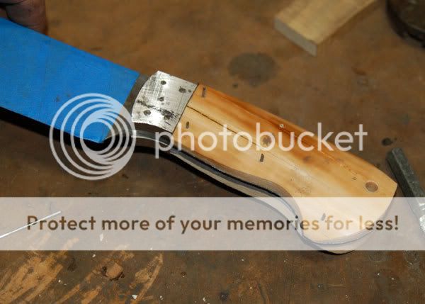

I pin the scales on the knife with steel pins. These pins, like the ones in the bolsters are just temporary, but they keep everything from moving around while I'm shaping the handle.
I guess this temporary pinning of the bolsters and the scales is one of the step which is seldomly done by other knife makers .. am I correct Burt :confused:
Theres a LONG list of things that can easily damage fragile humans in a knifemaker's shop
you just have to learn to be careful
and you never LEAVE the knife in the vice like that, just while your using it
Mohd,
Stephan is right. There's just a lot of things we do that aren't that smart. People are rather soft compared to sharp knives, and I know I could could get cut bad if not worse by tripping and landing on it. I never leave it in there and walk away. You can make a support from something thick like wood so that if you tripped it could only go in so far.
But I probably won't. ;)
This is why we make knives and don't work for NASA. We're not that bright.

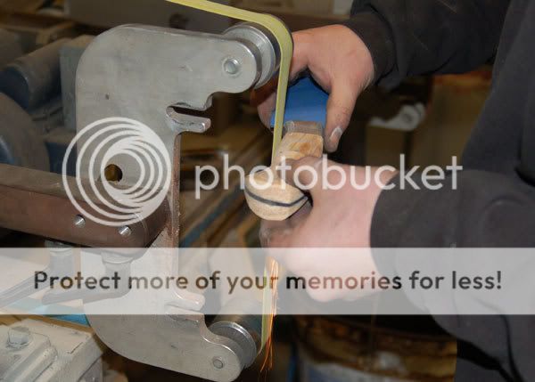

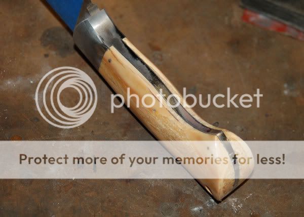

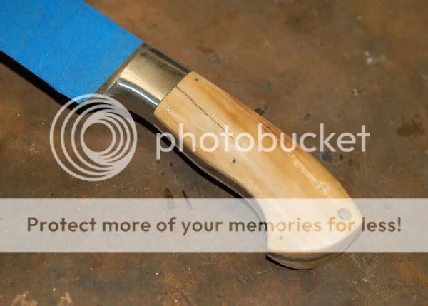

Shaping the handle with a flexible belt without the platen.
Handle as shaped before hand sanding.

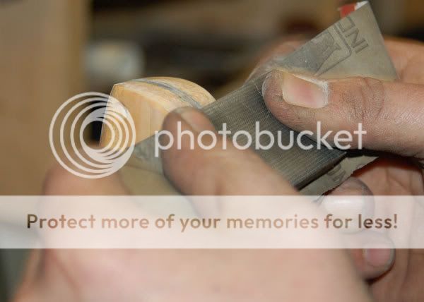

The whole handle, bolsters, ivory and exposed steel are sanded to 600 grit.
After sanding, the ivory is polished.
The temporary pins are carefully removed from the ivory, and the scales removed.
The bolsters are quickly etched to see where the pins are. The pins are then driven out with a special punch. You can see that the pins have just started being driven out toward the rear.

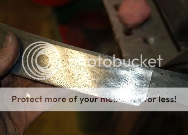

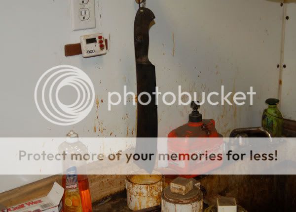

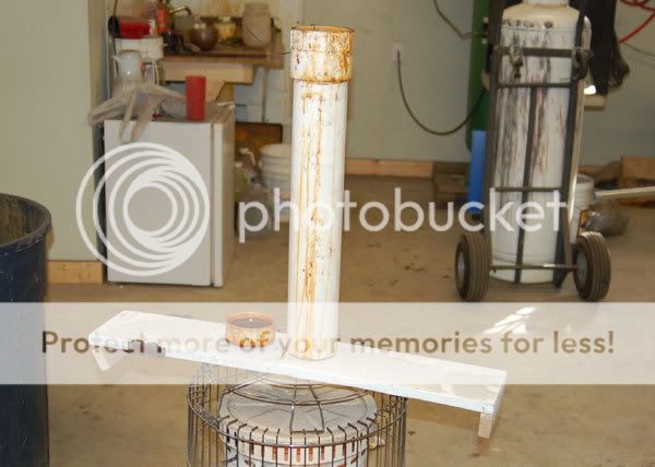

A little bowl of ferric chloride with the bolsters in it.
My shop was very cold this morning and the ferric was 38 deg F. So I took the tube with the knife in it and the little bowl and set them on my heater until they warmed up to 70 deg or so.

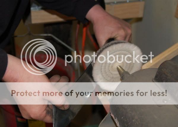

After probably 4-5 etching cycles, I'm almost there. I rub the blade out and buff just to see what I've go. Fancy buffer, huh?
Here's what I have by now.

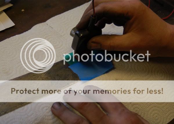

I etch my logo on the front and my MS with the year on the back.

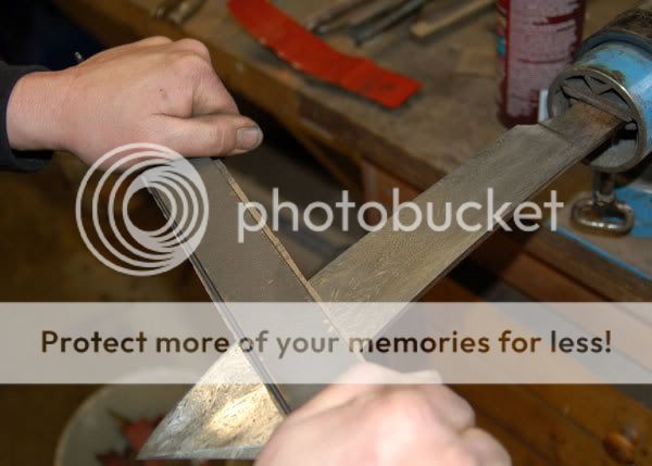

I set the blade in a tray with about 1/4" of water and slowly walk down the spine with a propane torch.
This is what it loks like when I'm done. This will leave the blade about 58 RC at the edge and closer to 50 RC at the spine.
Then I etch one more time...
And rub it out one last time with 1500 grit paper.

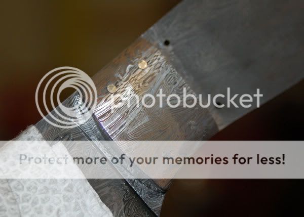

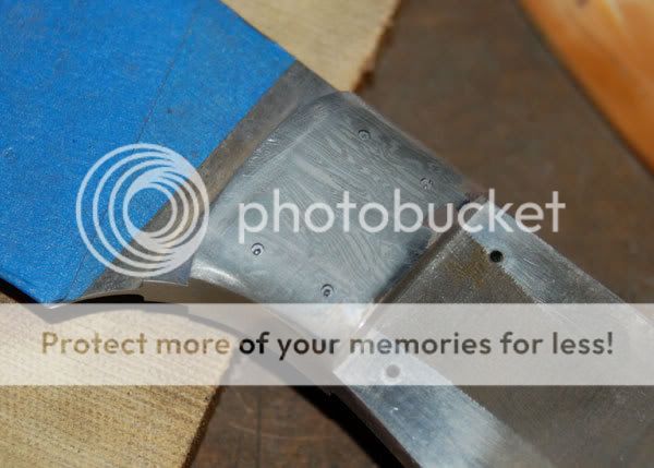

I put the bolsters, etched the same as the blade, back on the blade with small nickel silver pins. I leave the pins a tad long and dome them with a small hammer.
A close-up of the domed pins before any polishing.

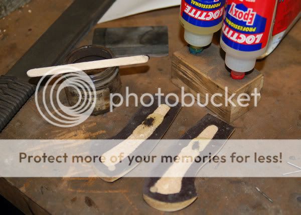

Handle scales with epoxy and some black epoxy dye powder to turn te epoxy black.
Scales are clamped to the blade and the lanyard tube inserted and epoxied. The little bent pins are just for alignment. They come out before the epoxy sets.

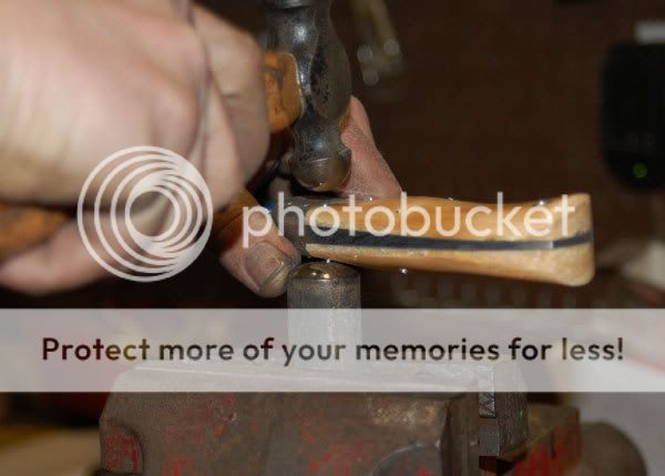

And finally, nickel silver pins are put in the handle and carefully peened in place to match the bolsters.
