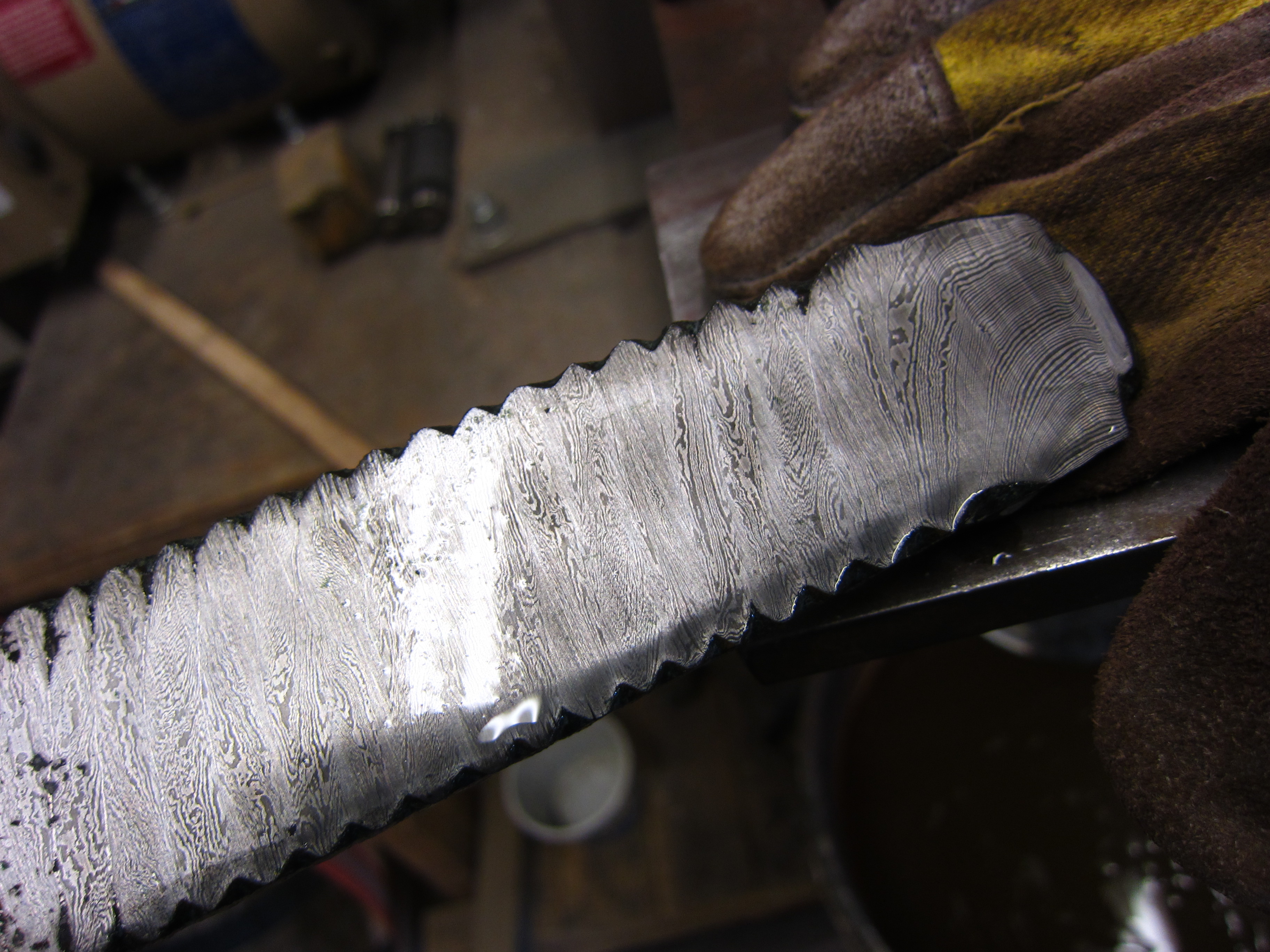

Rather than start a new thread, I'm just re-titling this one. Don't have to copy and paste all these picture url's that way. ;)
That's some serious twistin'!!!!
Going to turn this into a WIP?? ;):D
Well, I wasn't planning on it, but it looks like I've got a good start on a WIP. ;)
12345678910 said:
How did you get your twists to work out so straight ?
Not sure what you're asking here. If you mean keeping them even, just make sure the entire piece is good and hot.

Would you post a picture of the twisting rig you use? Or do you just use a vise and a big wrench? Is that even possible?

You can see the tool I use in a number of the pictures. It's an orange handled adjustable wrench with an additional handle welded to the business end. I clamp one end in the vise, and twist from the other end with the wrench. I do have a twisting jig which is used for specialized twisting. I'll try to take a picture of it today.

I've decided to go ahead and make this a full blown WIP thread, as reflected in the new title. I'm still not quite feeling up to par, so haven't done any heavy work, but here's a few more pics:
The billet after sitting around for a few days:
I'm soaking it in acid for a while to loosen the scale. Then I'll grind most of the cracks from the twisting off. That way I'll know that I won't be forging them into the blade, and risk ruining everything....
