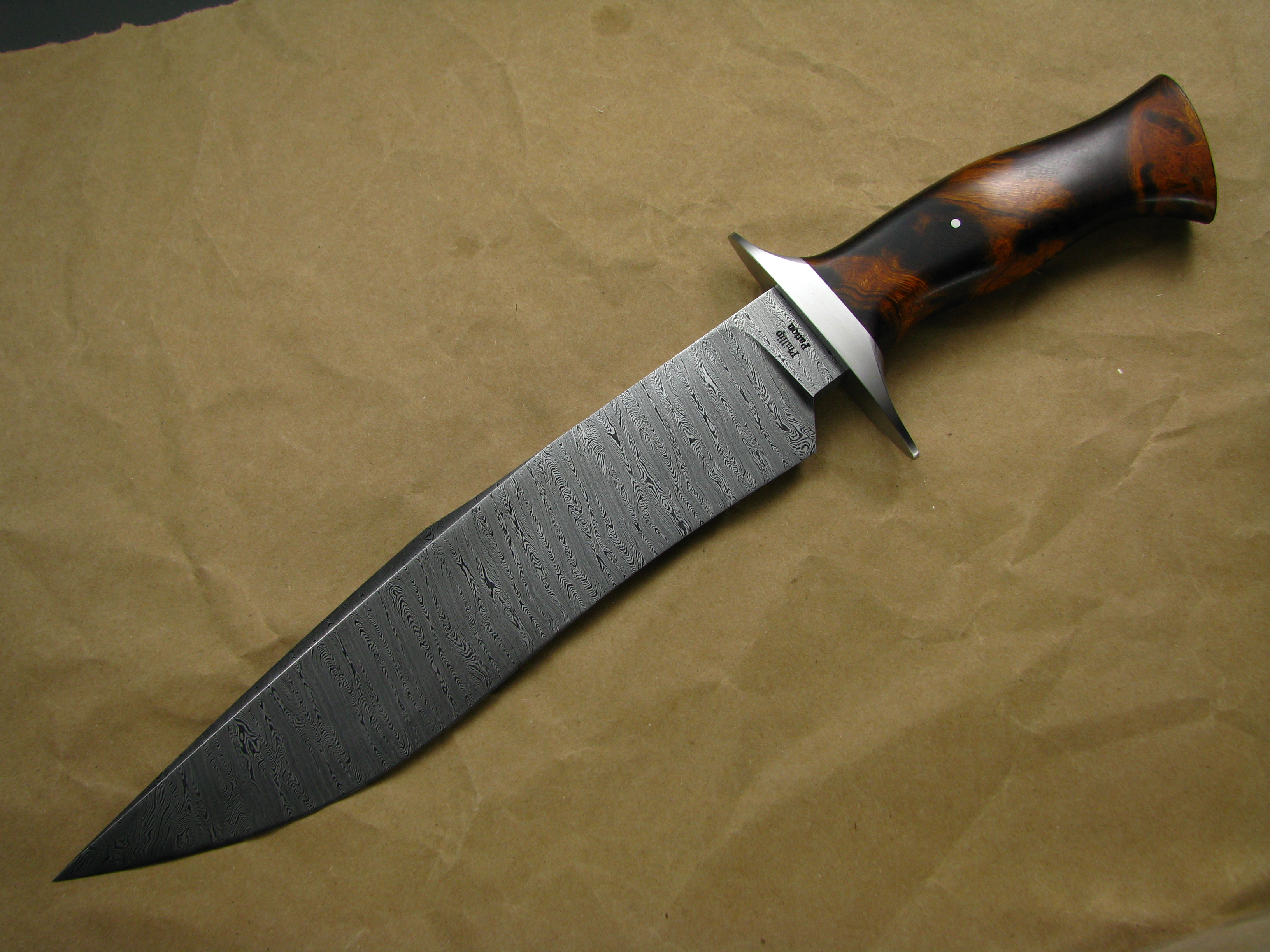

Now I grind the "face" of the guard clean, sand it to 240 grit, then finish it with a Scotchbrite belt:
Now I grind the corners of the tang round, and soften it with the torch so I can drill through it later:
After it cools, I clean the tang with acetone, and mix up some J-B Kwik:
After cleaning the excess off:
After all that, I decided I wasn't happy with the fit of the guard, (actually, there was a ding on one of the edges of the slot) so I pulled it off before the J-B Weld could set up. I'll clean everything up and fix it after lunch.
