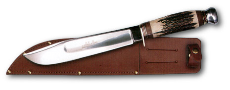

Regarding Damascus steels and Bear, I bought some folders and fixed knives about two years ago. Cheap Damascus usually has under 150 layers. Bear, I think, has 512, but their Damascus is stainless steel, not the carbon steel blades that are said to be the best. At any rate, checking eBay, I've noticed the prices of those same knives I got for a great price are substantially more now. I have no problems with Bear and Son's as a medium to low priced manufacturer of Damascus. I will say the blades are heavy and very nice in appearance, and they're great for showing people what layered steel looks like. (I polished the blades by hand with Semichrome and that brightened them up a bit.) Anyway, I have a fixed blade (see first pic below) and two folders, one a medium and one very tiny that they called a "mini-Executive." The latter is two and a half inches closed, three and seven eighths inches open. If that's not impressive, it's got genuine stag handles and is a lock-back in design. (Bottom photo.)
I came close to exchanging the Marble's Damascus Bowie ($80) for a Bear Damascus Bowie ($100). Do you happen know where Bear is importing their Damascus blades from? It didn't state they were imported on SMKW and usually they do if it is imported. Nevertheless, I think the word "Damascus" to describe a blade is almost as abused as the word "Bowie". Pattern welded is not Damascus. As for the Sheffield Bowie, I only got it because there is a scene in the movie Saving Private Ryan with one. I really don't know how good a knife it is but it can't be that bad.
