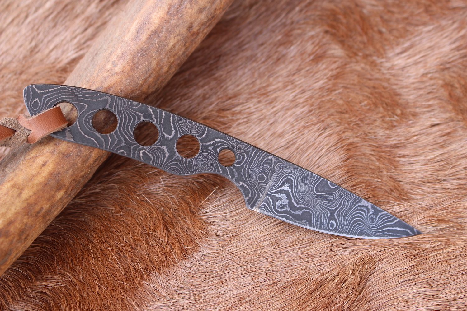

Yes, that's what I meant. Do they have some way of testing each layer individually?
For that matter, each steel has a different process for optimal HT. So when you take a few different steels and pattern weld them, then put those three different steels through the same HT, how can they each get optimal HT?
The layers don't need to be tested individually. The layers are thin. And a RC hardness tester uses a carbide tip and pressure to see how far that point makes an indent into the steel. This is usually done on a flat of the blade under the handle scale or on a folder near the pivot area so it is concealed. If you disassemble a folder and there is a little dot that looks precise but out of place it was probably RC tested. The sum of the layers as a whole will dictate the overall hardness. Not the individual layers themselves.

This is what I use. 1084/15n20 harden to at least 60Rc. img1477s.jpg
