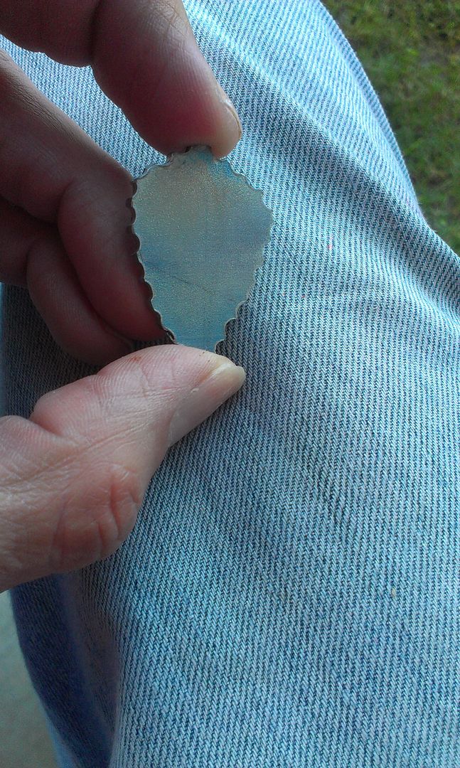

What is the best way, and what are the best type of drill bits, for drilling titanium? And, is there an easy way to cut it? I have a sheet that is .050" thick.
Man I wish I had experience. Gut says drill very slowly. iirc there's something to do with heat transfer and titanium? That's all I know D:
DF will know more about alloys, but I drilled 25 holes in a plate of CP ti yesterday using a hss bit and a little wd-40. I set my press to the slowest setting. Leaned into it a bit, and once I saw a coil, tried to keep even/firm pressure.
It was very easy in my .07 plate.
Making a shield pendant btw. ;)
