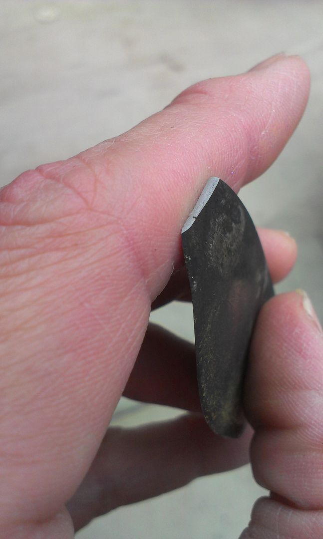

Thanks Xander. I've been testing the 1095 with water and haven't had a ping yet, the file skips after removing scale and the grain 'looks' good (not sure how it's supposed to look, but I don't see anything big in there).
I worked for many hours once, on a tanto, and had the blade crack. Just don't want that to happen again. :o
I'll use canola for the eutectoid steel, but how's canola with 1095?
Edit- here's a pic of a snapped tip after quench (it didn't bend, the bend was from a different test).
Can you tell anything from the grain?

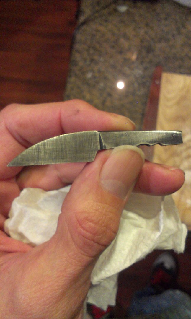

Here's a little carving knife blade after temper. Still have some cleaning up to do.
Took a great edge but I haven't handled it yet to see about edge retention.
Can't imagine that a short soak just above non-magnetic worked, but who knows?
Canola is too slow for hypereutectoid steels. 1095 can make an ok edc knife or bench knife when quenched in canola, but I would never sell one done that way. Brine quench or fast oil is best.
What steel is that blade made from? Try using kosher salt as a temp indicator when doing your HT, it melts at 1475*F, you want it about 1500*F. The curie temperature (Tc) for most all steel is right around 1414*F, much too low for HT purposes. That's why you go to non magnetic (Tc) and then one shade of red hotter.

Thanks again Xander. I'm aware of those figures for HT. I was able to get the carver a shade hotter, but without a thermocouple I'm dead in the water in terms of accuracy.
The carver is made from 1095 quenched in water. I'm positive that it hardened, but using the oven obviously isn't ideal for tempering. I did two 1 hour tempering cycles at 400° but who knows what's really going on in the steel.

400 might be kind of hard for 1095 tempering but only testing will show.
